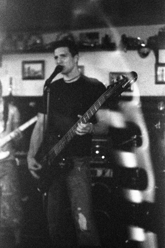

I tried some Delta 3200 with DDX developer and using the Ilford times along with the Massive Development Chart, pushing to 12500iso (1+4 for 17mins @ 20 degrees) and apart from producing terribly under-develpoed negs I had the weird lines as seen below in about a third of the negs.
An ideas what caused this?
The only thing I can think of is light somehow got into the changing bag.
This is light fogging and happened once when I accidentally turned the safelight on while loading a 35mm roll of TMY-2.
