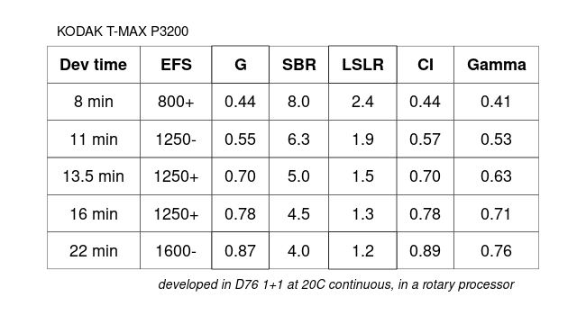

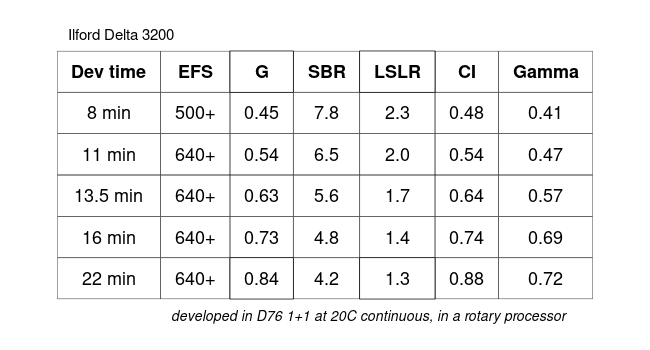

For those of you interested in numerical analysis, here are summaries for the P3200 and Delta 3200. Overall, the Kodak film is faster, but its curves are rather lumpy and the B+F density pretty high. I did this test twice, using film from two separate orders to make sure I wasn't dealing with a faulty batch. Delta 3200 produces well-formed curves, but with less shadow detail. In XTOL, both film produce a little more speed, and the P3200 behaves a little more linearly, if you care about that sort of thing.

@aparat Ilford is pretty clear about Delta 3200 not to be used with D76 1+1, they don't even offer that dilution as an option in the datasheet. They repeatedly state that DD-X or Microphen are required. I've tried Xtol with Delta 3200 and it was so much worse than DD-X or Microphen that my conclusion is that this film only works with some developers and not others.
I do not have any strong feelings towards Delta 3200, just can't shake off the feeling that your table above misrepresents the product. Labeling it ISO 640 must feel insulting to engineers who designed it. Simply upgrading the developer to full strength D76 brings the ISO up to 1000 (several folks have measured this, including Greg Davis whose results were just recently discussed here)
