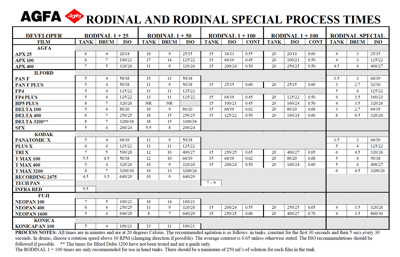

The 1:100 dilution is generally used for stand or semi-stand development. As you can see below, Agfa did not recommend that dilution for Delta 3200.
I have the same chart, Alex and in a box with an original bottle of Rodinal bought 2005/6 I have a set of instructions. This set like chart shown above make no mention of times for 1+100 but this time omits any reference to any 1+100 times for any films
Moreover the ínstructions give different times to the chart for D3200 at both 1+25 and 1+50 so what should I or anyone make of that? Did Agfa revise its times for some films like HP5+ and is the chart from an earlier or later date to the chart I can see nothing on either the chart or the set of instructions that came with the bottle of Rodínal that indicates dates
