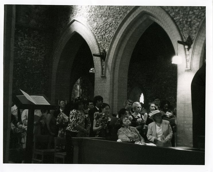

Example of my medium format delta3200 photos shot at 6400 at a wedding (in the world's darkest venue ever, I'm sure of it...)
This is an 8x10 enlargement, cropped from a 6x6 frame. Anything oddlooking might be due to the fact it was taken on an Ilford Sporti - very similar to a holga with a slightly nicer glass lens.

That's pretty nice
Yours looks much better than mine! I think this shows that a 1-stop push to 6400 is about the limit of the film as far as "usable" images, but who's to say what's usable eh? :smile: If I can capture my little girl waking up, early in the morning in a dimly lit bedroom, and there was no better way, I have a usable image. I'll "use" it 20 years from now when I miss my baby girl and she's off to college. :smile:

can you give your developer and times? thanks
eddie
Akki14
Feb 2, 2007
1,874
London, UK
Ilford Microphen 16min30sec(20C time)... that's the time for ISO 12500, though i think it was a bit warm so it wasn't quite that long, whatever 22C or so works out to be on the magical chart.
