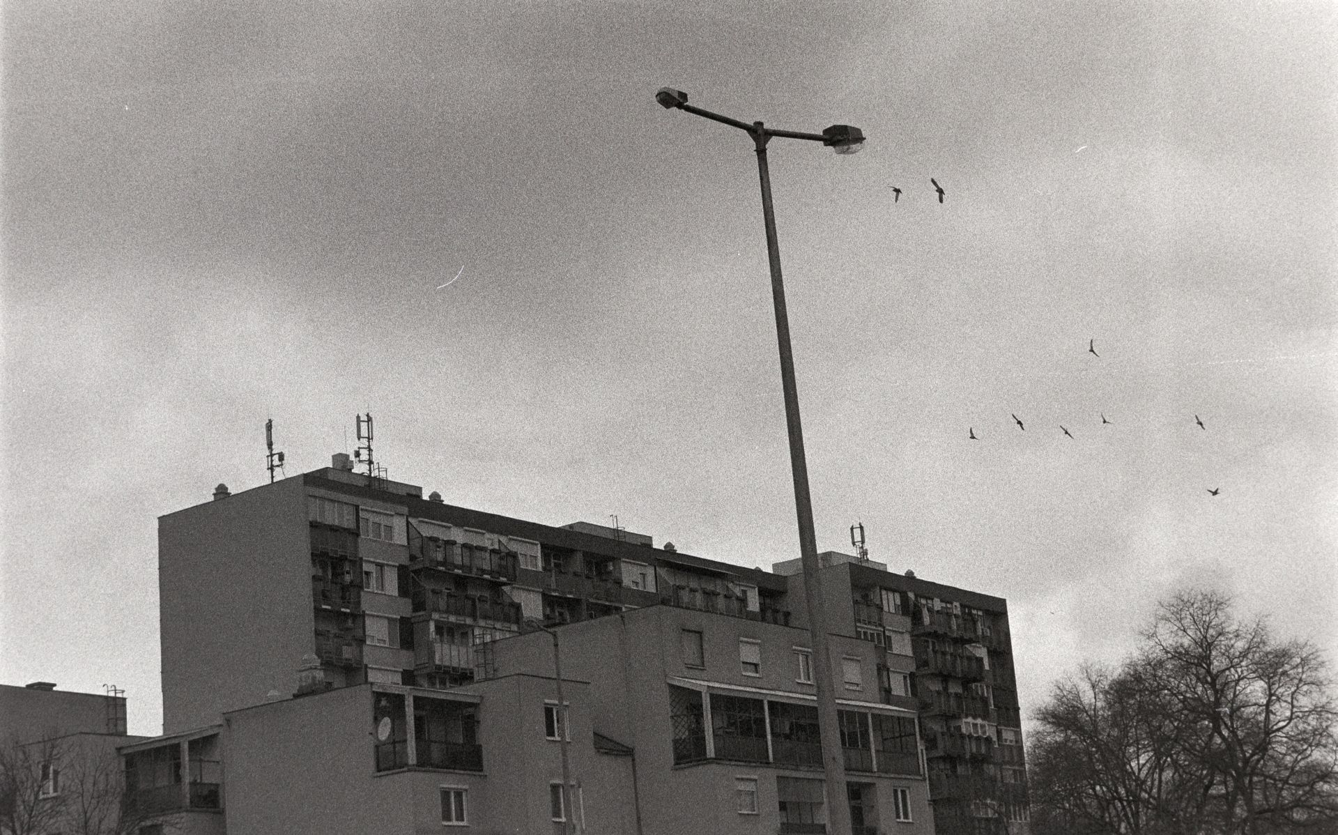

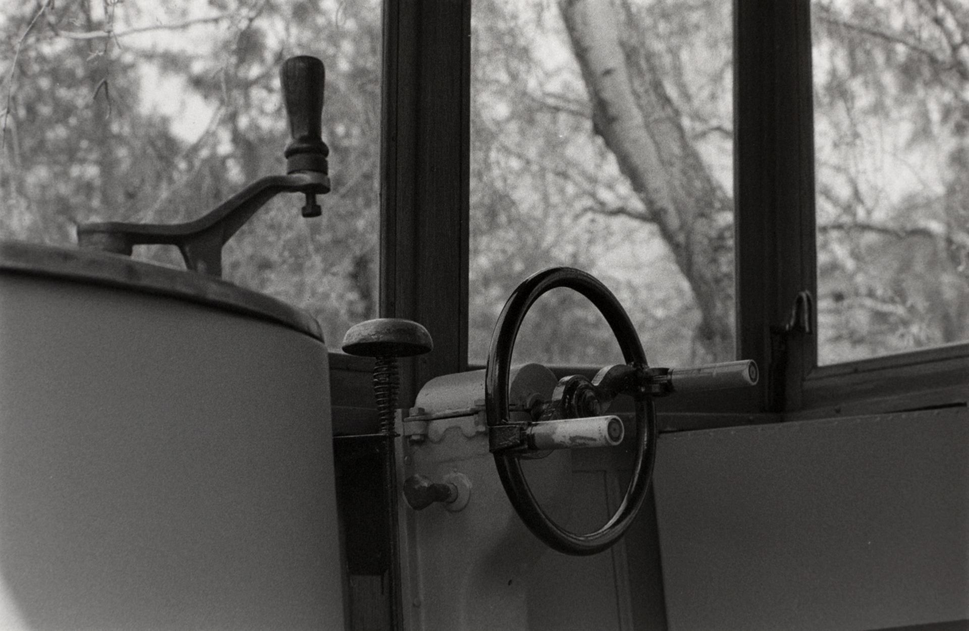

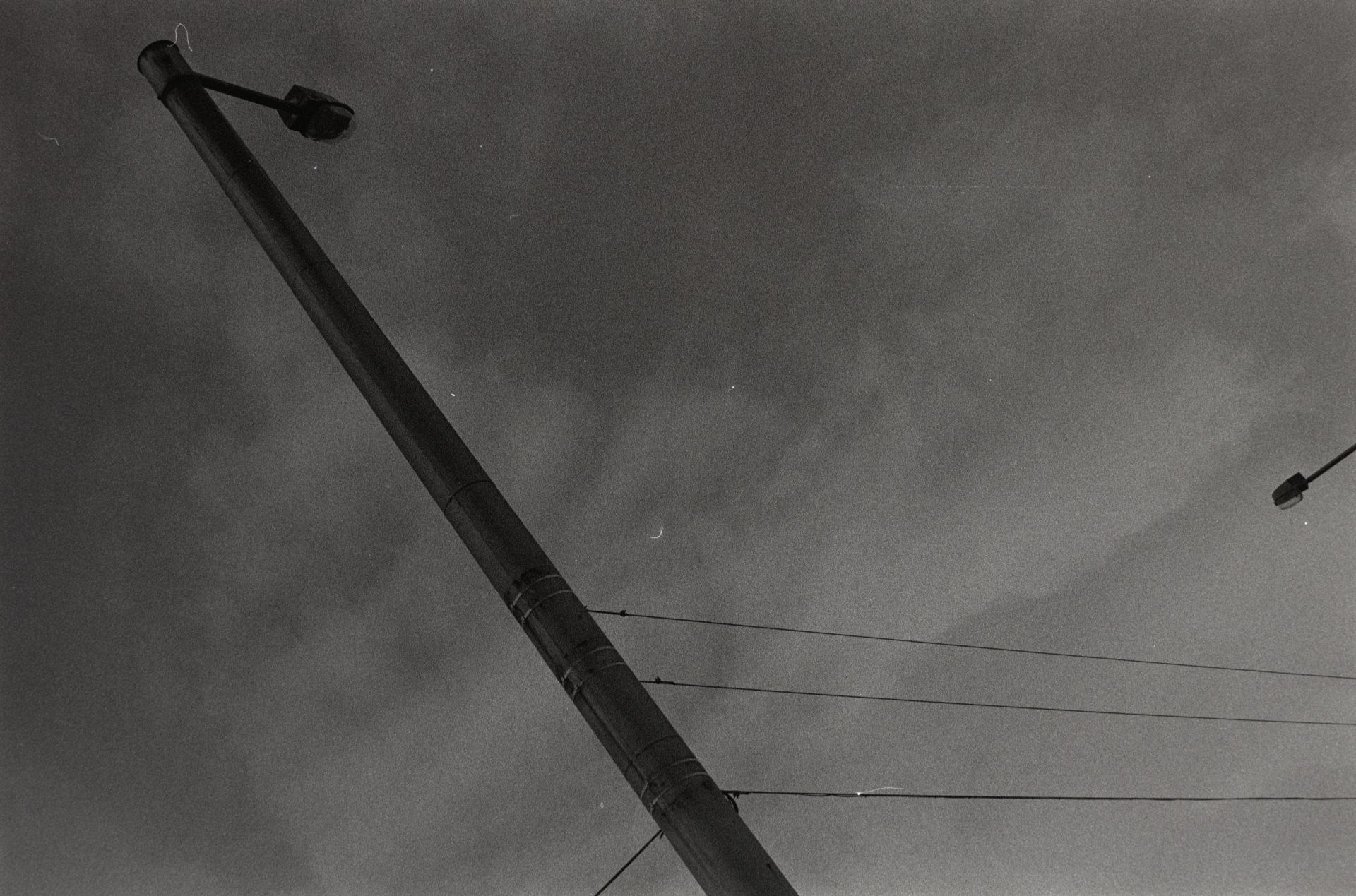

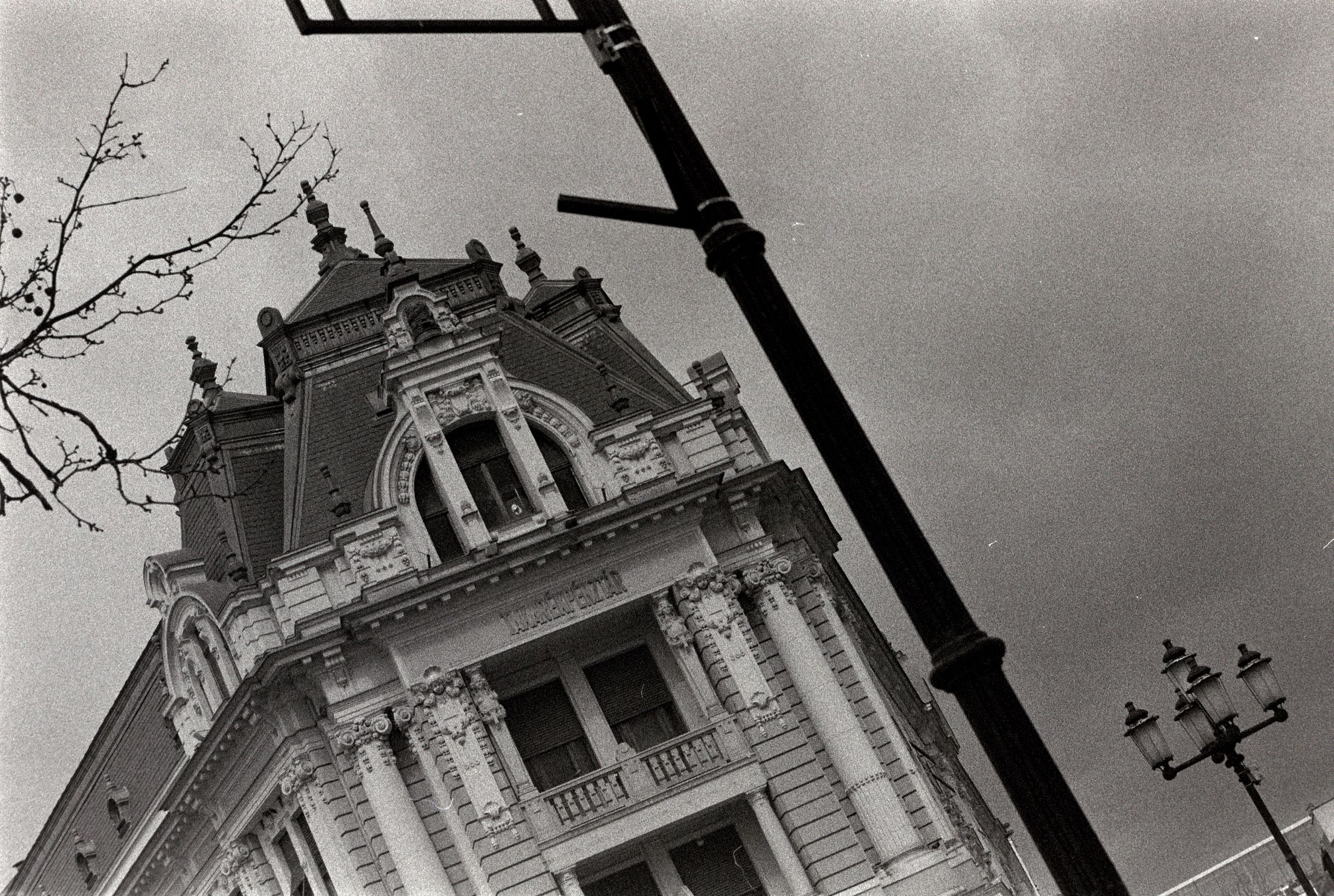

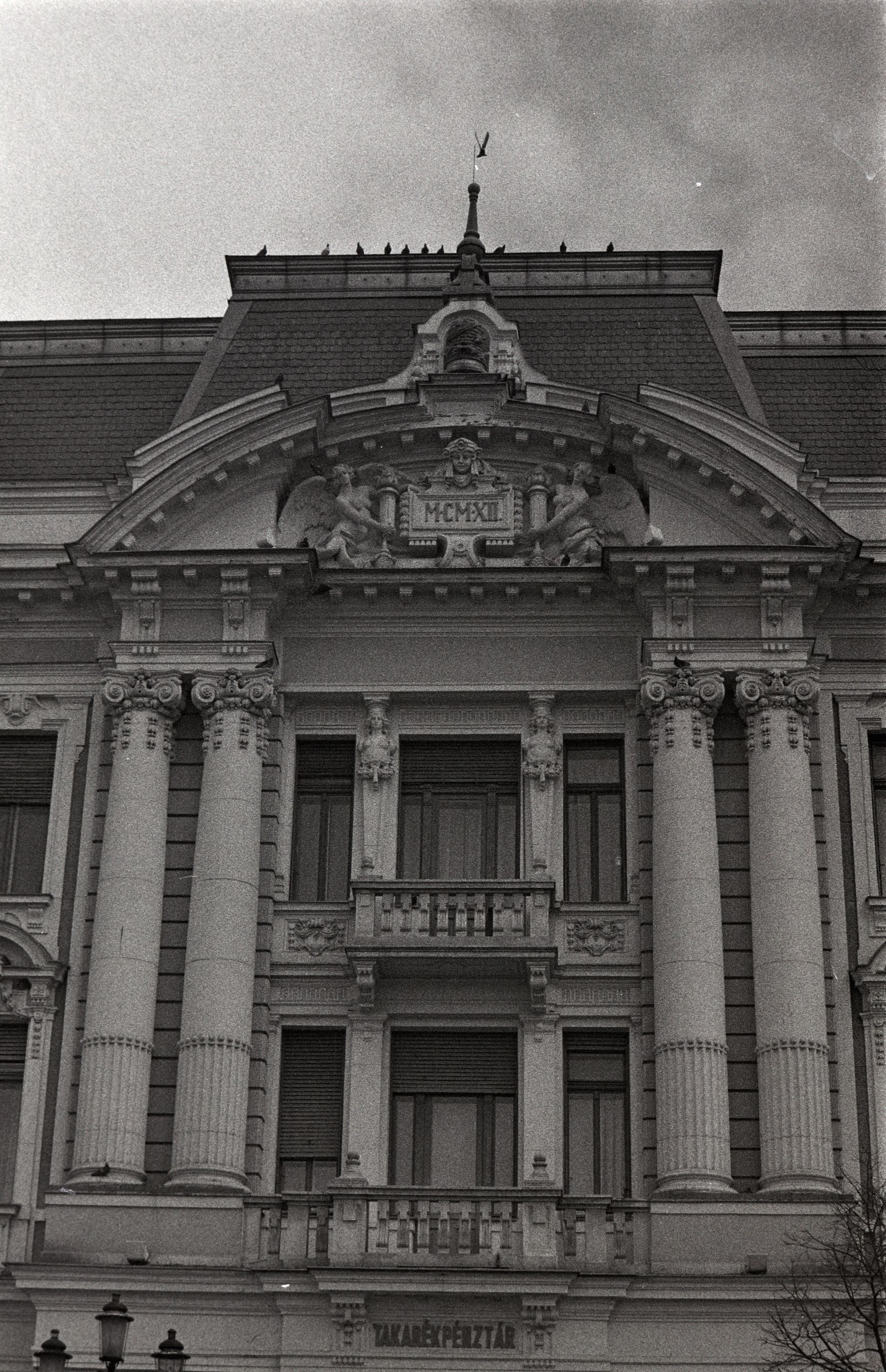

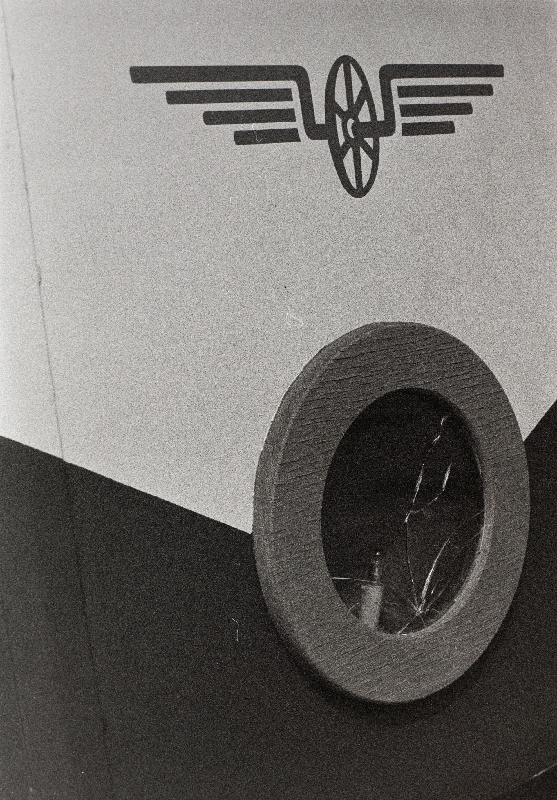

So I've done the test.
The contrast is super low as I thought but this kind of creamy/silky tone I really like and also the coarse grain.
I've shot it at 400 and developed it in Rodinal 1+25 for 5 and a half minute. I was thinking to give it a bit more time but then I changed my mind and sticked to the datasheet so I can build from there. I might shoot the next roll as 400 and develop it as 800 just to boost it. I'm also playing with the idea to shoot it as 800 and develop it as 800 or 1600.
I'll also re-edit the photos I just gave them a go to see the outcome and I'm not a photo edit wizard anyway.

Why not just use delta 400 or HP5? If you commit to 400 iso you may as well use a film suited to that. Lots of good 400 iso film around.
I've done both but none of them gave me this coarse and huge grain. Delta 400's grain is coarse also compared to HP5 which is rather soft. I liked both but I needed something noisy.

Laci Toth
Laci Toth
Aug 9, 2019
408
Budapest
It would be nice to see some of the op's shots that were made in strong daylight (because I like more contrast), but the results show promise. Would also love to see this film/developer combination using a half frame camera. So far, I'm happy shooting Tri-X at 200 and developing in Rodinal at 1:25. The grain is different from these shots and not so closely packed together.
I'm assuming these are scans? Things will look a lot different in a darkroom print. In the early days I scanned my negs and did the inkjet thing, and believe me, going to a darkroom made a big difference in the grain. Things were smoother.

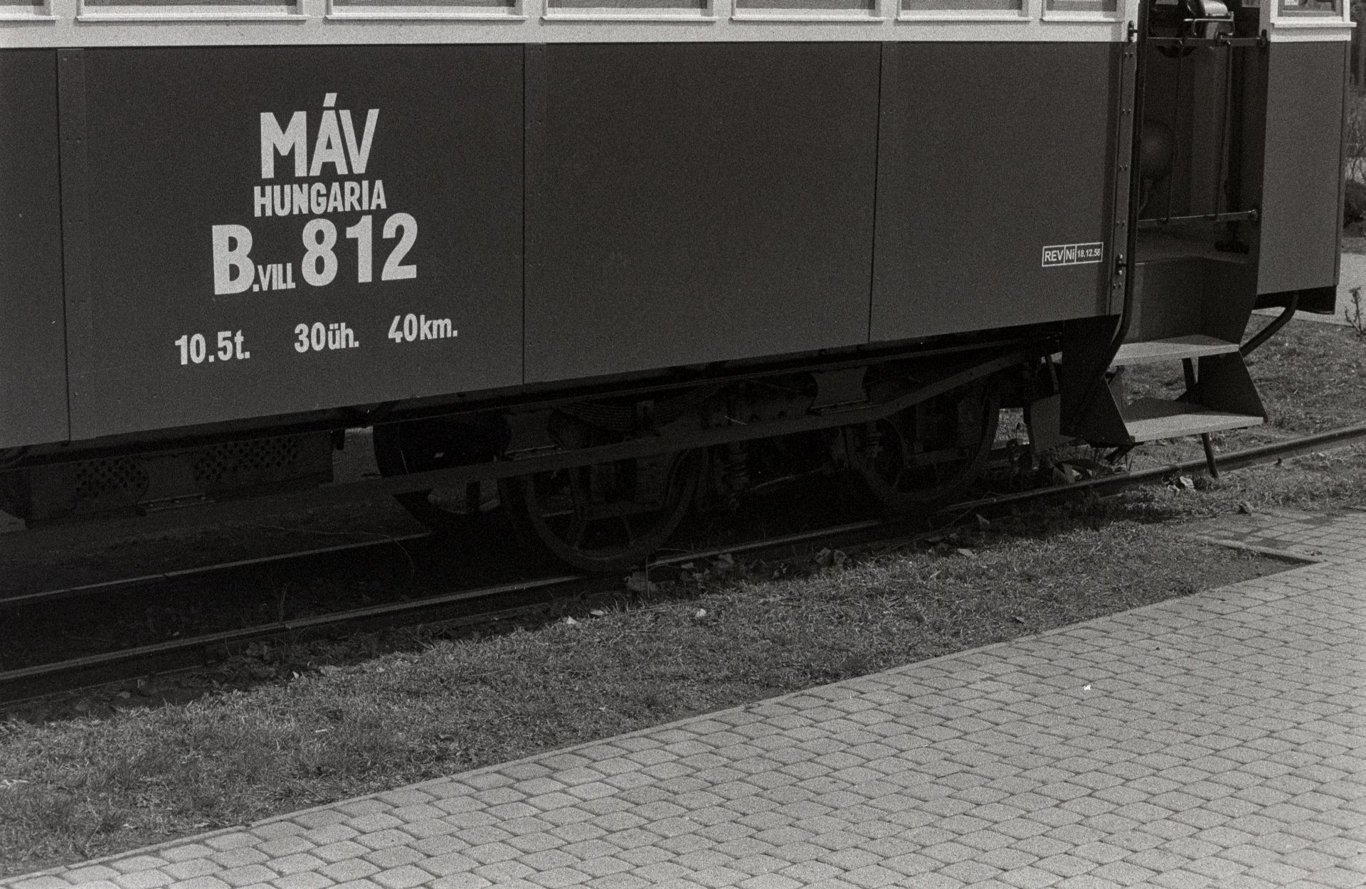

Yes, these are scans. Nikon D3200 with Nikkor 55mm, f3.5.
The tram was shot under the full sun.
I've played around with the editing and since then I made a few versions of the other photos as well and will decide later on which one I like best.
As I had to reduce the size to be able to upload them here some of the sharpness is lost. Also I've checked the outcomes on a Macbook then a Windows laptop and an iphone as well and the results were different. It seems to me that the mac and iphone version give them more character and contrast.
