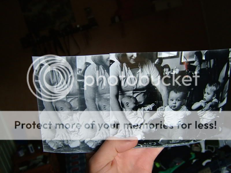

I have bought some Ilford Cooltone paper, and my first print in the ordinary developer came out well, but looked almost neutral so I thought I would try it in the Cooltone developer and all I have got is a selection of washed out looking prints and it takes ages for the paper to react to the developer, That was Thursday and I didn't have time to do any more printing and I packed away, today I tried again (with a test strip) and got the same result, then I tried mixing up some more Cooltone developer, being careful of temperature and mixing it well. I then attempted another test strip using the lens open a stop wider but still using 5 second intervals, still washed out, then I tried making a print, and it looked awful.
So then I tried the normal Ilford paper, I increased the exposure by 1 second from 12 to 13 seconds, Placed the ordinary paper in the CT developer and it came out fine, I got high contrast print going all the way from pure black to white and not the horrible looking print I got with the CT paper. But the CT paper looked fine in the ordinary developer, am I doing something wrong?

Yeah I just read that to and tried it at 4 minutes, barely looks any different to the one I just took out of the developer when I had just given up on getting a good result.

First one is the CT paper 12 seconds developed untill I gave up
Second one is the CT paper 13 seconds developed beyond me giving up a full 4 minutes
Third is ordinary Ilford MG Same time 13 seconds, same grade ad the first print. in the same developer, same bath.

Papers have different speeds, for example Ilford Warmtone paper is at least two stops slower than Multigrade. I'd suggest that you do a test strip that is very light at the start and almost black at the end simply by increasing the exposure until that happens. I suspect that you have not given the paper enough exposure.

On my second test strip, it did get quite dark at the most exposed and, but it still looked like crud, remember the CT paper worked fine with normal developer and CT developer worked fine with normal paper!
Use a higher grade to increase the contrast.
