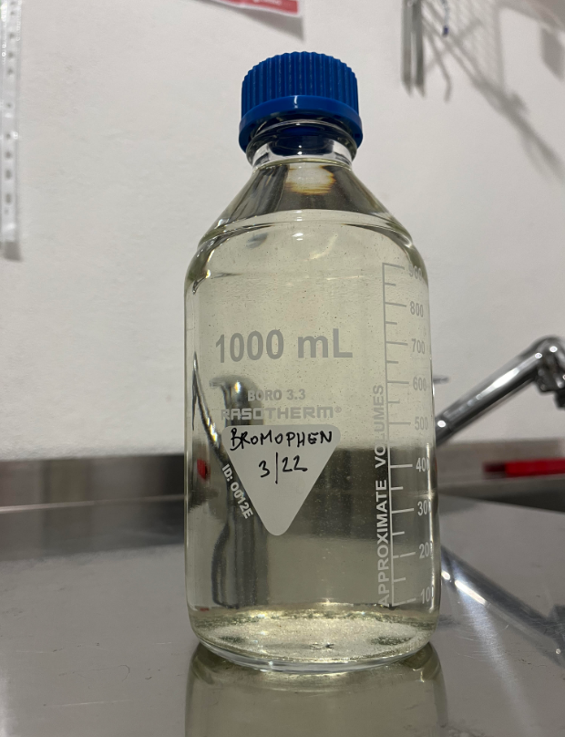

Your box of Micropen Bromophen makes 5 liters of stock solution, which is further diluted 1+3 with water just before use. It is a very robust developer with a long shelf life as a stock solution. I last mixed my box of Bromophen in March 2022 (!) and stored it in 5 one-liter glass bottles. It is still going strong -I was printing last Saturday and got excellent results.
Light straw color, a few flakes at the bottom, but still at "full power" no loss in quality or performance even after two and a half years.
