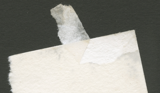

Perhaps more the other way around? The back of the paper feels like Photo Rag, but the surface with the photo coating makes it quite different. I can see upon further examination under high magnification that my original thought that this was in fact a resin/fiber hybrid seems to be the case. I've had some prints soaking for a couple of days in order to separate them from the coating and having done so can see that it is a very thin plastic or resin coating on the paper. It is kind of rubbery. I'm guessing this would account for its tendancy to float on the surface of the water as well as for the shorter wash times? Also for the the fact that it lays so flat and doesn't curl like other fiber based papers.
Thanks for the information, Simon. It is very much appreciated and anything you can pass along from the people in product development would be great. If the paper is in fact a resin or plastic hybrid, my concern is that it will degrade over time much as resin coated papers do and won't be truly archival as in the case with other fiber based papers.
Edit: Here is a magnified scan of what I am talking about. It definitely feels and stretches like plastic.
