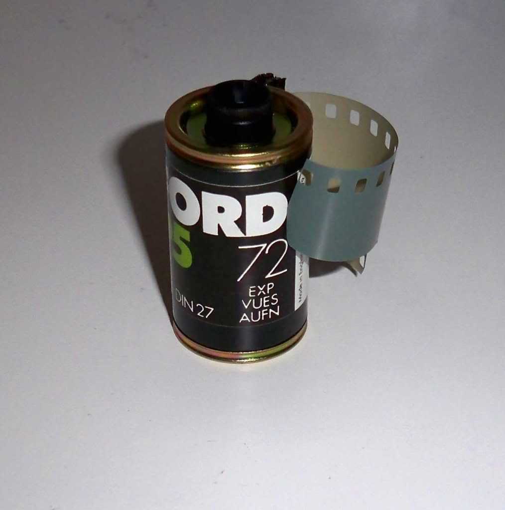

This is one for the Ilford historians. When was the the 72 exposure HP-5 discontinued? I'm trying to narrow a date range for a photo.

From memory was still available in 1980.

Discontinued, I think, due to damage to motor drive equipped cameras. The base was too strong and wouldn't tear, damaging the camera instead. Is that what happened?
I never shot it but a friend did. He complained about having to have a step ladder to hang the roll to dry.

It died a death before I joined ILFORD in 1987... so it was never in the PLUS emulsion, it did live on in a version of surveillance film.
But I'm pretty sure we still have some of the tanks...
It was not a success and yes it re-inforced our 'dislike' for polyester based camera films, and before anyone says how polyester is better for longevity... tri-acetate is fine for 100+ years, and again nothing wrong in coating on polyester for certain applications ( we do do it ). But we ( and KODAK and FUJI ) coat on tri-acetate for a reason, polyester would be much cheaper to coat on.
Simon ILFORD Photo / HARMAN technology Limited.

Martin Reed at Silverprint had a clearance sale of the 72ex stainless steel tanks and reels not so long ago (maybe 2-3 years).
I remember the film being released but because film counters on the majority of cameras only go to 36ex it was impractical. I never saw it on the shelf of my Ilford dealer.

Still have a few rolls in the freezer, that I got on a clear-out from Freestyle. I have misplaced the lid form my Ilford Stainless tank - probably when i moved in 1994, so I had to fake that out when I tried a roll last year. even with freezing since I got it, it is about half gone.
I also got teh Plastic reel for a regular stainless tank, but found it Very hard to load.
HP5 with Green print on a black label, in a black can with a green lid. No DX code and gold colour end caps on a "Agfa-Style" cassette.
Best plan for hanging to dry is to probably use a couple of "pace" film clips that hang from the perfs, and cut the wet roll into two haves on a frame line, unless your darkroom is blessed with a 10 foot ceiling.

I still have about five rolls left. I use it in a 3003 (with 72 exposure counter) and just cut the roll in the dark to split it into two standard Jobo reels.

Funny this should come up since I just put a roll in a little Voigtlander Vito B a few days ago. I bought this stuff years ago and I believe mine has an expiration date somewhere in 1984. Don't know the date for sure since the film is at home and I'm at my cottage. Mine has fog, but it's still printable. I use it for testing 35mm cameras now. I load, shoot several frames to test focus and shutter speeds and then go in the dark, pull the film out of the camera and cut the test section. Very thin base makes it hard to load on my reels.

I have cameras with pressure plates to take the thin film and counters that go to 72 also. I'm still looking for a thin film in bulk rolls.

Ilford never made the motor drive film in bulk rolls. Only modern film I have seen as thin is the one being sold by CEBMA/Astrum from Ukraine. they do indicate that it is available in bulk.
see this thread https://www.photrio.com/forum/threads/let-me-introduce-you-to-svema.196724/
looks like they want about US$1.85 a meter, and a normal bulk roll is 30.5 meters long. you would have to email them to to find the status and if they have any bulk rolls in stock.

I don't have any Svema to measure but internet sources indicate 0.10mm. I'll have to check it out.
HP5 current: 0.125 (my measurement)
Svema: 0.100 (internet)
HP5 72 exp: 0.080 (my measurement)
Simple math would indicate maybe 60 exposures of Svema could be rolled.
