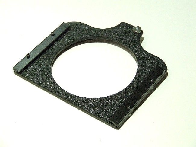

So I have been using Rosco filters in the filter drawer for two-filter MG printing but what a pain to reach up over my head and change the filters. Sometimes as many as 50 times in a printing session.
To use the Ilford 6x6 inch filters under the lens I will have to build a filter holder. There are NO pre-made filter holders that I know of that will take these 6x6 filters ($50.00 for the set).
And, again the 12" x 12" Ilford filter set that goes between the light source and the negative cost $240 US dollars and is special-order-non-returnable. Since I have been using a dichroic head since 1974 for MG printing, I didn't want to spend this much money for something I may not like.
ic-racer
ic-racer
Feb 25, 2007
16,509
USA
Here is the filter holder I was able to make. It fits on the end of the rod that holds the red safety filter.
