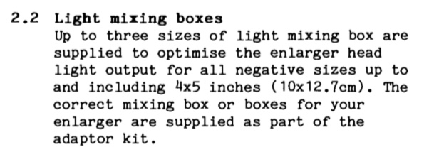

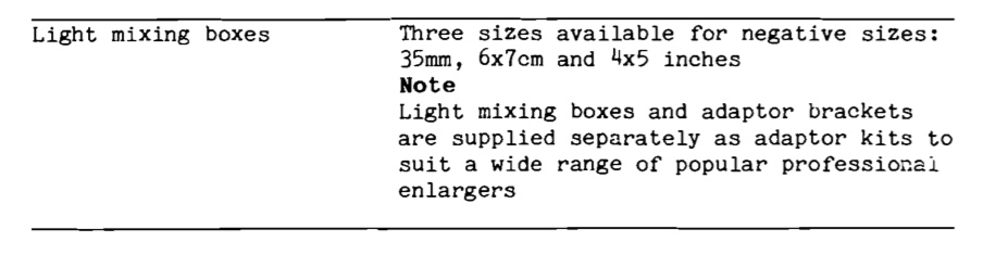

I think I stand corrected in assuming the boxes were the same! I couldn't find my manual but it is online.
https://www.ilfordphoto.com/wp/wp-content/uploads/2017/06/MG500-Operating-Manual.pdf
Two parts of it mention the boxes were supplied individually with the conversion kits, so there must have been differences between the boxes for different heads.
