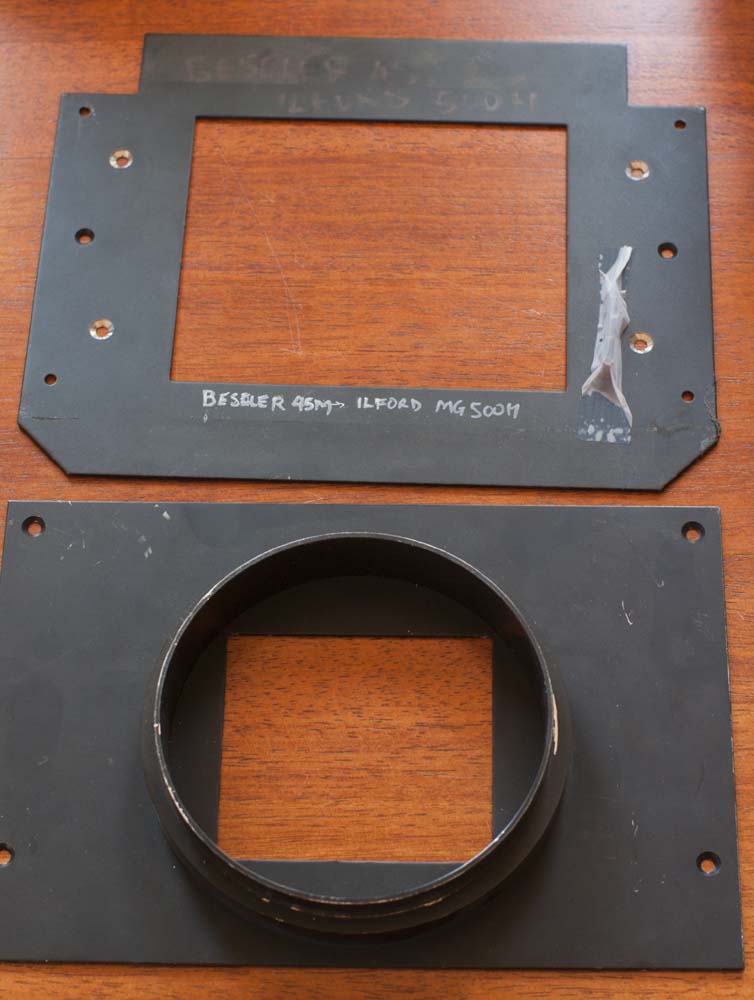

First up, here is the adapter plate for the Beseler 45 and one for an Omega (not sure which model). The four screw holes that you can see clearly on the Omega plate are where you attach it to the head. The innermost set of holes on the Beseler plate (the shiny countersunk ones) are where you attach it to the enlarger. You unscrew the two sliders that hold the lamphouse in place and attach the adapter plate using the slider screw holes. You then attach the Ilford head to the plate.

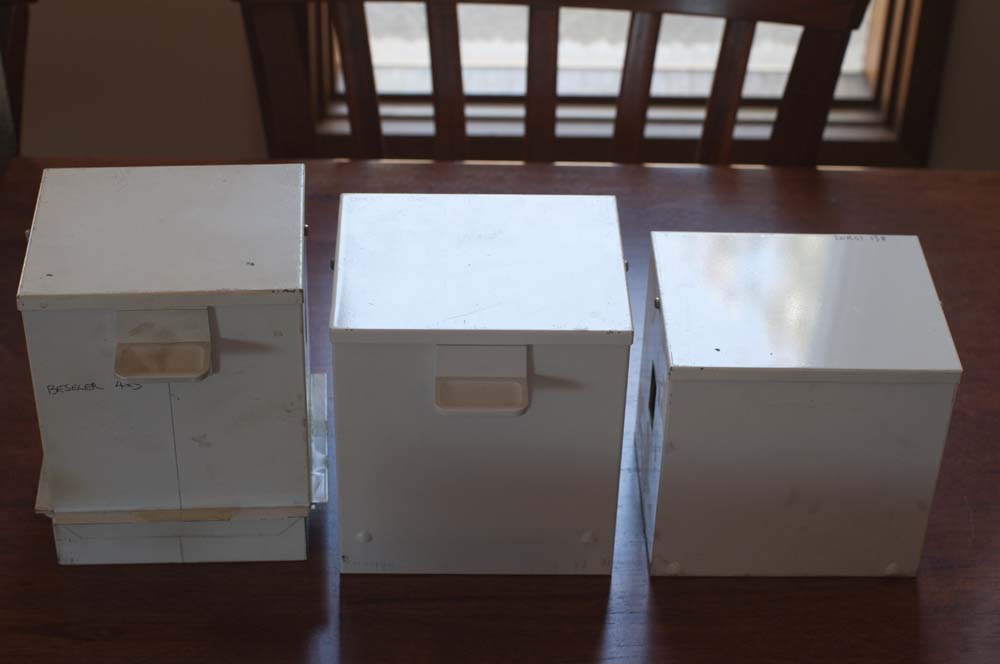

Here are three 4x5 mixing boxes: L->R Beseler, Durst L1200, Durst 138

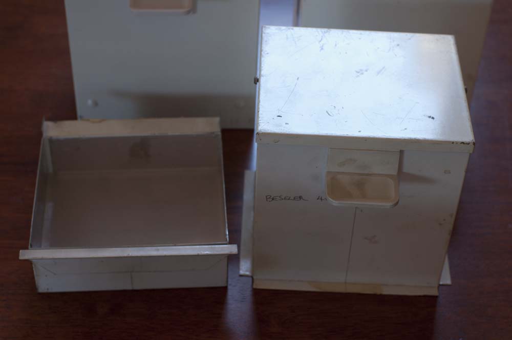

A closer look at the two part Beseler 4x5 mixing box

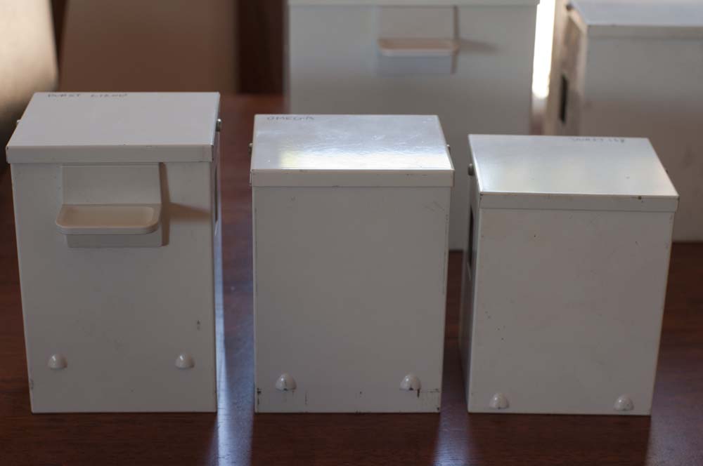

Three Medium Format mixing boxes: L->R Durst L1200, Omega, Durst 138
and finally three 35mm mixing boxes: L->R Omega, Durst L1200, Durst 138

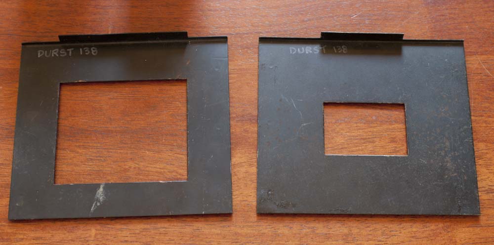

Oh, and mustn't forget the spacers to use the different size mixing boxes:

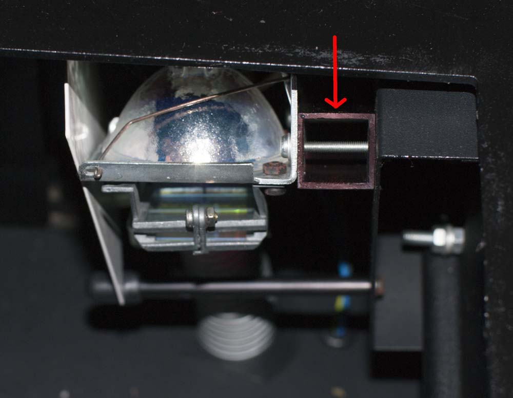

and the spacers to shift the lamps forward when set up for a 4x5 enlarger:
That spacer is a bit tricky. The first head I bought came on an Omega which was set up for medium format (as seen in the previous post) and that didn't have the spacer. When I set it up on the Beseler the hole in the side of the mixing box didn't line up properly. I found out about the spacer and made my own (it is just 25mm alloy square tube) and all was well. When I got the Durst L1200 it already had the spacer and all of the mixing boxes worked fine with that. Just another trap when you swap heads form one enlarger to another.

The top half of the Beseler box is 130mm w x 110mm d x 135mm h and the bottom half is 130 x 110 x 45. On all of the boxes it is only the height that varies and I think that the Beseler 4x5 box was just a little too tall to be removable if left as one piece.
