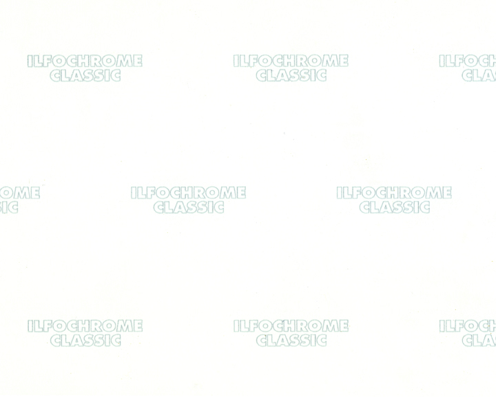

With most people now having their Ilfochrome Prints on Polyester base instead of Paper and fewer and fewer people buying Ilfochrome with back printing I thought I would scan some of our back printed Ilfochrome to show what the back print looks like.

Stephen Frizza
Mar 2, 2007
1,464
Yes. The minimum order I think is $42,000 euro. The product has a very different look to that of the Polyester base.

That's interesting indeed. I have never before seen Ilfochrome prints with watermarked backs like that. So it's only on Ilford's paper-based Ilfochrome media and not on the traditional Melinex (poly' base) material? Explain "different look" in relation to the traditional media.

The paper base Doesn't have the same light reflective properties and the colour gamut is slightly different. It just doesn't have the same punch as the poly materials. What I love about the paper stock is the thickness of the paper base its twice maybe almost 3 times as thick as any Ra-4 stocks Ive used. I think It's a beautiful material. though many who see it don't realize its Ilfochrome
