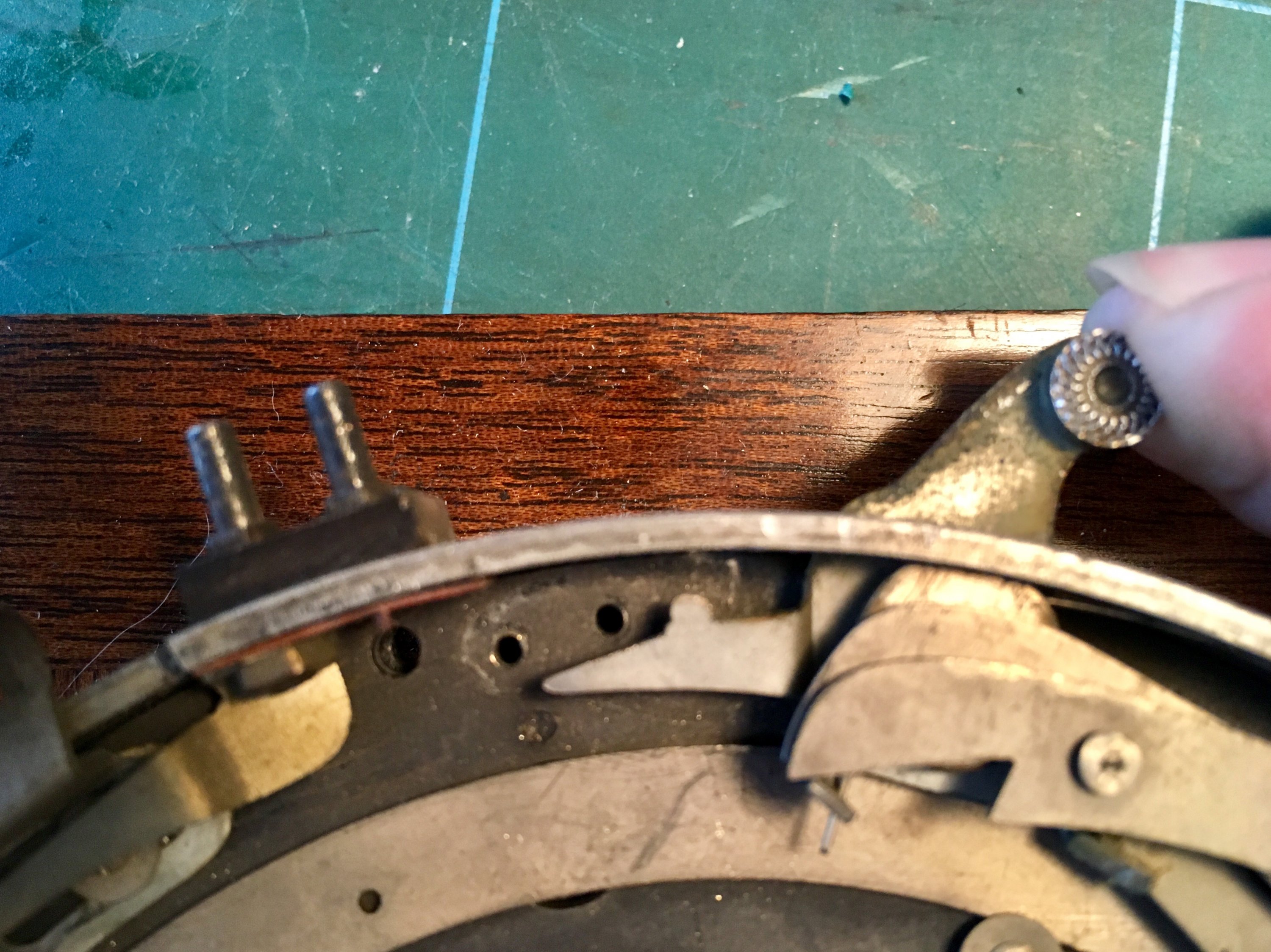

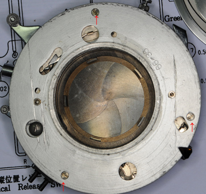

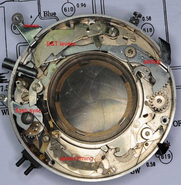

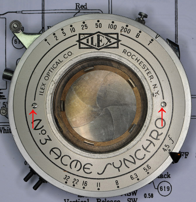

I only have an Ilex #3, build should be the same as a #5. Remove the two screws at the arrows and lift the face plate off the shutter. Lift the speed ring off the shutter working it back and forth as needed to prevent bending it. On reassembly ensure speed timing lever is on the outside of the gap otherwise speeds will not be selectable.
Remove the three screws at the arrows. Functions of the shutter are labeled.

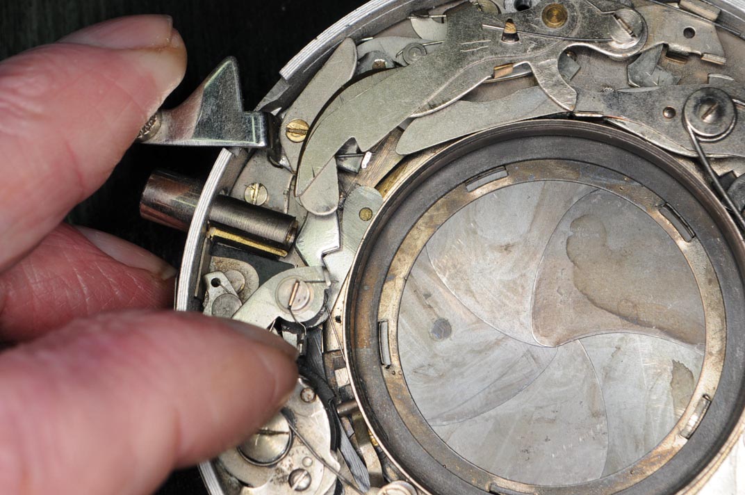

This locking cable release's plunger is too short to trip the shutter.
Reassembly is reverse of disassembly. Take good pictures as you further disassemble your shutter for reference on reassembly. Shutter blades are hard rubber and will be destroyed by solvents such as lighter fluid/naphtha.

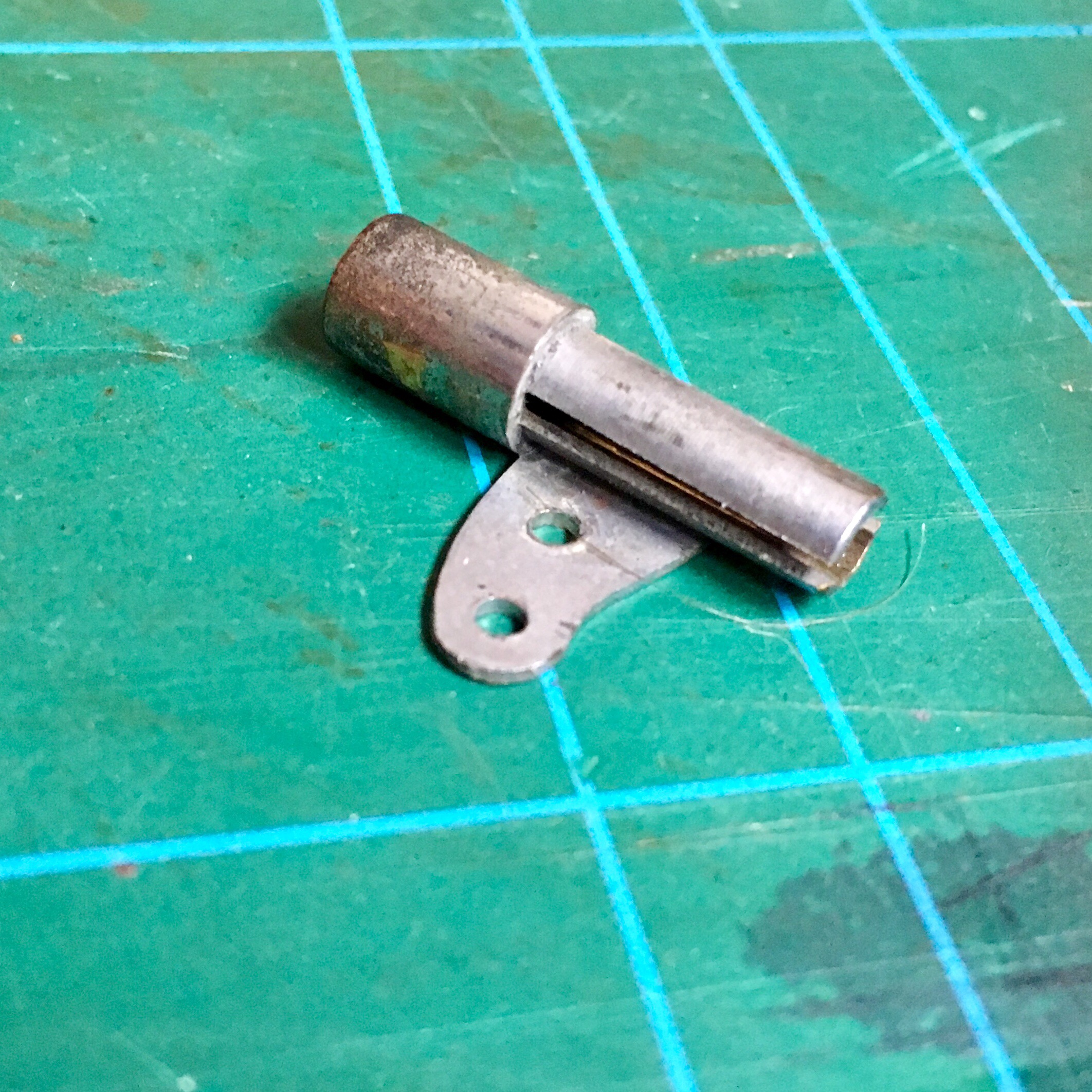

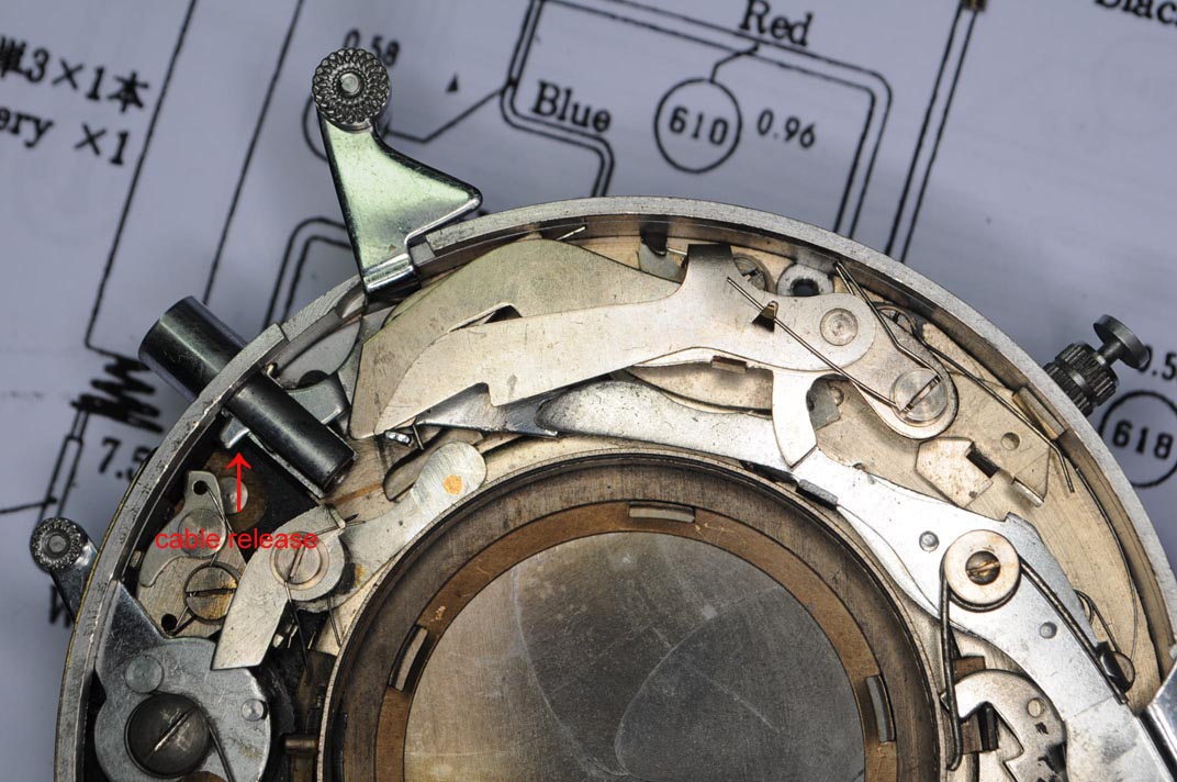

Thank you very much. I allready opended the shutter, mine is a little different (simpler?). It looks like this:
ILEX No. 5 Universal Synchro (Cable Release Socket removed)
The cable release socket
The opening for the cable release socket, screw holes for mounting
Top view. Here you can see a little ›nipple‹ on the lever that is running inside the cable release socket. This is the ›pushed‹ part of the lever. The ›missing‹ part (›pin‹ or ›stud‹) has to be inside the cable release socket. The cable release will push the pin, and the pin will push the lever. As you can imagine, if the cable pushes directly against the rounded ›nipple‹ it will slip, no matter if the cable release has a rounded of flat tip (is this correct english? Please correct :smile: )

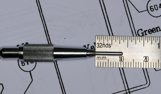

The ›Gebr. Schreck‹ cable release has 23mm throw.

I have a black face #3 that is about the same internally as the silver faced one I posted the pictures of.
The release lever is different from yours
You can remove the release lever for the socket and build up both sides of the nipple so that its wider to prevent the release plunger from sliding off. Soldering some brass stock to the sides should work.

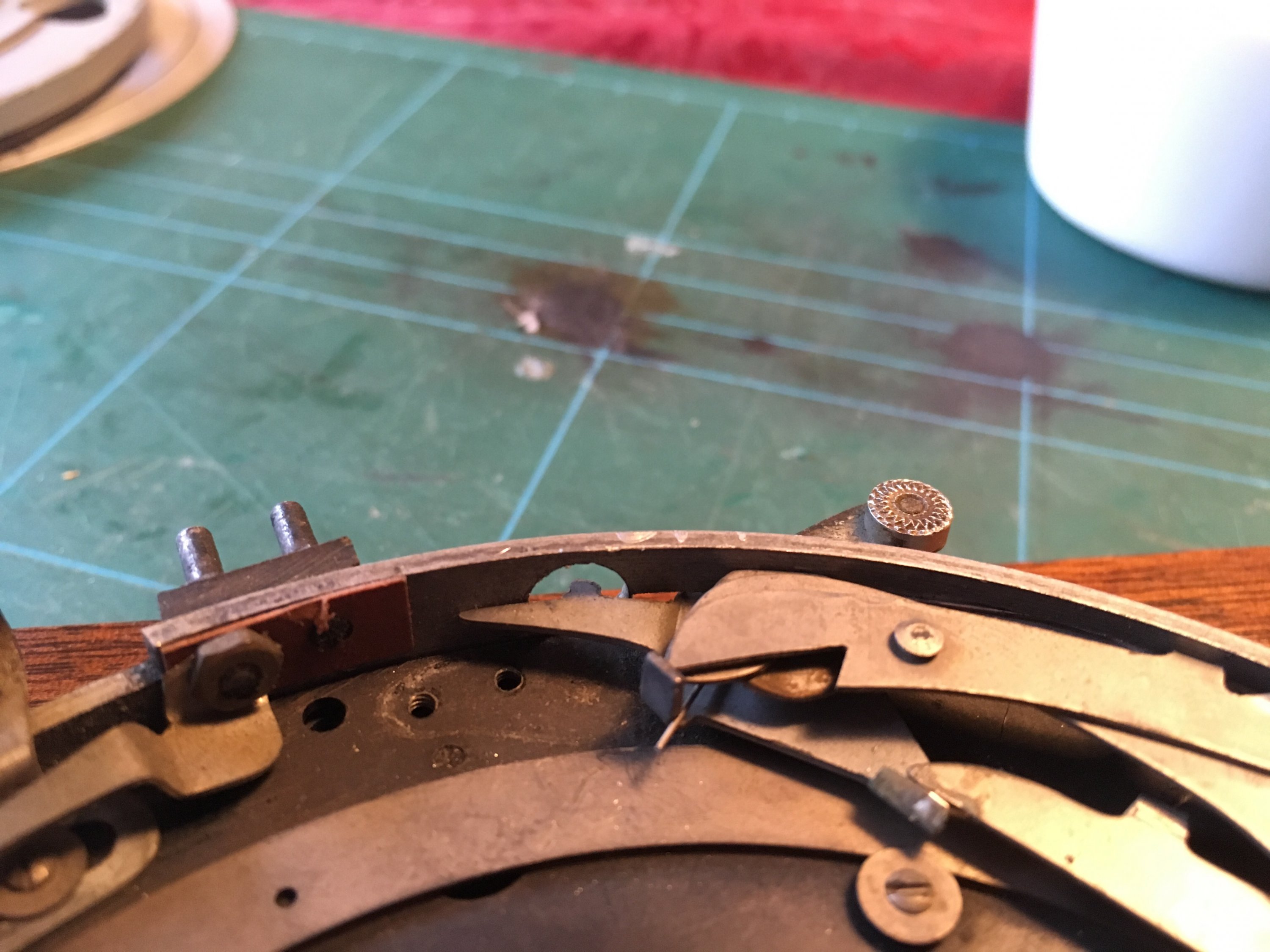

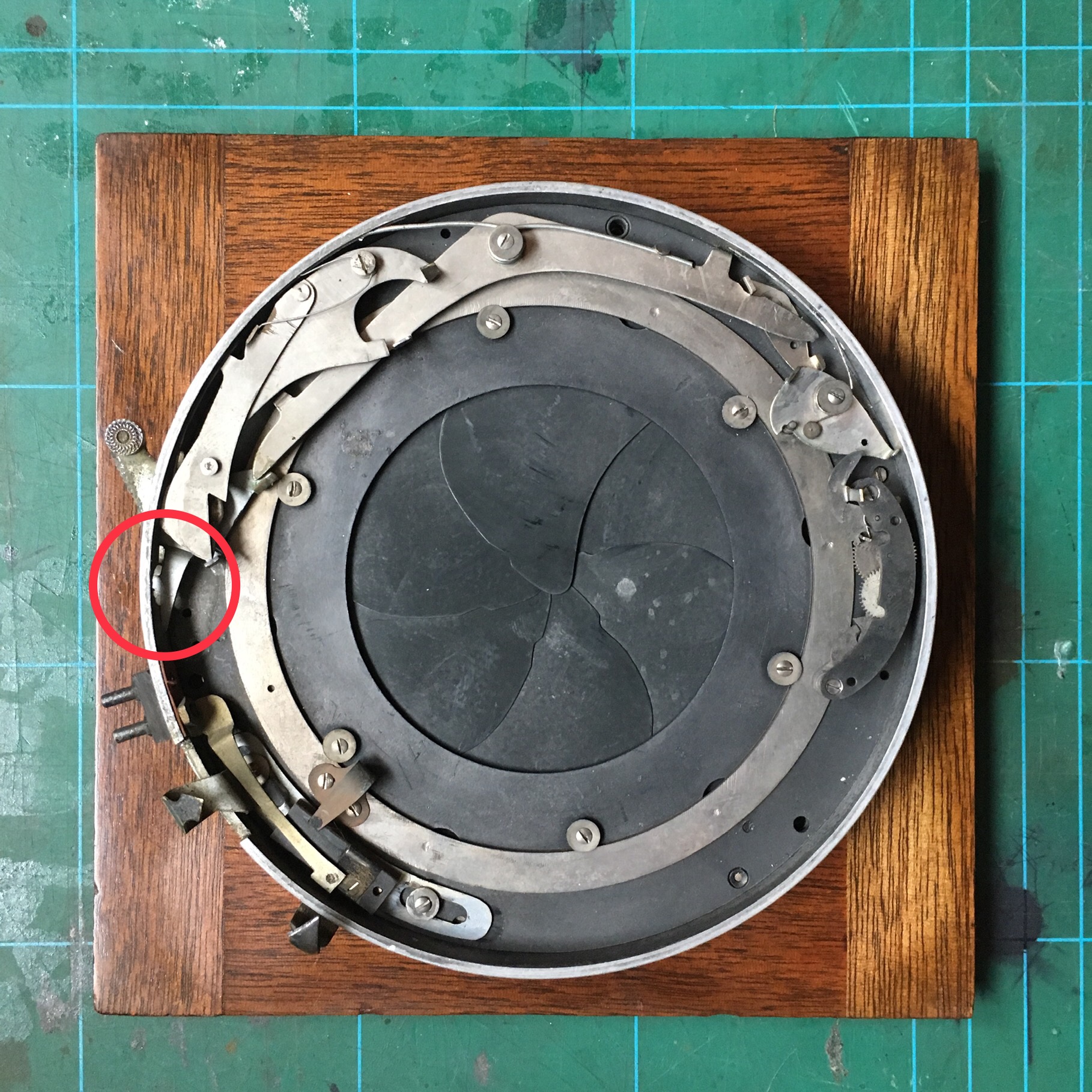

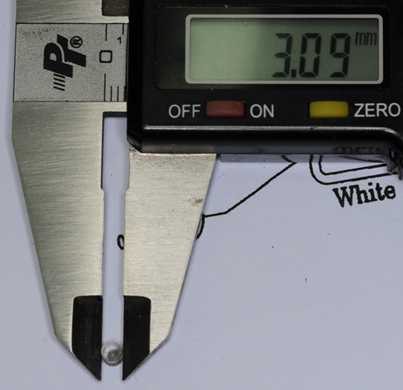

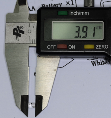

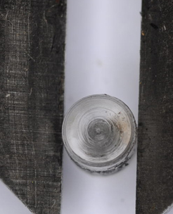

This is the part that is missing if your cable release will not work.
Its a type of plastic, possibly to save weight, but brass or aluminum rod should work fine. Adjust length for your cable release.
A 5/8 - 15mm plunger length cable release operates the shutter with this spacer in the socket.
This is fantastic, thank you very much! This is the first and only information about the actual part. This really helps a lot :smile:
I made a very simple replacement part today, it works :smile: I cut a 4mm pice from a 3mm Aluminium rod, filed the end flat and installed it. I will try to make a nicer part in the future (more shaped like the original), but for now I am a happy camper.
