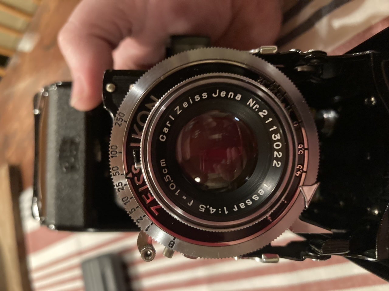

Here’s a pic

Are you thinking that the lens in your photo is coated? I don't see the red T mark.
Upon closer inspection in good light it is definitely an uncoated lens. Although the shutter has flash sync which from what I'm reading didn't appear until after the war. So perhaps as Dan Daniel mentioned it was assembled from left over parts after the war?

I would actually think that it was assembled before the war. I've seen pre-war Compurs and Compur-Rapids with flash syncs installed in place of the cable release socket; I don't know if the sync was changed at a later date or if it was an original option. Zeiss was out of commission for a while after the war, longer than companies like Rollei and Schneider, for example.
I'm with takilmaboxer- those uncoated Tessars can be amazing lenses. Prone to flare if it gets too much direct light, but other than that very sharp and beautiful tones in B&W (I simply haven't shot color film with them so cannot comment).

I'm leaning towards pre war as well now. I found some info elsewhere that most if not all post war Ikontas had a star after the serial number whereas mine does not.
