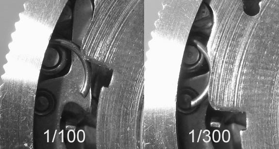

My shutter is working fine for the longer times but the ring won't turn past 1/100 sec.(the quickest is 1/300 sec.) - has anybody encountered this problem? I rather dread to take the mechanism apart.
The shutter has a booster spring that engages when you set it to the fastest speed. It can be rather stiff.
Spottymaldoon
Sep 15, 2008
5
Hooray! Emboldened by the good people here I have removed the lens - you have no idea what a thrill it was to feel that sucker coming loose as I held the knurled shutter housing in a gorilla-like grip and put the torque to my home-made wrench- many thanks to those who responded so helpfully. JPD, you also emboldened me on the stiff shutter and, sure enough, I applied a bit of extra torque and now the 1/300 sec. speed is working fine (thanks for the pictures too) - would you disagree with the use of a tiny dab of lubricant on that cam?
