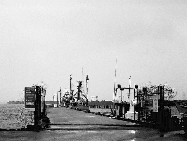

Well I processed it at just over 22° because it was a warm night & I don't have AC
I went with a time of 11mins. Got images but feel the blacks are black & I've lost detail.
My scanner is not much cop. Gotta get a new scanner, that's for sure.
I think FP4+ at 20° for 11mins in Fomadon LQN would be OK. I cooked it.
FED Micron ½ frame at North Arm Marina.
