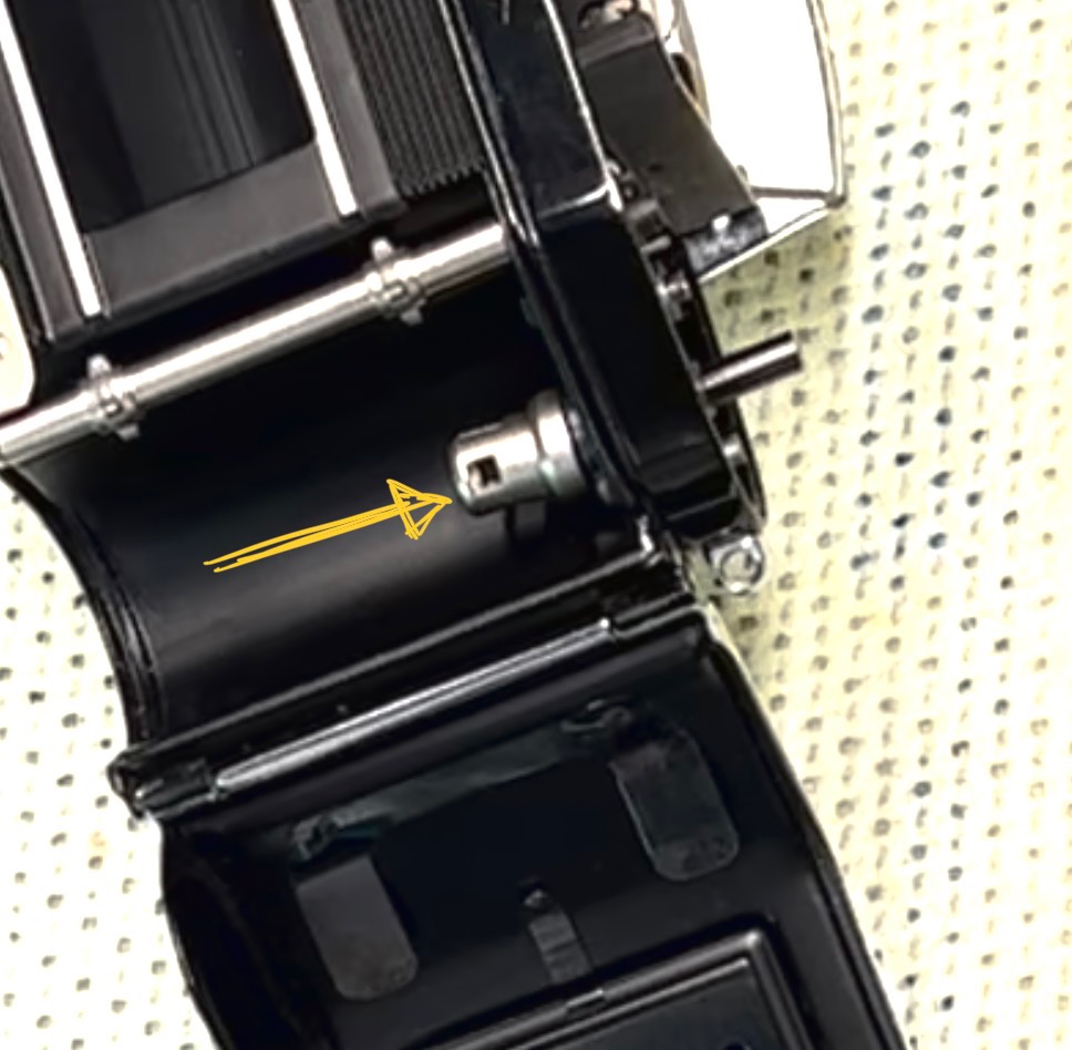

I recently received an Ihagee Exa — Version 1.4 according to Wrotniak's star notation. The camera is in outstanding physical condition, and seemed it was in operating condition too. It does work — but somewhere between the 6th and 12th exposure on every roll I've put through it, the teeth on the drive shaft become misaligned with the sprockets, it starts to tear, and the next advance, the film rips in two. Anyone have any ideas why this is happening?

Problem solved for anyone finding this thread later...
I knew there had to be some sort of slip bushing or something, somewhere in this camera, but without a repair manual or anything else to go by, it was guesswork, and I'd missed it. If you remove the take-up spool, the slotted end of the shaft that the spool fits into is in fact the slip bushing. You have to remove a spring that provides tension to the spool, and under it is a screw. Remove that screw, the bushing comes out.
The bushing was gunked with old hardened lubricant. After a clean in naphtha and a relube, I put it back, and it slips exactly as it should, allowing the film take-up to operate properly.

So, the friktion brake was gunked up?
Making take-up spool and sprockets working against each other.
Yes, precisely. Now I know what to look for should another Exa come my way!

One further comment from the original poster (me)... After finding and reviewing a German language parts list, the proper term for the part in question appears to be "friction bush(ing)" (Friktionsbuchse). The screw to remove it for cleaning and lubrication? That's hidden under what is simply and logically called the "spool holding spring" (Spulenhaltefeder).

From what materials is this friction coupling made of?
Brass, it appears...

Thus metal on metal?
I ask as we often discussed the funktion of these friction couplings in general, but never their built in detail, and exploded views in service manuals do not make one wiser either.
So far I never disassambled one...
Yes, metal on metal. I didn't think to take a clear photo when I had it apart, but yes, it's a very simple thing. On the underside of the part, there's a fixed spring to ensure that it will slip only in one direction. Simple design, and it appears to be identical in the full Exakta cameras (it is in my Varex and Varex IIa, anyway).
