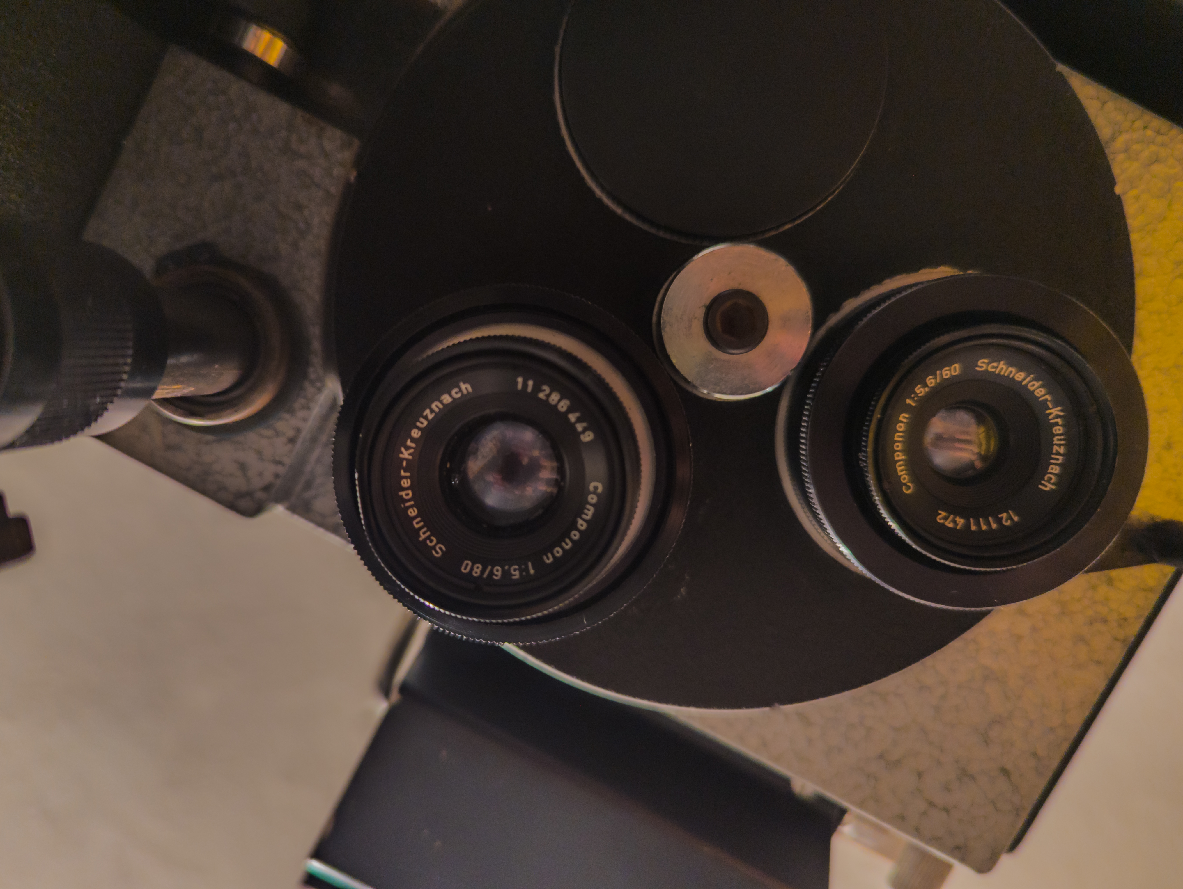

I recently acquired an old iff duogon.
It has a 50mm and an 80mm (odd choice but it is how it is)

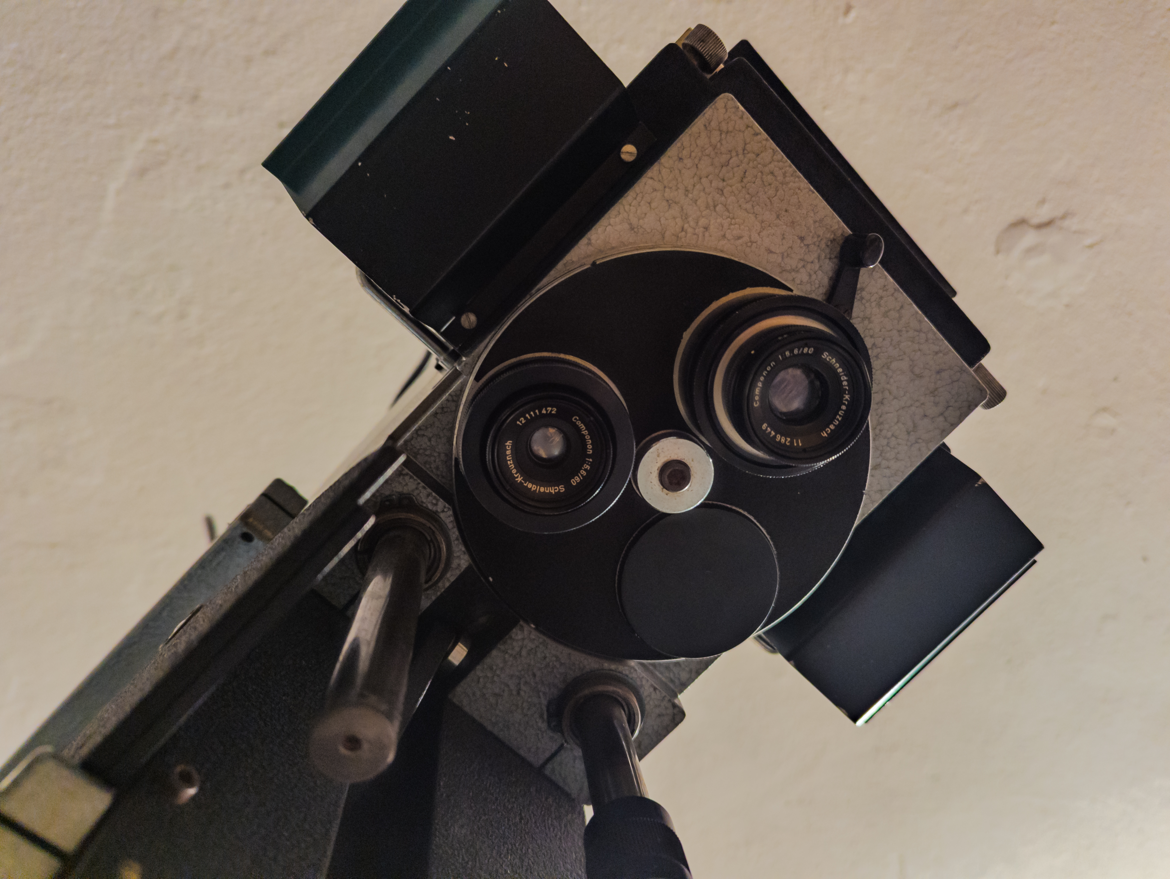

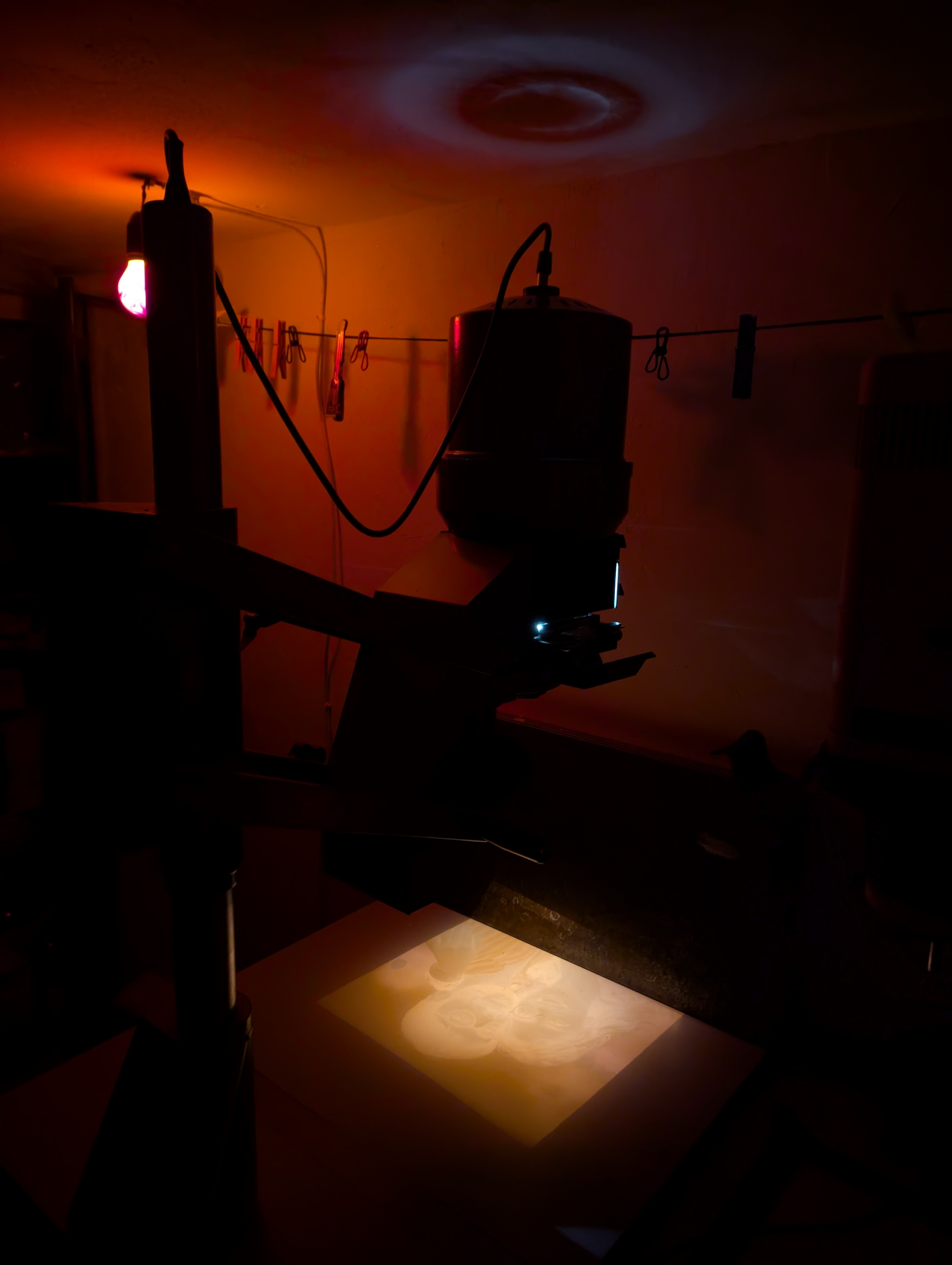

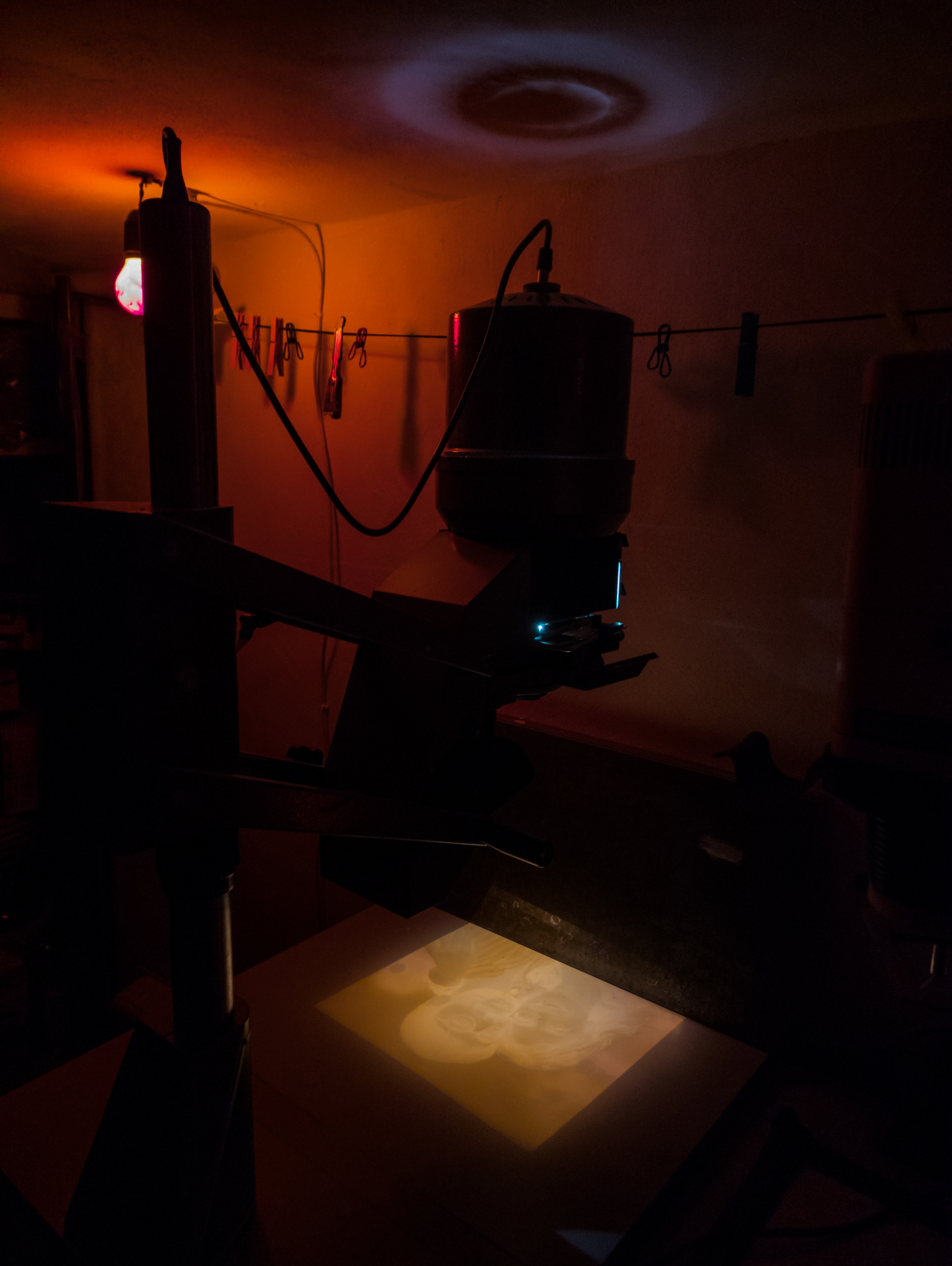

I am still on the cleanup and testing stages but I noticed I cannot focus the negative if I turn the column and project on the floor.
I assume this is because it'd need the lens to be closer to the negative?
The autofocus works quite OK and there's room to manually adjust focus.
I plan on trying to put a 105mm in order to print 6x9. I'll have to copy the lens panel (I have a 3d printer).
I cannot find any information about this model online, if anyone is familiar with it or has access to a manual it'd be much appreciated.

Thank you both. I thought I had attached images but apparently not.

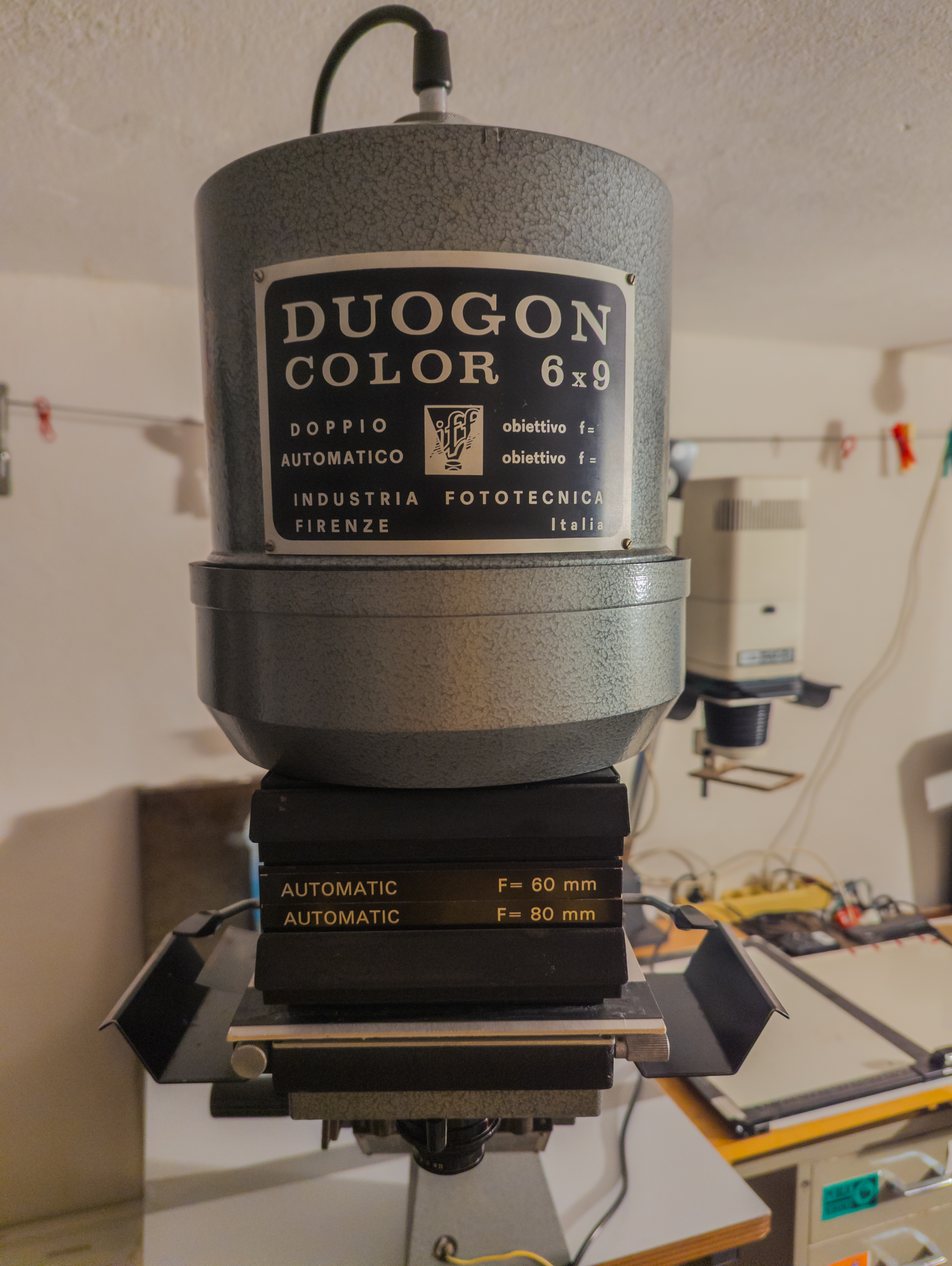

Here's the beast.

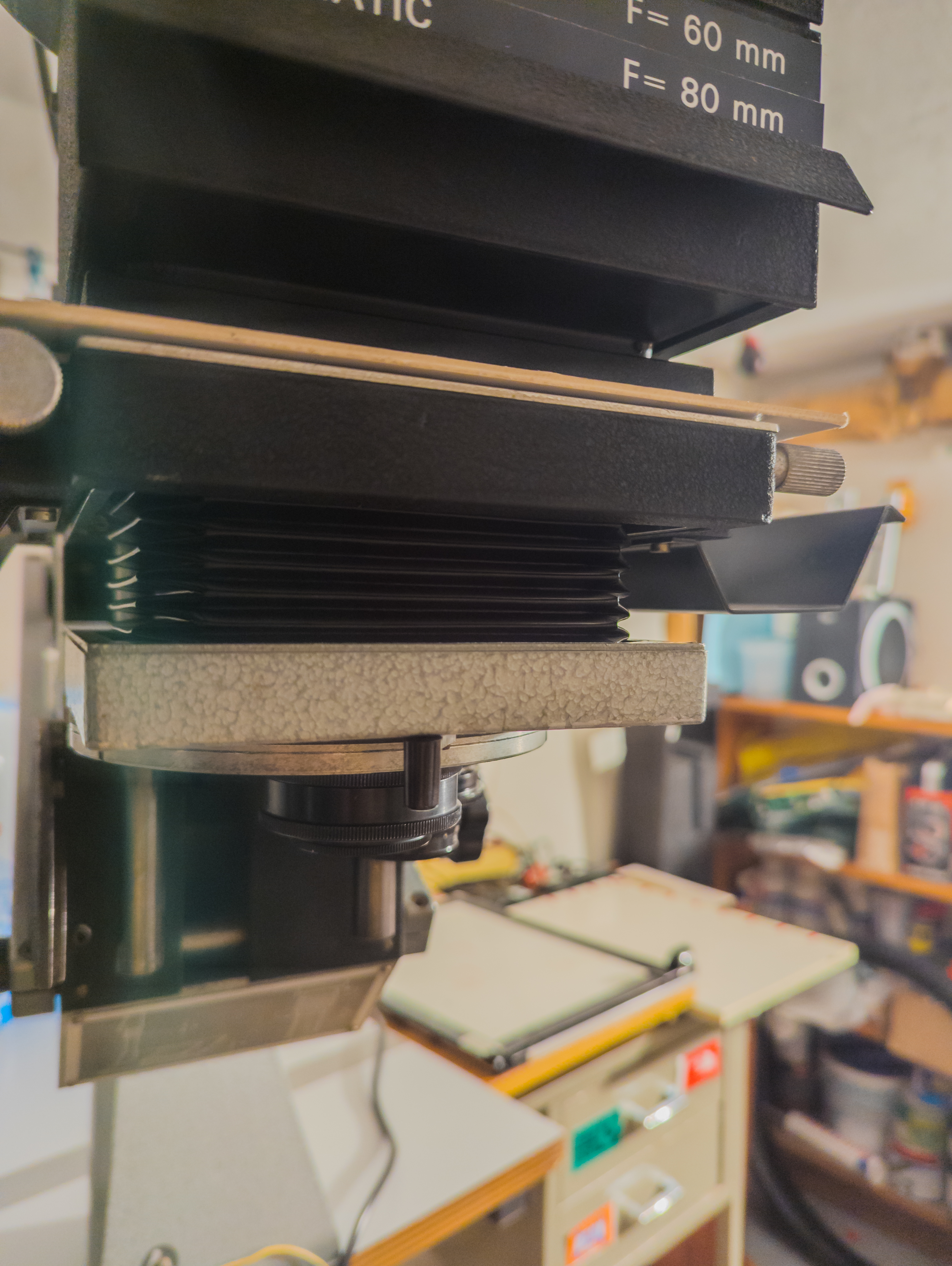

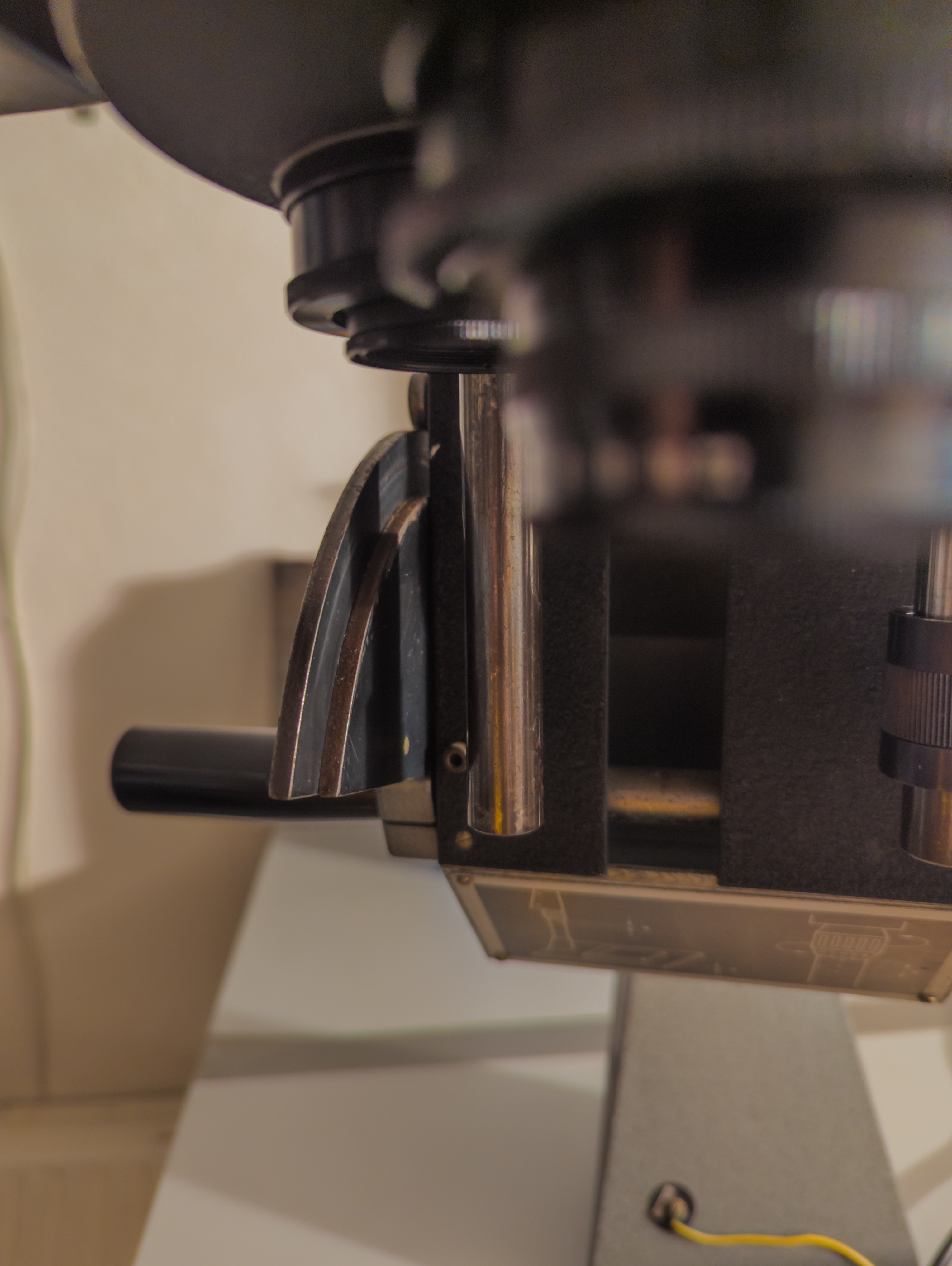

The duogon was a semi professional enlarger taking up to 6x9 made by iff in Italy. As the name suggests it has a cam driven mechanism for auto focusing 2 different lenses (as mentioned in my case 60mm and 80mm cams/lenses) via a rotating turret with 3 slots
There's pretty much no information online on this model (its the older one, they later made the duogon/s in the 90s I believe). An instruction manual would be very useful but I had no luck online.
Here's the most helpful links I found (both in Italian, the links are in English via Google translate)
I have some 30x40 and 50x60 paper I'd like to use
The baseboard is bigger than 50x60 but I cannot raise the column enough when on the table (low ceiling), I can get to about 30x40 but the projection goes over the far side of the board. I have yet to try to move the entire thing on the floor so to raise more the head and use the full board but lifting up and down the desk is well, difficult given its size and I believe the projection would again go outside the board.
I thought I could try rotating the column and use the floor but the projection is alway out of focus.

The IFF Duogon has a dual cam autofocus system, you must use only the two lenses it was set up at the factory in order to get the autofocus working. And it will work only if you project on its base. To project on the floor you must use the acccessory manual focus screw that raises the lens closer to the negative. You need that accessory also if want to print 6x9 and also need the right condenser for the 105 lens. I think with 6x9 and a 105 lens you can get a quite big picture in manual focus but I never tested how big you can go, for my needs the 50x60 cm that I can print on its base with my 100 lens is more than enough.

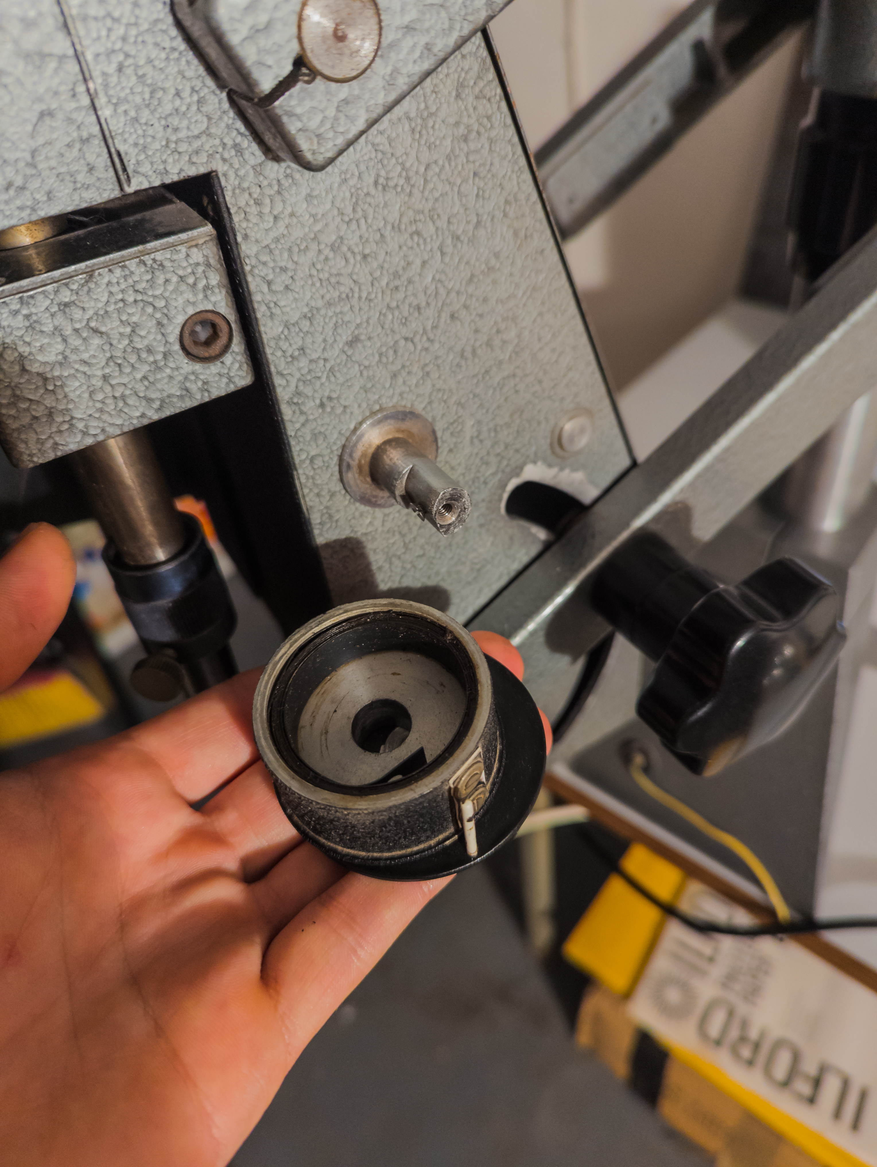

grazie mille per le informazioni! hai mai visto condensatori in vendita o elicoidi per le lenti?

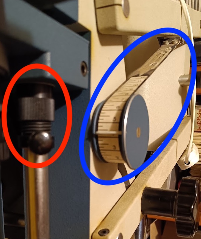

what does this manual focus crew look like?
also do you know what this knob might be for?
https://images2.imgbox.com/3e/cb/LgvBGR3I_o.jpg

In red the manual focus screw, in blue the enlargment scale.

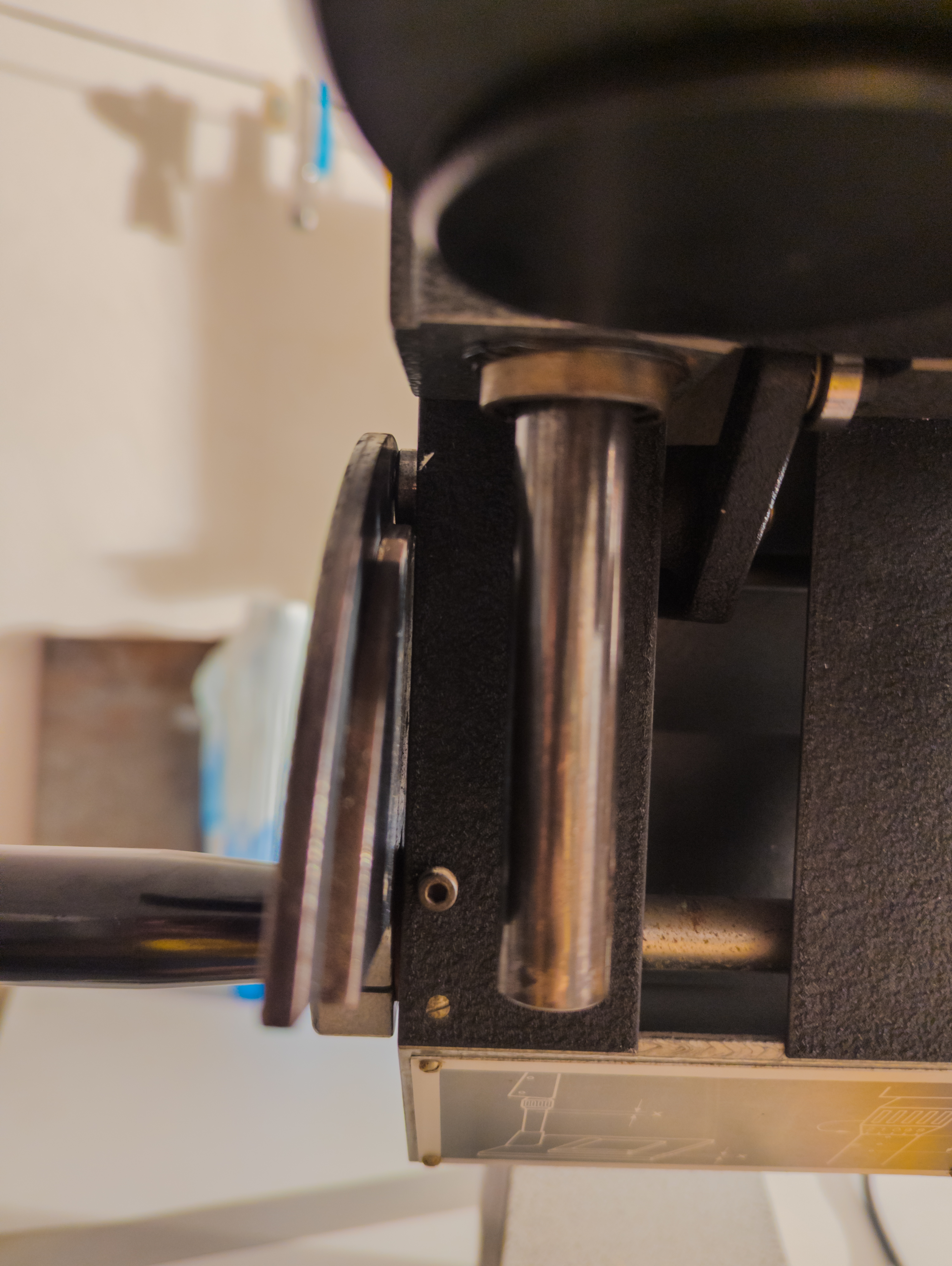

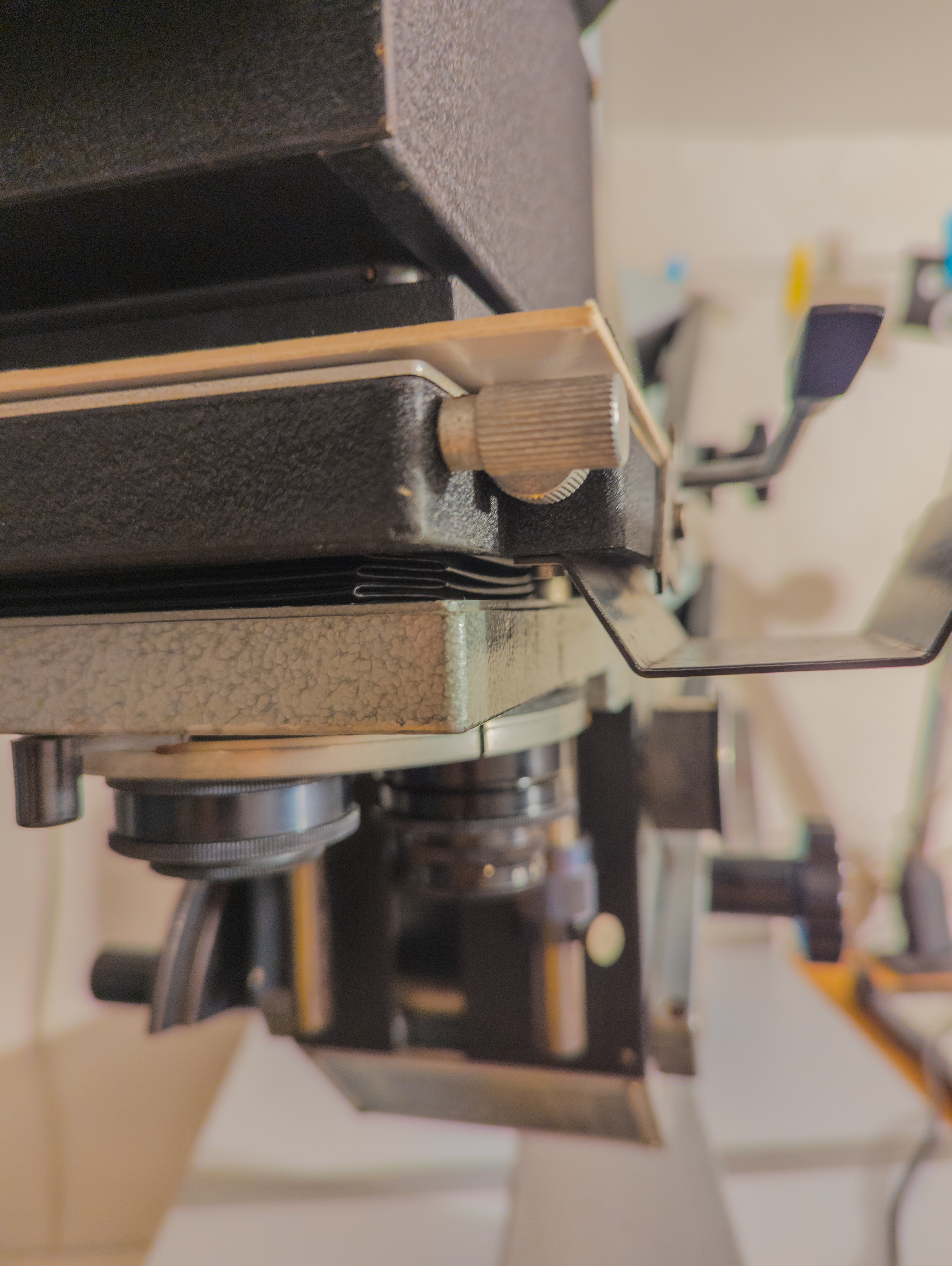

Thanks. Could you clarify how the screw for manual focus works? As you can see from the pictures mine is just on the metal rod but does nothing. It has a locking screw but does not do anything. The manual focus on mine happens via a helicoid on the lens turrets
grunf
Jul 5, 2024
9
Italy
1-unscrew the focus screw halfway
2-unlock the set scew
3-move the assembly up agaist the lens turret (you may have to disengage the autofocus roller) and press the turret up until you see the image projected in focus
4-lock the set screw
5-rotate the focus screw to fine tune the focus while looking in the grain focus scope
For what I understand the helicoid is not meant to be used as a manual focus, it's a setting for the lens and you should be able to leave it untouched if you use the original lenses. When you use an easel you have to raise the column accordingly without messing with the helicoid.
