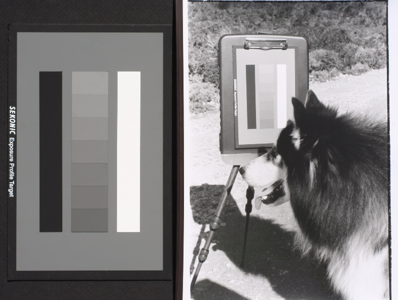

This was the best test shot I ever setup...
Plus you should include sensitometric exposures so you can graph the results effectively.
Thanks for the idea. I like the idea of the sekonic sheet and then a second frame with shadows and such in it. I'm not too familiar with sensitometric exposures. Could you please provide some more information, links, or advice here?
