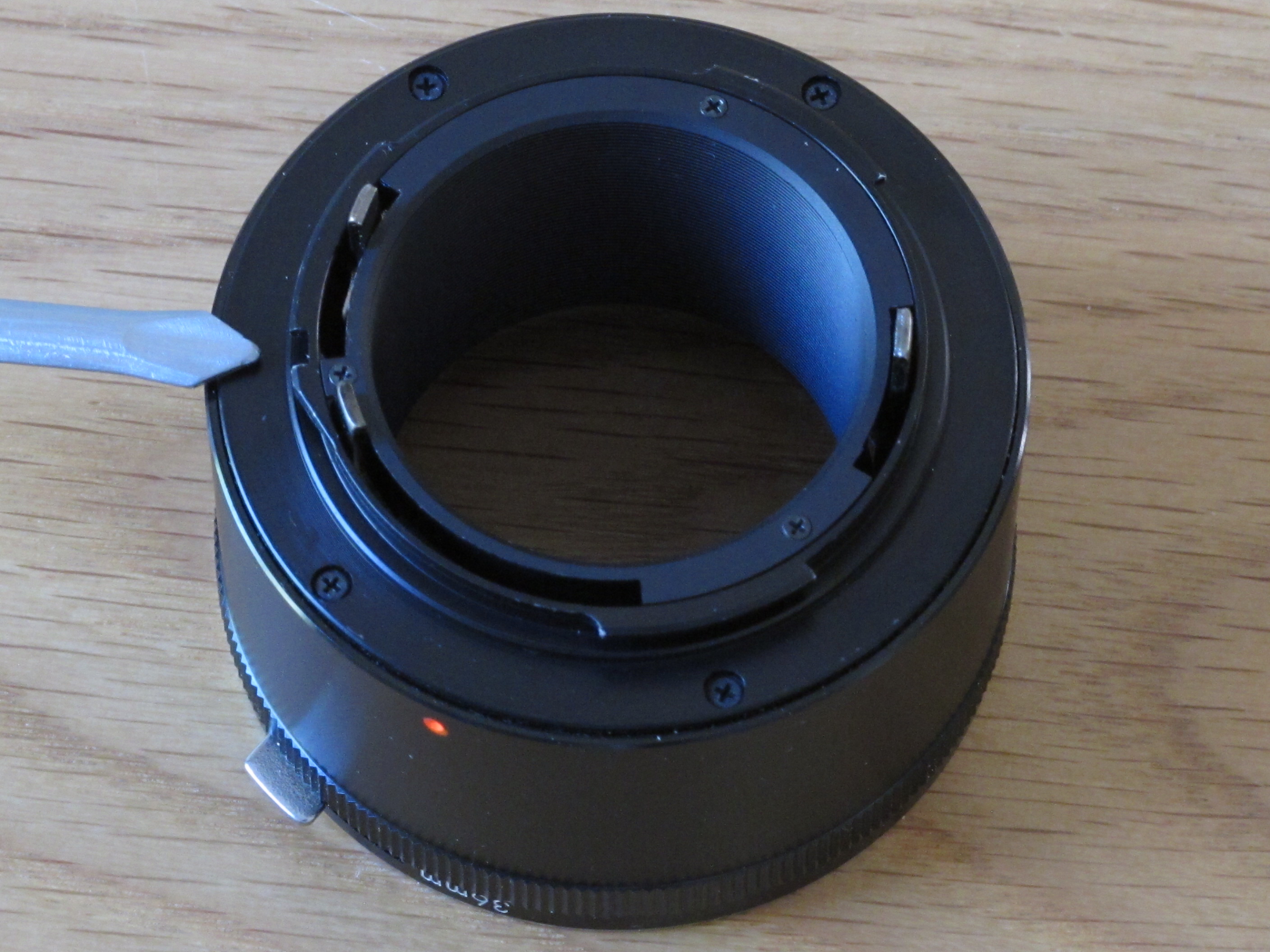

Hi, can anyone tell me what camera(s) this bayonet fitting is for? It's 1 of a set of 3 Japanese made extension tubes. There is a notch in one of the bayonet flanges for the lock pin. I think it may be Minolta or Olympus but I have no camera to check for fitting. As far as I can measure with a rule the diameter is 45mm between opposing 'ears'. Thanks in advance, Roy IMG_2126.JPG IMG_2127.JPG IMG_2128.JPG

With three actuating levers I doubt it's Minolta.
I'm inclined to agree with elcabezagrande and the Retina.

Yes I checked it better and it does look like the Retina C mount with recesses for the 3 levers. The red circle is not mine as it was on a reference article.

I think it's Contax/Yashica.
Ronnie
Thanks to all who have responded. I think Ronnie's answer is the most likely. I have looked at other images of Yashica/Contax mounts and the notch on the bayonet lug seems to be in the right place for a Yashica. I'm not sure what the 3rd lever nearest the notch does though. Once again thanks. Roy

ronnies, I believe, is correct. Although somewhat similar in that they both have notches, the Minolta mount notch is at the other end of that protrusion. Your mount is the Yashica bayonet mount. - David Lyga

The three levers are for auto diaphragm, set aperture and maximum aperture. The third max aperture lever is needed for the aperture displays in the viewfinders.
