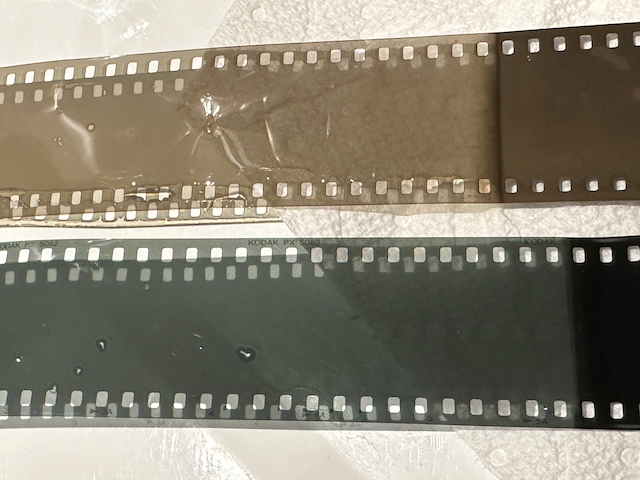

I bought two 100-foot bulk rolls of expired film from eBay. One is Plus-X, expired in 1998. The other is in an aluminum canister, with a handwritten "High Contrast" label taped over the original, which was Plus-X. There was also a bulk loader with what turned out to be the last remnants of another Plus-X roll. My theory is that the original owner loaded a pre-1998 Plus-X roll into the bulk loader and then reused the empty canister for whatever the "High Contrast" film was, if it didn't come in a canister itself.
The High-Contrast film is in an unmarked black plastic bag inside the aluminum canister. It is wound onto what feels like a metal spool, not just onto a core as I'm accustomed with bulk film. I loaded a short length of it onto a developing reel in my changing bag and developed it in 510-Pyro for 10 minutes, along with a similar snippet of the film that was in the bulk loader (which I now know to be Plus-X).
The film developed clear with a brownish tint. It has no pre-flashed lettering along the edges. It is drying pretty straight and flat, even when placed on its edge. Any thoughts on what this might be likely to be? See attached image of the mystery High-Contrast film along with the darker grayish Plus-X.
