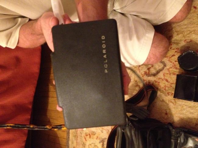

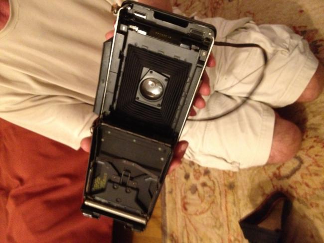

A friend is mailing me this Polaroid camera, but I cannot identify which model it is based on these vague photos.
Any clue? I would LOVE to hear that it can take FP-100C! If its one of those out-of-make films, that'd be a bummer.

A Polaroid 100. It takes the Fuji film. I have one.
NO WAY! You mean, the Fuji film that is still in production, and sitting it my camera bag right now? How are the optics on this thing?
I hope its functional!

Yep, cheap 'n' cheerful 3.25x4.25" FP100c works in it. You've got a 100 or a 250...I think the earliest 250s didn't say "250" on the front flip cover, just like the 100s. Easy enough to tell...the viewfinder for a 100 will have separate rangefinder and viewfinder windows, and the 250 has a zeiss-ikon finder that combines the rf and vf into one window. A lot of people place the ZI finder Land Cameras as a premium model of sorts, but personally, I prefer the two-window finder. Same lens between the 100 and 250.
The right battery for this camera is $10 online, otherwise if you're handy with a soldering iron, go get an LED flashlight at a dollar store, steal the 3 AAA holder out of it, and solder it in. You might find that the darkslide and first frame or two are harder to pull out of the camera...some people break off the spring tabs inside the back or hold them back with hair pins. I never have a problem with the tabs ripping off, etc. that others seem to report.
The lens is solid enough, a 114/8.8 triplet. If it has some serious sharpness shortcomings, etc., those are masked by the not-clinically-sharp instant film anyway.

The only gotcha with the Fuji film is the springs on the Polaroid go right into openings on the back of the film pack and can cause jammed/ruined images. There are several solutions, easily googled. However simply putting something across the spring so that it no longer fits into the holes, seems to work for most people.

Seeing your camera the way it's presented here, with the back of the camera and the lens board both concealed, no one can say for sure it's the 100, though it quite possibly is.
The 101, 240, 250, and 350 all look alike in this arrangement.
To find out what model you have, hold it with you facing its back, place your hand on the front of the cover and use your thumb up and over the top to reveal the lens board - it shows the model number.
Good news is, in any case it has the preferred triplet lens and can use FP100C.
To reduce the pressure of the clips inside the back, place a thin metal rod between the back and the inside surface of one clip where it meets the other, press down on the clip, near the end, repeat procedure for the other clip.
Yes, we all like to keep things original, but if you try to use FP100C (with its plastic pack), without modifying the spring clips (made for steel pack Type 108), you'll only have heartbreak when the hard steel clips tear the film apart.
