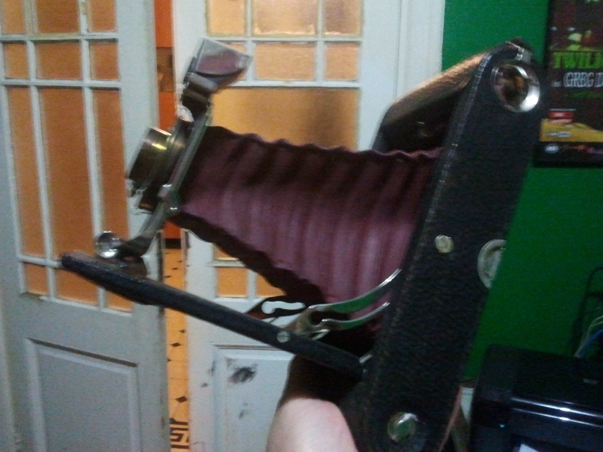

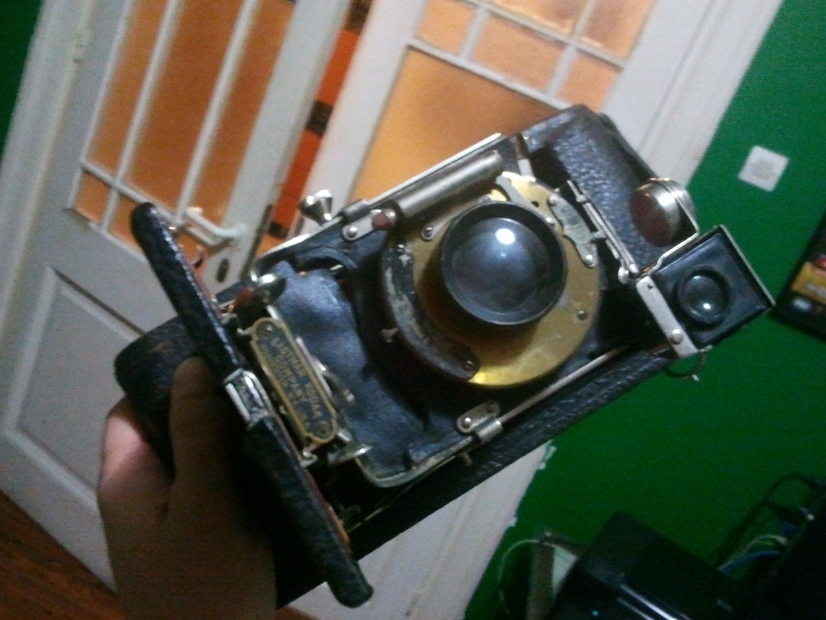

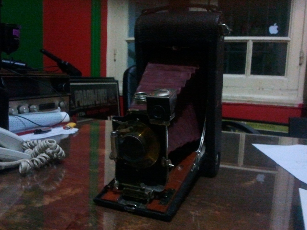

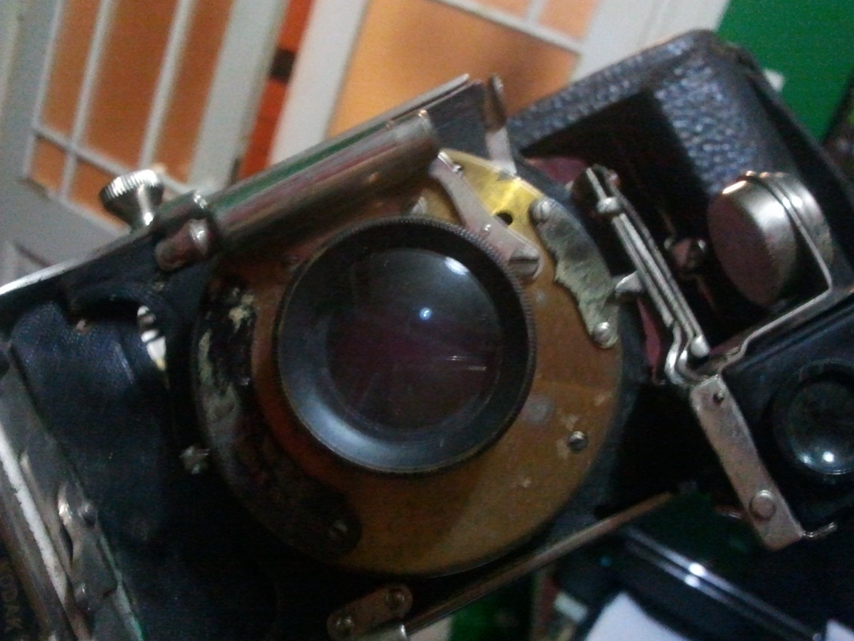

So, I stumbled into this camera last night (see attached photos) and I was amazed when I opened the back - this camera accepts some sort of roll film (wooden rollers) but it is bigger than medium format film. As a matter of fact, it comes pretty close to large format film, only its ratio is more like 3:2 than 5:4. The bellows were in a sad state, the lens looked OK, the (Bausch & Lomb) shutter didn't want to obey any settings (although it did fire at a very fast speed), the overall condition could be described as "junk"... but I still want to find out which model it is.
Any idea on the model number, production dates, lens, etc?
PS: sorry for the crappy smartphone photos.

It looks like a 3A. There are many different models of that particular camera, some made in Britain and some in the states. I have one with a Zeiss Tessar on a Koilos shutter that has a separate plate back and holders as well as the roll back. The lenses are good cheap ways to break into 4 x 5. Assume the shutter is firing at about 1/25 and go for it. That's what my old beat up shutters seem to settle at when they don't adjust anymore. if the bellows were serviceable you might put in a mask and set the thing up for 120. You can get 6 x 12 images on roll film with some care.
