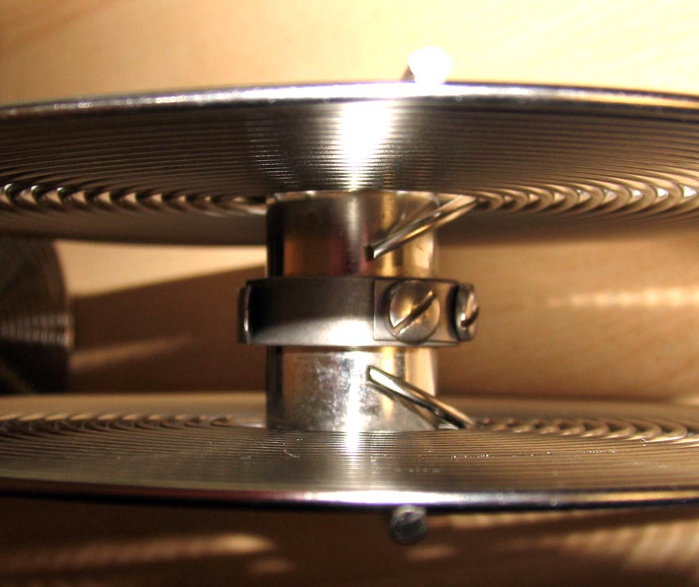

On a hunch, I snagged this obviously longer than normal 35mm stainless reel dirt cheap on That Auction Site - sure enough, it is big enough to handle my Canon 100-exposure bulk rolls with a few turns of the spiral to spare. No way it would handle the older 250-exposure back cartridges though. It's like it was made specifically for the FN-100 back. It came without a tank but I think if I replaced the center stalk in my Jobo 3033 tank with one slightly smaller in diameter it would actually work in there. The center clip is very reminiscent of the long-roll (250 exposures easy!) Nikor reel and tank I had way back when. But there are no markings on it anywhere to tell me who made it.
SO, anyone recognize this thing? There's a picture showing it next to a standard Hewes reel (showing that the spoke wires are about that same thickness) and then a picture of the center clip. The diameter is about 6.5 inches, while the Jobo tank is about 7.5 inches (and those old Nikor bulk reels were nearly 12 inches!)

years ago ilford made hp5 in 72 exposure rolls and one had to have a special over size reel and tank for development. I don't remember it having that ring with screws in the middle but it was certainly oversized. It also had a special loader to help get the film on the reel as it was very thin. I found that to be a waste of time, as it just took a bit of practice to learn how to handle the thinner base.
I thought of that, but I'm pretty sure I've seen the Ilford reels in the past and they were not this big. I load 108 exposures in my FN-100 carts (3*36 exposures) plus generous amounts of leader, and this thing easily swallowed up a test strip of film with lots of room to spare...so it would be significant overkill for 72 exposures.

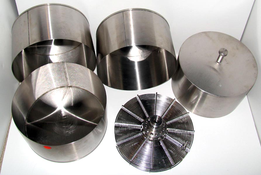

OK, another clue! It's definitely Nikor, as I have now come across another couple of reels, complete with two tanks and a lid. Weirdly, even though I got all these together, the lid does not fit either tank. (You know how stainless stuff is matched when made and you can never mix them up? Apparently doubly so for this big stuff, the lid will not even remotely fit over either tank; it's basically the same diameter, instead of being a hair bigger...) So I'm still on the lookout for these parts. Anyone ever seen this stuff before or know where there's a cache of it? Along those lines, anyone ever seen a Nikor catalog, so we could know definitely what they made?

Nikor also made a loading machine for 28, 50 and 100 foot lengths of 35mm, 46mm 70mm, 3.5" and 105mm film so these are the different dimensions of Nikor reels that are out there. I think there was different sizes of reels and tanks depending on whether you are processing motion picture films, filmstrips or micro film versus standard long roll films. The reels used for 35mm motion picture films were 9" for 28' and 16" for 100' of film. I am still looking to see if I have any information on the smaller sizes of reels for 35mm film that fit the smaller 7" nesting tanks.

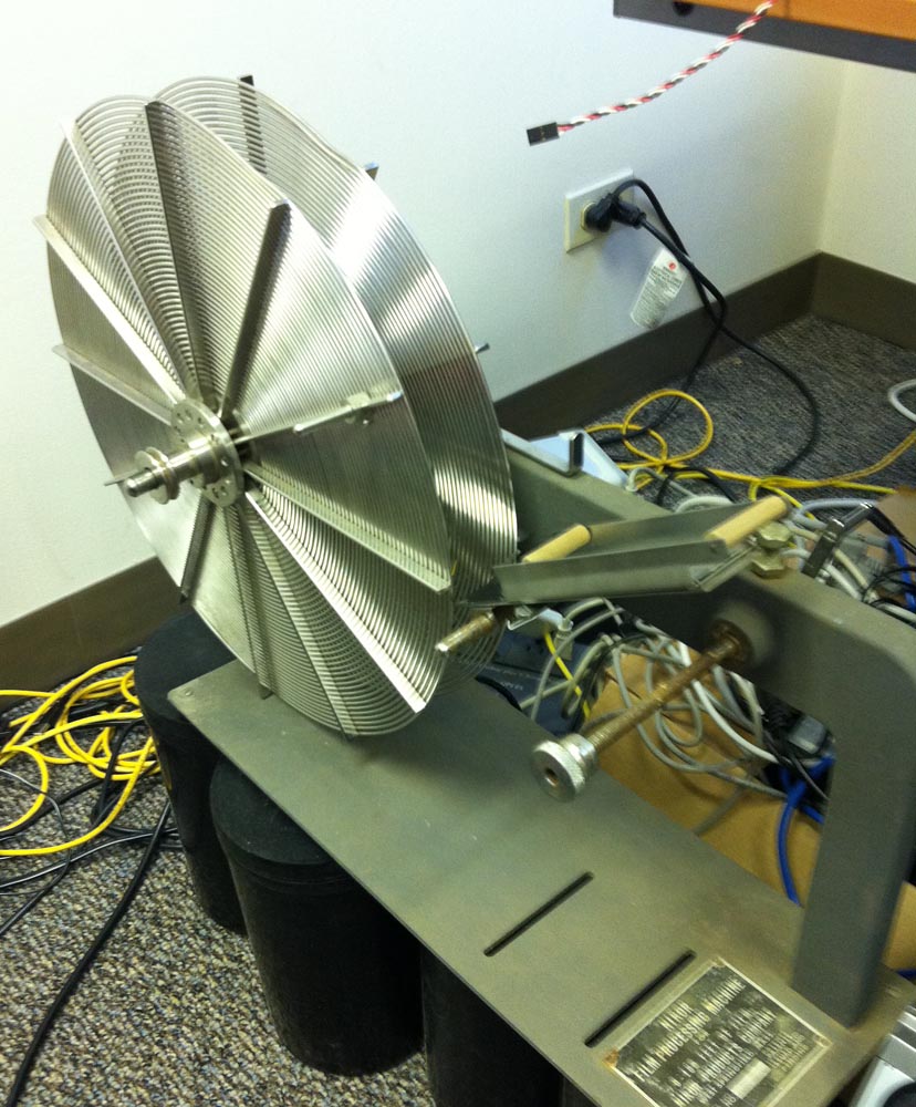

Do you have a picture of your nesting tanks? Are they just a smaller version of the big ones? That's interesting that you mention they made a 46mm version. I have a 46mm 100 ft reel (advertised as 35mm :-( :-( ) that looked to me like it was very professionally cut down from a 70mm reel... but I suppose it could have been Nikor doing the cutting from their stock of 70mm parts. I have two loaders, a set of the big (100 ft I think) nesting tanks, the 46mm reel, and a 16mm reel. Still looking for a 35mm reel. Long ago I had the (50 ft I think) nesting tanks and 35mm reel and unwisely sold it all.
How about some informative pics and stuff:
My old tank set and reel (my new tanks look just like this but bigger, but I haven't taken pics yet):
A loader and 46mm reel:
...and I've scanned in the instruction manual for the long reel stuff, but I don't seem to have put it up on my website yet so I'll have to look for that later and post a link. At least when that was printed, there was no mention of 46mm being available.

Hey, sorry for the 7+ year delay here, but thanks to an inquisitive APUGger (Photriot?) I realized I never followed through with the scan of the manual for the Nikor long reel equipment.
Here's the high-res version which is 8MB: http://backglass.org/duncan/apug/nikor_long_reel.pdf
Here's a lower res 1MB version: http://backglass.org/duncan/apug/nikor_long_reel_100.pdf
Sorry to all you collecting completists out there: I just added a couple of completely unobtainable items to your must-have lists. That wash tub is pretty slick, as is the motor drive for the loading stand.
