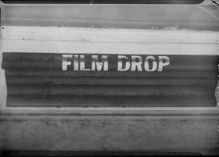

Like cmacd123 mentioned, look to see if there are any markings in between the Safety. I have a box of 2¼x3¼ Kodak Super Panchro-Press Type B Film that I acquired recently. It has a notch code, but reads: KODAK-SºAFETY-FILM, if it is different than this, you can at least rule this film out. By the way, this film expired in July 1965, I will have to adjust the ASA on it, but I got a fair image shooting it at box speed of 250.
