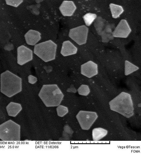

A nice example of structures :
This is the grain structure of Foma T800 BTW ( an early Tgrain from Foma)
It is from microscop. You will not reach this "cropping" in your darkroom unless your darkroom
have more than 15meters - guess exposure time is more than 4houts then......:D.....
but never mind to compare two films (same motif, same developer, same procedure) you don't
need that big scale:wink:....
with regards
AgX
Apr 5, 2007
29,972
Germany
This not the grain structure.
But an image of the crystals employed. In a processed film they are gone anyway.
