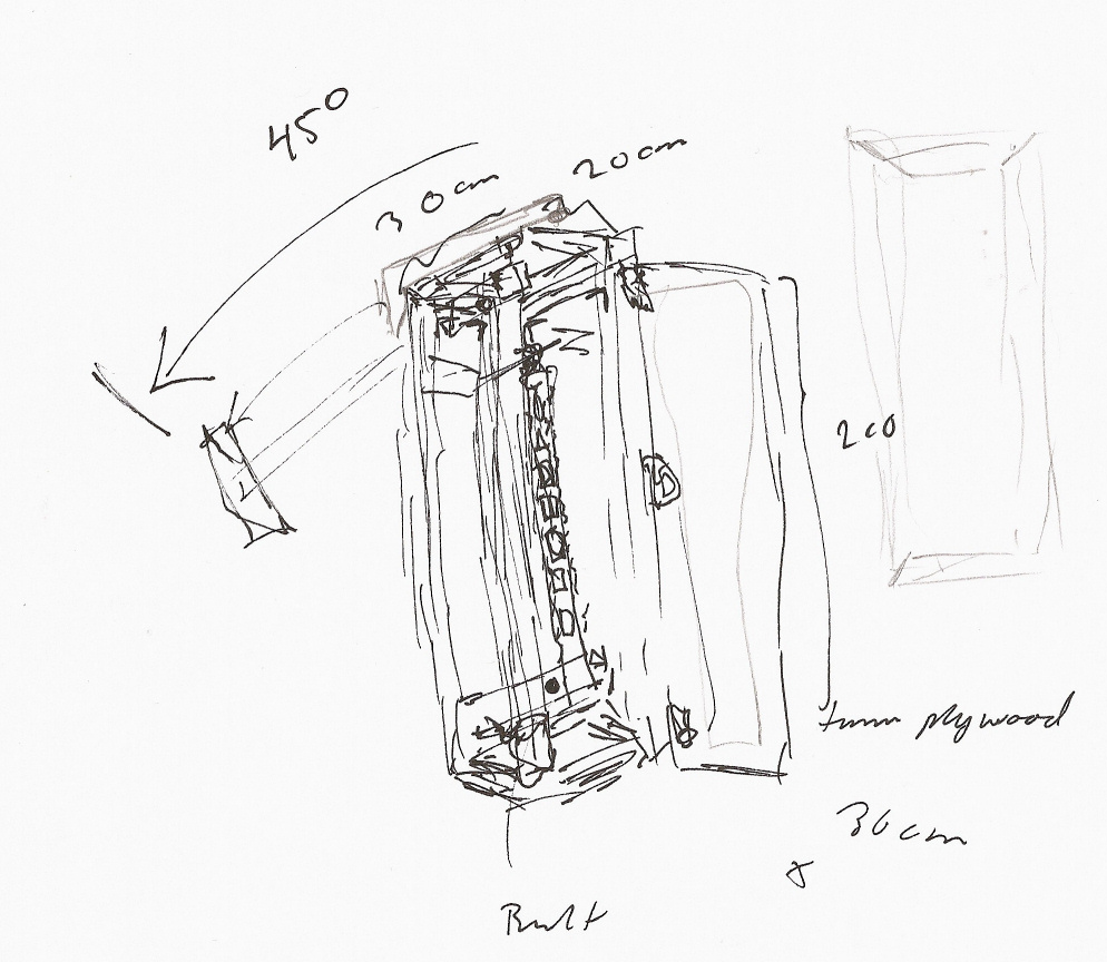

Hi!
Attached to this post is a quick scetch showing an idea I got for a home made film dryer. Essentially a small "warderobe" in which you hang your films for drying. After closing the door it should be possible to tilt the whole dryer 45 degrees in order to avoid water running along the whole length of the film. The deluxe version of the film dryer would even have a clear glass in the front and a lamp in the back so that one could examine the negatives while drying.
Has anyone built anything similar? Your feedback is very welcome.
Regards,
Erik Ehrling (Sweden)

I am not sure why you want to make it tilt. I built a large film drying cabinet because I run a lot of film. It is very simple and works very well. Just a box that stands 6 feet (2 meters) tall and is 4 feet wide and 2 feet deep. I put two screw eyes at the top of both sides and ran two wires the width. On the wires I threaded alligator clips to hang film from. On one end of the bottom I cut a hole to run the cord of a small space heater. I hang the film from the clips and on the bottom of rolls I attach a clothes pin for weight. Sheet film I hang by one corner. On the front of the box I have double doors that open the whole box up wide. Very simple, works very well, I don't know why you would want to make it any more complicated than that.
Maybe I should add that I shoot 35mm so I am really picky about anything that shows up when doing large enlargements (usually 40x27cm ~16x11"). What I have found out is that any water droplets on the non-emulsion side will give quite visible dry marks (even with a last rinse in distilled water + photo flo + isopropanol). Therefore, I wipe the non-emulsion side almost dry with a clean cloth already when I hang up the film to dry. This works fine most of the time, but I don't feel very comfortable doing this. Tilting the drying cabinet, I thought, would make the water run off the film much faster and allow me to avoid touching the film before it's completely dry.

I wouldn't be happy wiping films in most circumstances but it depends greatly on the type of cloth (I'd only use chamois leather) and the water supply. In Sheffield, where I learned to develop film, the water is so soft it's actually hard to rinse soap off your hands - drying film there is easy. When I moved to Brighton I couldn't work out why I was getting problems that I'd never had before. After 30 years of developing film here I swear by distilled water. If I can't get that I use a bottled water with a low calcium content - anything is better than the local stuff (I'm perfectly happy to drink tap water though!).
Why you want to dry your films more quickly? A traditional drying cabinet takes about 20-30 mins at 35 degrees C but, personally, I'd rather leave films to dry overnight - that way they tend not to curl so much, meaning they're easier to handle, sit better in the enlarger and suffer less from static (once you've 'charged' a film with over rapid handling it attracts dust, which often becomes 'trapped' with the film - in the neg bag for instance - and hard to get rid of...). Impatience can be the cause of new problems - never ever touch film before you're absolutely certain it's dry - not so much because you'll mark it with your fingers but because, if it's wet, it'll be sticky and act like fly paper for any dust that can enter the cabinet as you open the door.
And, incidentally, if you use a traditional dryer already, once it is dry, turn the heat down and cool the film gently down to room temperature before you open the cabinet - this helps prevent curling.
Thinking about it, I actually do two rinses in distilled water (It's become so automatic that I forgot that I do it twice) I use a Patterson type dev tank, with the film still on the spiral ; the first rinse to remove residual hard water left over from the washing process and the second rinse is clean distilled water with two drops of photo-flow/300 ml... I've used isopropanol to speed drying but only for emergencies, I wouldn't use it on a regular basis because of the reasons set out above. Also - I don't wish to imply that you may be doing anything wrong - but too much photo-flo can cause marks.
What's the nature of the marks you're getting?

I'm after clean negatives, not fast film drying. I would be perfectly happy letting them dry overnight if I get clean negatives that way.
It strikes me, however, that I should try another brand of distilled water and/or photo flo the next time. The distilled water I am using is called 'battery water' over here, mainly intended for use in car batteries, and maybe it is not clean enough. I'm trying to minimise the use of photo flo, so I don't think too much photo flo is the problem. Maybe it's very fine dust settling on the film before it has dried because I have a feeling that adding isopropanol to the final rinse actually helps.

Why not build an up-right cabinet instead, and just string the film from side to side inside the cabinet, diagonally?
So, if you open the cabinet and look at it from the front, the top of the film is attached to the top right hand side, and the bottom of the film is attached to the left side somehow. The film has to hang 'on edge' so that the film plane is vertical.
That way, any water that travels 'downward' from the top when the film is hung, goes straight to the edge, without accumulating a mass of water at the bottom of your film strip. That sounds a lot easier than tilting the whole cabinet, where you would have to hang the film diagonally anyway.

I doubt that dust would only affect the lower parts of your films. It's possible that your battery water is contaminated - if it hasn't been filtered it could contain all sorts of rubbish.
As long as you can hang your films in a dust free environment (cupboard/shower cubicle/filing cabinet etc) they should dry clean. I'd devote my attention to obtaining a guaranteed, clean, distilled water supply, not on building a new cabinet. Once you have clean water, you really shouldn't suffer from stains. I buy 25 litre containers from a trade auto parts supplier, but you could use water from a domestic dehumidifier, as long as you filter it carefully.
