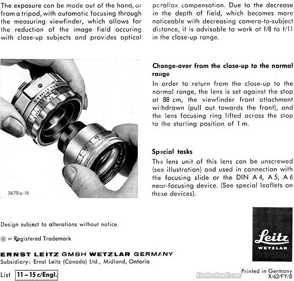

Still having trouble. Pics are out of focus.. I noticed on line that this lens appears to un-screw for near focus and normal use. I understand completely about matching ghost images to make match.
ruby.monkey
Sep 17, 2009
98
Orpington, L
The optical unit unscrews as illustrated for use on a bellows mount or Visoflex. It should be kept screwed tight on its normal focussing mount.
The instructions for switching focal range aren't related to that picture.
(Scared the crap out of me, the first time I accidentally unscrewed the front of my rigid Summicron)

It almost seems that if the subject is further away the worse the out of focus. It almost as if it's focusing backwards? Objects about 4 Ft are almost in focus. Weird.

well, you have to pieces of equipment there -- a lens and a body. Does the lens turn until it is set at infinity? If it is somehow set on the near-focus range, it won't do that. My one experience with the DR summicron was that it would only shift to near focus range if it had the auxiliary finder on it, but I an not an expert on that lens.
As i said before -- set the lens on infinity, take a picture at infinity and look through the viewfinder and see if it says the camera is focused at infinity. If the lens is set at infinity, but the rangefinder disagrees, it is the rangefinder that is wonky.
then you have the body -- if the lens focuses on infinity, your images at infinity should be sharp no matter what the rangefinder says.
what you need to do is find someone locally with another leica m2-3-4-6 that you can sit down with and compare, try some shots with his lens. And, as I said, if you want to use the camera seriously, and it hasn't been serviced in the last decade, you should have it gone through by youxin ye or someone equally skilled.
it would be worth it.

If you do not have the goggles, are you really sure that you have a Dual Range Summicron? If my memory serves me correctly the DR Sunnicron WITHOUT the goggles should have a "platform" for the goggles to mount on. If the lens does not have that, you could have a rigid mount Summicron, many of which were made with the ability to unscrew the lens from the focusing mount in order to use it with a Visoflex or a copy rig as has already been suggested. If the lens is not snug in its mount focus could be "off"......Regards
