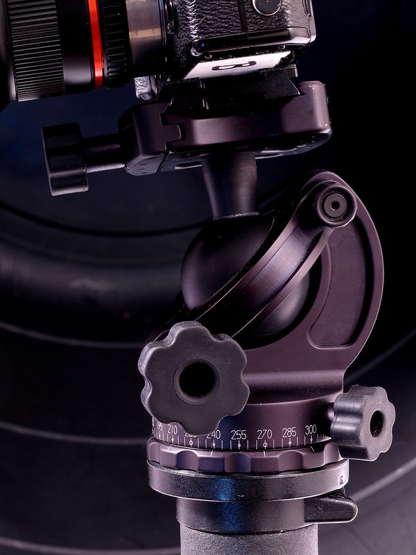

I have used loads a lot heavier than 5 pounds on my Acratech Ultimate Ballhead and had no problem with precision.
Ball Head by Narsuitus, on Flickr
