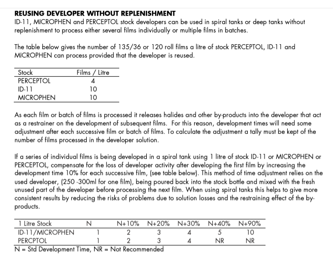

Hi folks,
I have a basic question here. I have developed 4 films in IDII and as instructed by Ilford I made the stock, decanted to a bottle and used the suggested amount in my developing tank and used the stock to develop each one. After each film I returned the used developer to the stock bottle. Next time I increased the development time. It seemed to me that Ilford suggest increasing by 10% each time you re-use this solution and so I increased film no 2 ( HP5 ) by 10% of the recommended time. So far so good, films 3 and 4 I increased their recommended development time by 20% and 30% respectively. I found that films 3 was overexposed and film 4 was even more overexposed and I have a horrible feeling I've misunderstood Ilford's recommendations. The last film should have had a development time of 9.30 mins and I gave it 12.20.
Please could you explain to me what I should have done?
Thank you for your help.

I expect you are asking about this part of the datasheet:
Yes, you seem to have interpreted it right.
If your first film has a development time of 10 minutes.
2nd = 11 minutes (+10%)
3rd = 12 minutes (+20%)
4th = 13 minutes (+30%)
etc.
HOWEVER:
The scenario you describe means that you really can't come to any particular conclusion about your results so far.
You may very well be seeing issues with erratic exposure, not development.
etc.
HOWEVER:

and the recomendation does say to use ONE liter of developer, and pour the used developer back and mix before the second. if you are say using 5 liters size of developer, and pouring back the used developer, the extra 4 liters will act to maintain the strenth of the total solution more than if you were just using the 1 liter mentioned in the Data sheet.
Jun 11, 2005
1,820
Plymouth. UK
You will get repeatable results simply diluting the developer 1+1 and discarding after one use only.
If you are looking for economy, look towards a long life concentrated developer like Ilfotec HC or HC110 and use them one-shot.
Reusable stock solutions without replenishment are too hit or miss to get consistent results.
