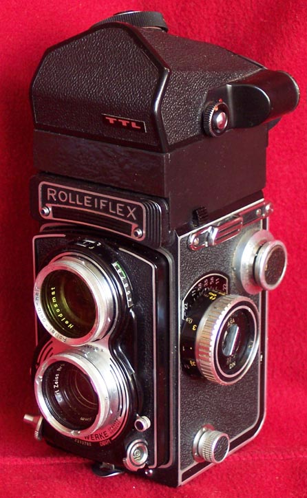

All Kiev88 viewfinders may mount onto a "Blad", but aRolleiBrujo has a Kiev60 metering prism and this one does not.
I did a self made adapter to mount a Kiev60 metering prism onto my Rolleiflex. The meter works OK, but you have to calibrate it showing the correct max stop of the viewfinder lens.
View attachment 92456 View attachment 92457
