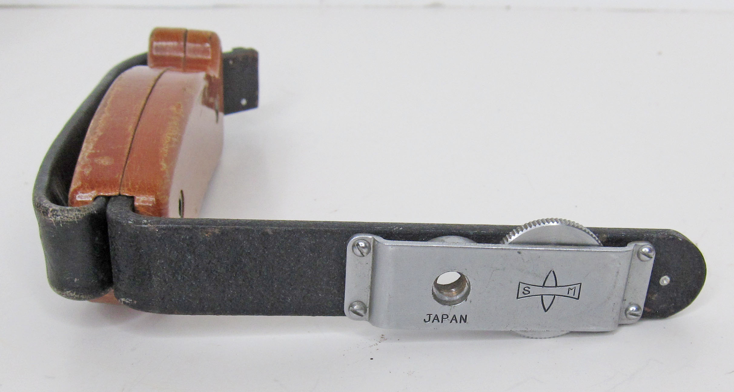

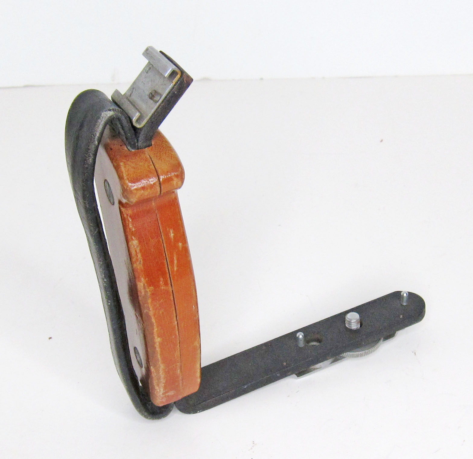

Found an interesting flash bracket. Has flash shoe at 45 degree angle and 2 stabilizing pins in base. Has a S M logo on base and made in Japan. Wooden handle. Any ideas on what camera it would fit? Thanks.
Those are Mamiya pins - Mamiya Sekor.
As Matt said. The logo with the lens shapes is an old Mamiya-Sekor logo, and the pins should fit several Mamiya medium format cameras, including the C series TLRs and the M645, and possibly others.

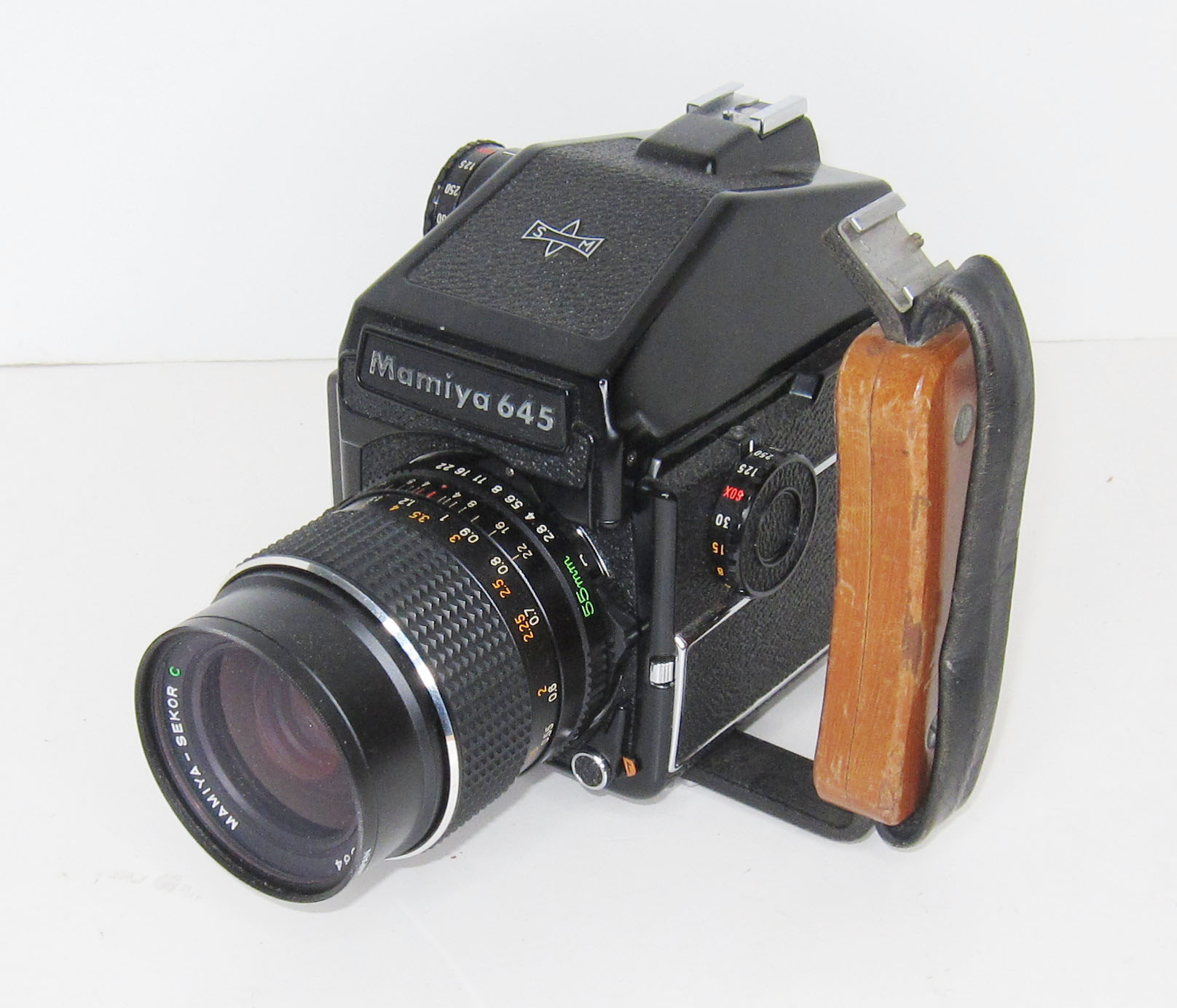

Great info thanks. I don't have a Mamiya TLR, but tried it on a 645 and fits. Bought this handle at yard sale for $1. I see the same logo on top the camera.
I got flash brackets where the shoe can be tilted front to rear, but this laterally inclinated shoe is new to me. At first sight I was puzzled by this, but I guess the idea was to have the handle close to the camera and still not have the flash interfere with viewing into a waist-level finder.
