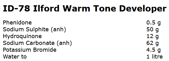

I'd like to try ID-78 after reading about it in @Ian Grant 's website http://www.lostlabours.co.uk/photography/formulae/developers/devID78.htm
I mixed it using my phenidone-glycol solution, but it didn't work: a daylight-exposed piece of paper couldn't reach anything more than a slight gray after more than 5 minutes in the developer.
