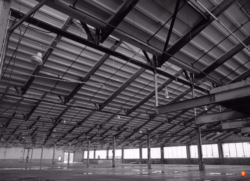

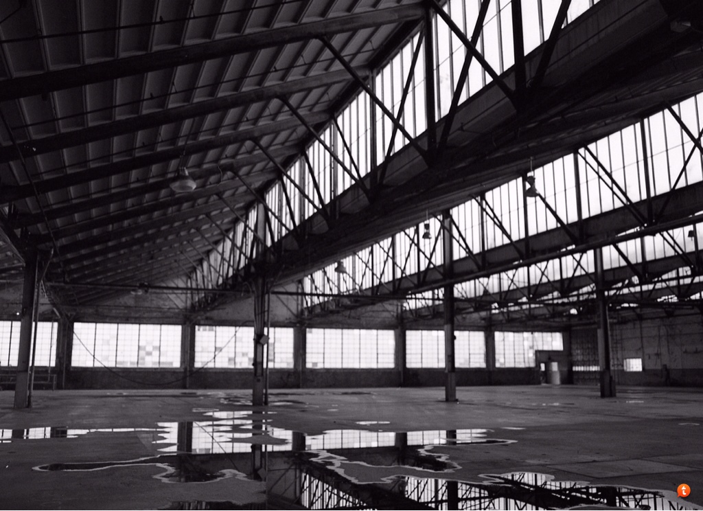

So here is an example of my ID11 joy. Bear in mind I was testing a new lens, so these aren't great shots.
cliveh
Oct 9, 2010
7,805
ID11 is good, but it doesn't have the je ne sais quoi of D76.
Black Dog
Jul 21, 2003
4,291
Running up that hill
Those don't look too shabby at all!
