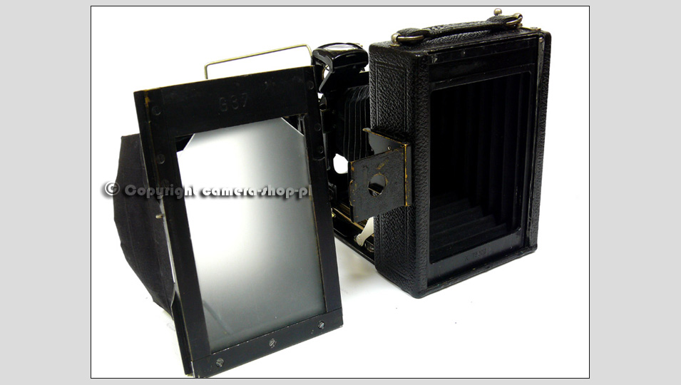

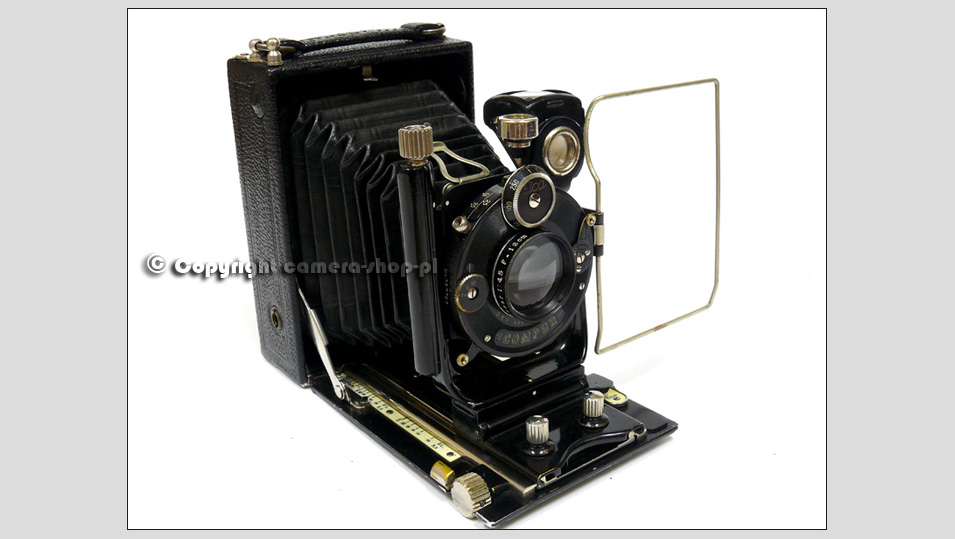

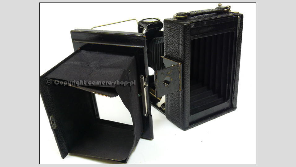

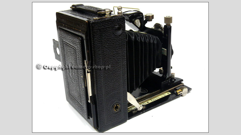

It's an ICA Ideal 'C' 9x12cm... now with pix!
Thanks for the info- I'll look through everything. I should mention that the seller specified it to be an ICA Ideal 'C', 9x12cm.....
It looks like a beauty- hope I can use it...
Anyone?

It's quite clear from the photos above that this ICA Ideal uses slide in holders, the focus screen pops open for focussing but has to be slid out :D. They aren't quite the same as the ones I have, seems to be a wider lip
The best place to find 9x12 holders is German ebay.de - it's where I've bought all mine the. Login etc is identical whatever front end as it's a common database. However items don't always map across to each version properly. Search 9x12 under Foto & Camcorder there's not many listed at the moment, they are best bought as sets of 3 in a small case. You will need patience waiting for the right ones.
Quarter plate holders would have been sold mainly in the UK, but both formats were sold and some sellers get the sizes wrong.

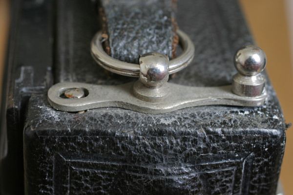

When you see the piece below on a corner of your camera, it's sure that it uses a pop off holder.
I have some like that in Hüttig, ICA and Zeiss Icon.
On the plate holder for ICA Ideal 9X12cm, it's written 726/6.

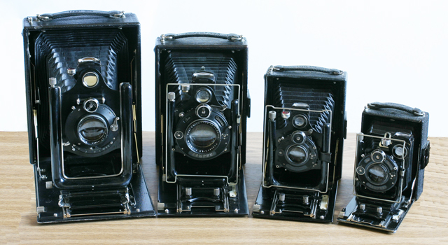

Here are some ICA Ideal models (6,5X9, 9X12, 10X15, 13X18; double plate holder only for 10X15 and 13X18) : they all have the lever and use pop off holders :

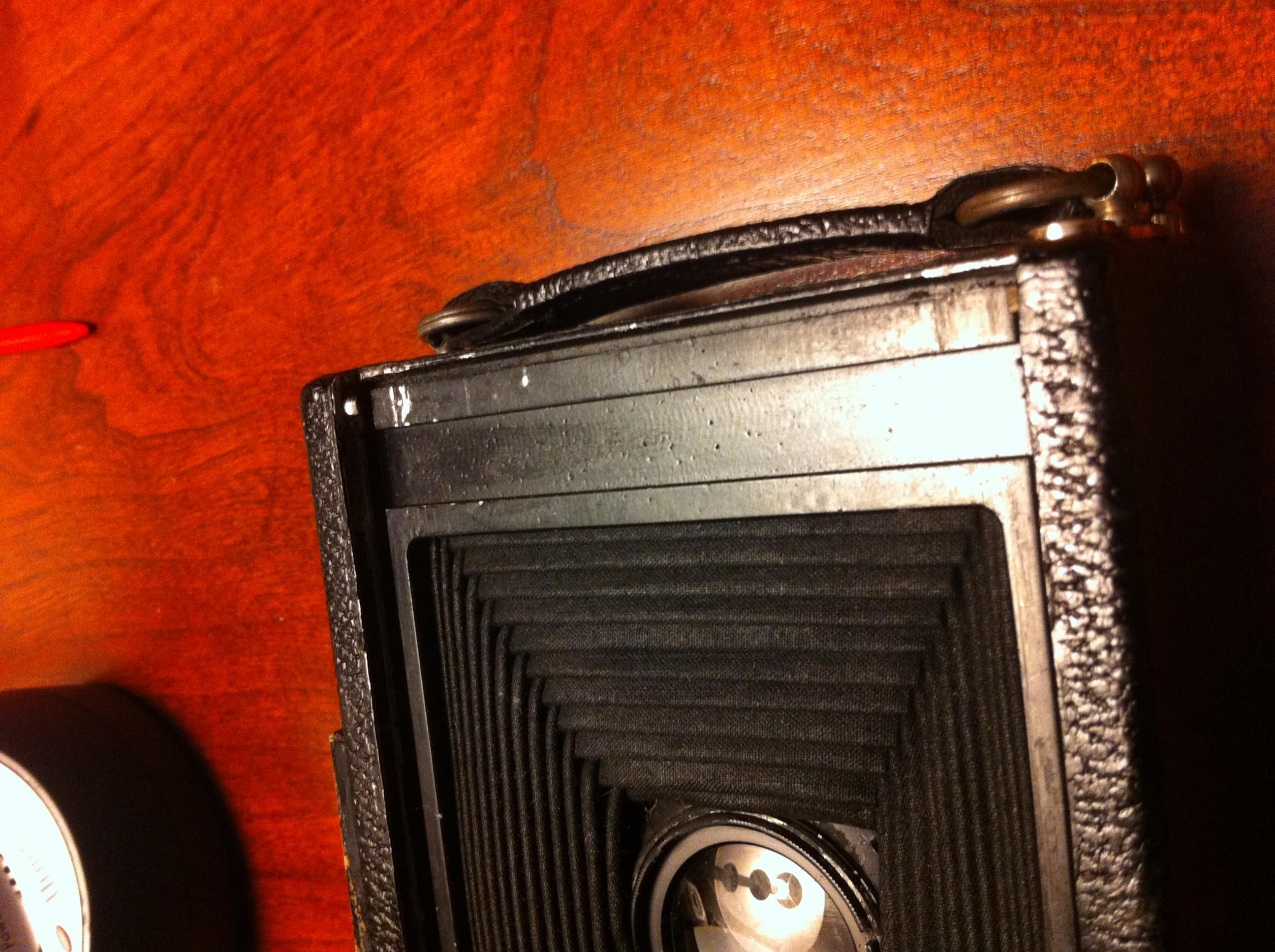

AND- some say slide in, and some say pop on.... back numerics "726/6" or "726/7"... Holy Crap! Here's additional pix just so I can MORE confused...

AND it takes "pop on" type film backs…! So I think I can make the Kodak film/plate holders work. They have two little tabs that the Ideal film back locks can grab- as long as I'm careful. Now here's a question: does my camera need more light seals? I took this photo using a Kodak holder with a paper neg(inverted in Photoshop) see the leaks! And heres a shot of the back of the camera- notice how there seems to be a place where a light seal might go? That small trench?
Anyone have an idea? Love the camera, but without pop-on film holders, this will be a challenge....:blink:
