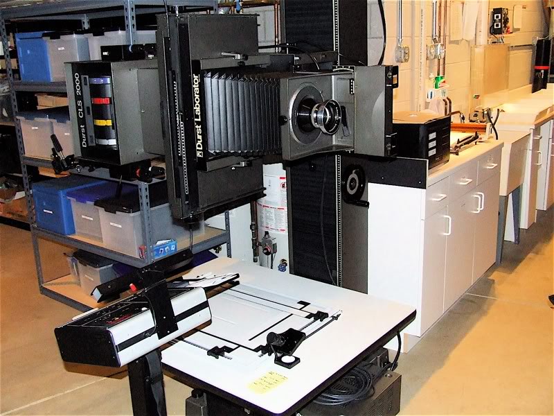

I scoured every piece of information available before I bought a color head for my enlarger. I needed to make sure it would fit. Especially since the only way I could lift it up to assemble it was with the enlarger head on its side. Even worse I had to have my wife help hold it up while I tried to fasten the 4 bolts.
Fortunately for me (in many ways) the head fit.

That's quite an amazing setup
