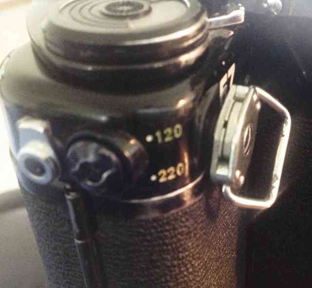

Ok, I downloaded a manual for the Pentax 67, but it does not show the silver doo-hickey on the left. The hoojie on the right controls the frame counter for 120 or 220 load, but I have no idea what the other one does. There does appear to be a pin that keeps it in the current position, which must be pressed to move it.
However I am not a fan of pressing an unknown button on a camera I do not want to break. Can any buddy help me on this?

Only part of the model 67 cameras got this button....

Factory-fitted multi-exposure lever. RARE.
It's on mine. In the camera's hey day, owners could return the 67 to a Pentax service centre and this multi-exposure facility would be fitted. Many cameras came with it as an additional feature, often sought after even now for 'layered' imaging interpretations.
Push in pin, turn lever left until M appears. Fire. No wind on until pin is disengaged.

Thank you all for the info.
I don't believe I have ever done a multiple exposure image. Guess I should try one some day.
