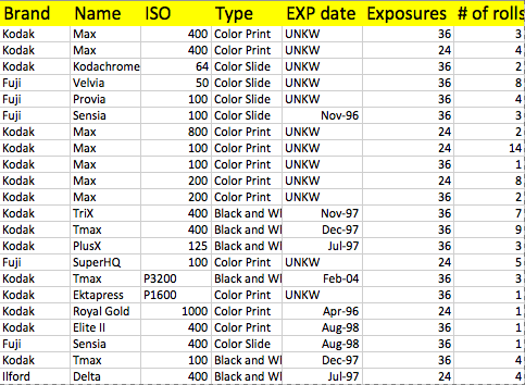

A family friend just gave me his stash of film, as he's switched to digital. All of it is expired, but has been in freezer storage for its whole life.
I have read that I should try cross-processing the expired slide film. Is this a waste?
Are there any general tips for shooting expired film? I would assume that it is now probably slower than its box rating, is this something I should try to compensate for?
Here's a hastily constructed spreadsheet of what I've got. I was typing as I went through the box, so it isn't well organized.

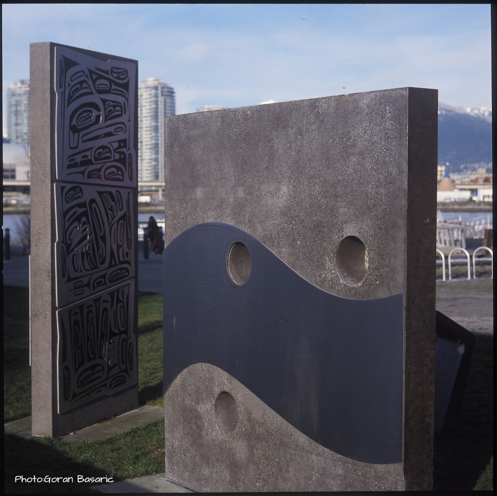

35mm Pan
Yesterday I did quick and dirty test of Agfachrome 100RS expired in 1991 and ever since kept in deep freezer. After processing it come almost perfect. Yes, Dmax is slightly lower, but not much, colour balance is almost bang on. Are these miracle results for colour slide film that expired 21 years ago?
Now I'm sorry that I didn't include Kodak grey scale and colour chart in the few frames. It was exposed at box speed. Scans are just resized and sharpened.
