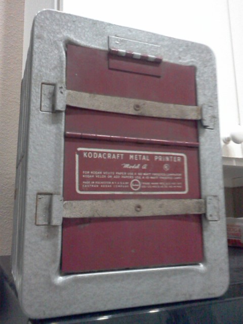

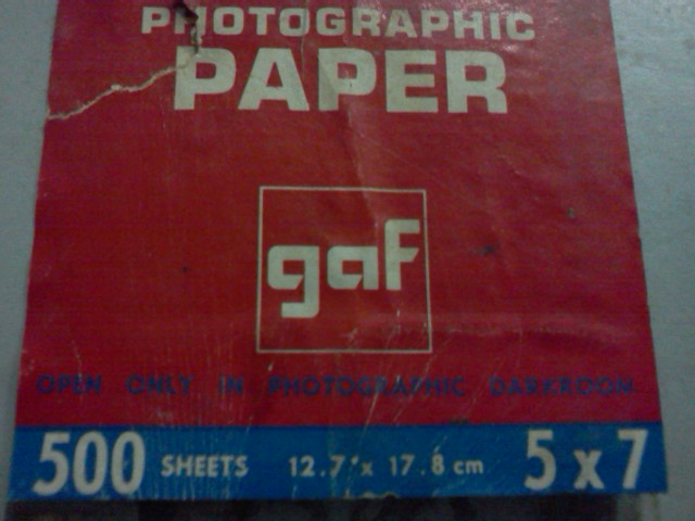

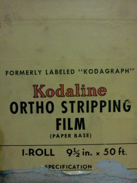

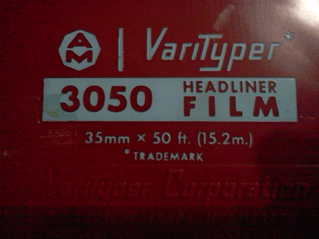

Here are some pictures of some of the things. What are these? Is any of it possibly usable still? Is there anything cool I can do with any of it?
Can't see the label on the GAF (ansco) paper.
The Varityper film is for an old Phototype setter. PMT was some kind of Pre-press proofing system, and the Othor Stripping film was to making up pages from multiple sources, (the emulsion could be transferred to another base hence the "stripping" name.
The Kodakraft printer is for making contact prints. Open the top, lay a negative on the glass with emulsion side up, then a sheet of paper with emulsion side down facing the neg, close the dood and switch it on for a few seconds then develope the print.
It doesn't give any technical information. It just says to open in a photographic dark room and gives the dimensions and count of the paper inside. But I was hoping that GAF paper was some sort of constant. I won't get my hopes up too high though, the stuff is mostly likely all bad anyways. The contact printer sounds like it could be fun though.

GAF made all sorts of paper, with various Brand names. Contact, enlargeing, graphics... There would have been a label with a brand name and the emusion number, but like all paper the label is used to hold the box together so may have come off.

Or slit the label to open the package later in the dark room.

Thanks for the help everybody. The GAF paper is in a box with 500 sheets wrapped in black paper. But the box has been opened, and the only clue I have is that label I pictured, which was inside the box because it had fallen off. And as for the Dektol, it's the paper-like packaging. I've read the can stuff keeps pretty well, but I was just wondering. I could always pick some more up, but it would be nice to know I came across a stack of at least partially usable stuff.
Next step would be to try it and see if It will work I guess. Hopefuly you opened the box in the dark, or under a reasonable safe-light. Next time you are having a darkroom session, Try cutting off a strip of paper off a sheet from the middle of the stack and see if it develops too much fog. if it comes up then you can try a few test test steps to see if you can find a useable exposure.
If it is an "enlarging paper" you may be able to work around some fog. If it just turns black in teh developer someone has admired it in the light sometime in the last 40 years.
