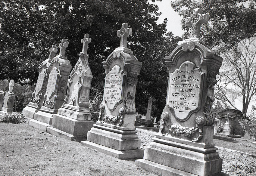

I have only used D76 up til now I have had good success but as I begin to build my knowledge base and read many of the threads posted here I can't help but be curious about other developers.
I am not a fan of grain. I like tack sharpness and as little grain as possible.
I love Acros 100 and PX125 film. I have just shot my first few rolls of Delta 400 and like the tanality but the grain was a bit more evident than I would like. I shoot 35mm and MF.
Having said all of that, is there a developer that would produce even better results than D76?
Attached is an example of a shot taken last weekend with a Nikon FE and Nikkor 28mm f/2.8 lens. Delta 400 @400/ D76 1:1.

As a beginner, I think that you would be well advised to stick to D76 for a while longer and learn what it can do. You should not be getting a lot of visible grain, unless you are working in miniature format and blowing up the prints excessively. If grain is your biggest issue, stick to D76 at stock strength instead of diluted. After you are thoroughly versed in what D76 can do, you could consider trying Perceptol or Microdol-X—but you will pay a price in terms of film speed. For most purposes D76 and Xtol will give you the best combination of reasonably fine grain and good film speed.
Don't neglect your chem and wash temps. Shocking the film even a relatively small amount can cause larger (not more) grain. Excessive differences in pH should be avoided also.

I'd only add that you'd do well to try the TMax developer, if a lack of grain is your big goal. I found it hard to find the grain when I was enlarging some TMX negs (35mm).
I would recommend giving Xtol a try. It seems to be a updated version of D-76 and offers more speed, which is generally welcome. You're not gonna see a huge difference in developers unless you jump to something like Rodinal or Pyro.
I started off like you on D76's equivalent of ID11 but then tried DDX and found it a much better developer. Less grain, great for fast films like D3200. While you may get better results from D76 by using it for longer I doubt if the grain issue will improve if that is one of your issues so I'd swop to something else. If you stick to manufacturer's times then that at least will tell you enough for you to know if another developer is preferable for you then you can take time to get to know that developer.
For extra fine grain try Perceptol. Surprisingly for a developer which is said to lose you a stop in speed it works very well with D3200 at EI 1600 and with some films it seems to get you "box speed" such as Fuji Neopan 400.

Since you are interested in minimizing grain, you need to stop listening the the dull drone of the D-76 lovers and look at:
http://www.kodak.com/global/en/professional/products/chemistry/filmBWmain.jhtml?pq-path=14024
Then choose "Choosing a Film Developer"
The shadow detail developer for T-MAX is obviously T-MAX, but the grain is the worst of the products.
The finest grain developer for traditional films [read: Tri-X and Plus-X] is XTOL and NOT D-76. You could spend all your life studying the results of using D-76 and you will not get the fine grain of XTOL. Microday-X has finer grain at the expend of shadow detail and sharpness.

To be sure, D76 is a great all-around developer. Sort of in the middle of everything in terms of grain, resolution etc etc. To have fun, I would try something that tends towards some extreme. For example, you can go as sharp as you can (at the expense of fine grain) by using Rodinal. You may love the increased sharpness so much you can put up with the grain, or you may find you like added sharpness but not to the extent where the grain becomes that apparent. In which case, you know you should find something sharper / less fine grained than D76, but not quite to the same extreme as Rodinal!
D76 1+2 or 1+3. :smile:
