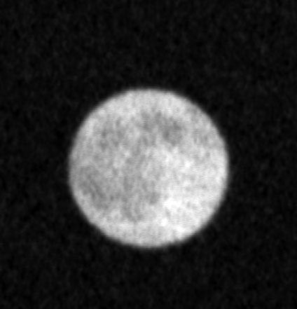

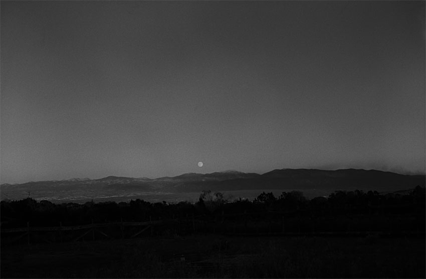

Here is a Moon picture taken on 2-1/4 x 3-1/4 with a baby Speedgraphic, and the Moon image enlarged by scanning at 4000 dpi with the Nikon 9000ED. You cannot expect to get much better if you enlarge your tiny 35mm image. As mentioned above, if you want to photograph and enlarge a Moon image, use a telescope. Moon is 1/2 degree diameter more or less and although it can appear large at moonrise, it is actually no larger when near to the horizon.
