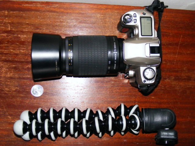

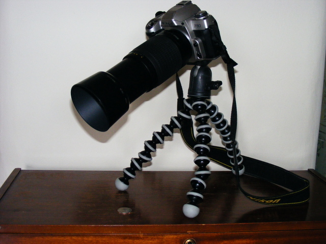

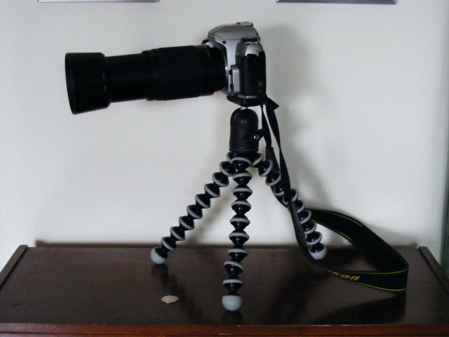

If I'm 'out and about' shooting, and not going to do anything preplanned, I take my Gorillapod SLR Zoom with a ballhead attached. It holds my F80 and 70-300mm zoom no problem. It can be wrapped around lampposts, over fences etc. and as you can see, when folded will easily fit in the bottom of a bag. It did not come with the ballhead, I added that. It can be used without any head fitted, so would be even smaller for carrying. For scale thats a US quarter on the cabinet (I got stiffed for 10p in my change somewhere last week!).
