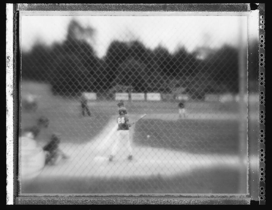

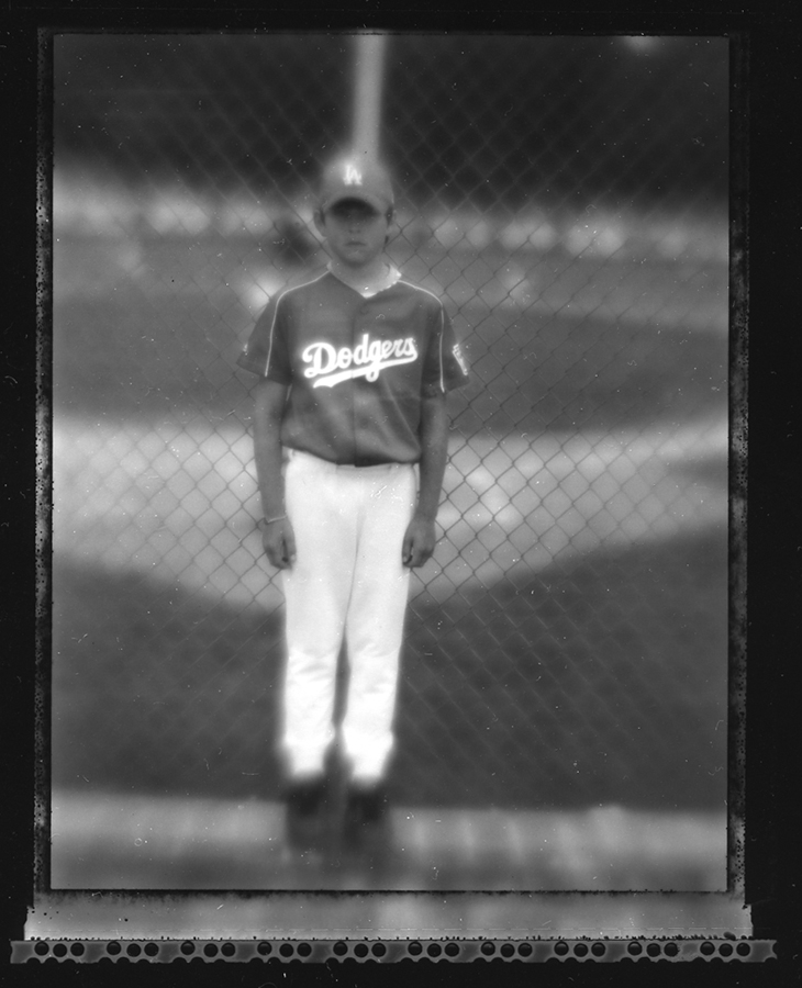

I still have my stash of 8 or so boxes of Type 55 in the fridge...all way out of date, of course. One-of-a-kind stuff for me...no replacement. Why do something like the below in 8x10 (my usual format)?
