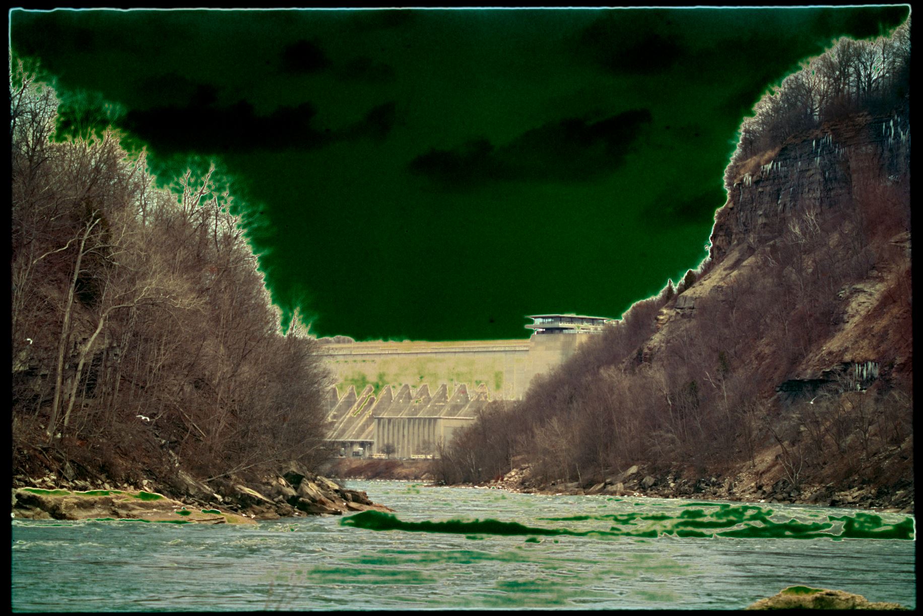

I shot it with mirror lockup on a tripod with a +/- 1 stop bracket, so at ISO 8, 16, and 32. The shots at 32 came out the most detailed. But they're also positively wacky. What is going on here? See below. It appears that the darker areas successfully reversed, but the lighter ones stayed negative, and there is a strong edge effect between them.
Straight out of camera with no color or contrast changes (ISO 32):
With black point set and a little green added, the midtones look realistic:
But the sky and ice highlights turn green and appear to still be negative.
The bracketed shots at other ISOs have a different cutoff for when the edge effect starts. The one at ISO 16 has the dam a similar green as the sky, and the one at ISO 8 loses detail in the dam and sky completely (all green and no clouds visible).
The film base is brownish, not clear. Why such different results than with Phoenix? What should I do to improve it?

hmm, maybe too much overexposed with some solarization ?
as i wrote in the other thread i tried iso 100 at 8 min developping.

Thank you. It does seem like increasing the ISO would remedy this because it happens in the highlights and there is still plenty of detail in the midtones. Although I'm still not sure why it happened: too much or too little light exposure during the reversal? And why is the base not clear, I thought that was a feature of this film, how is my processing affecting that?

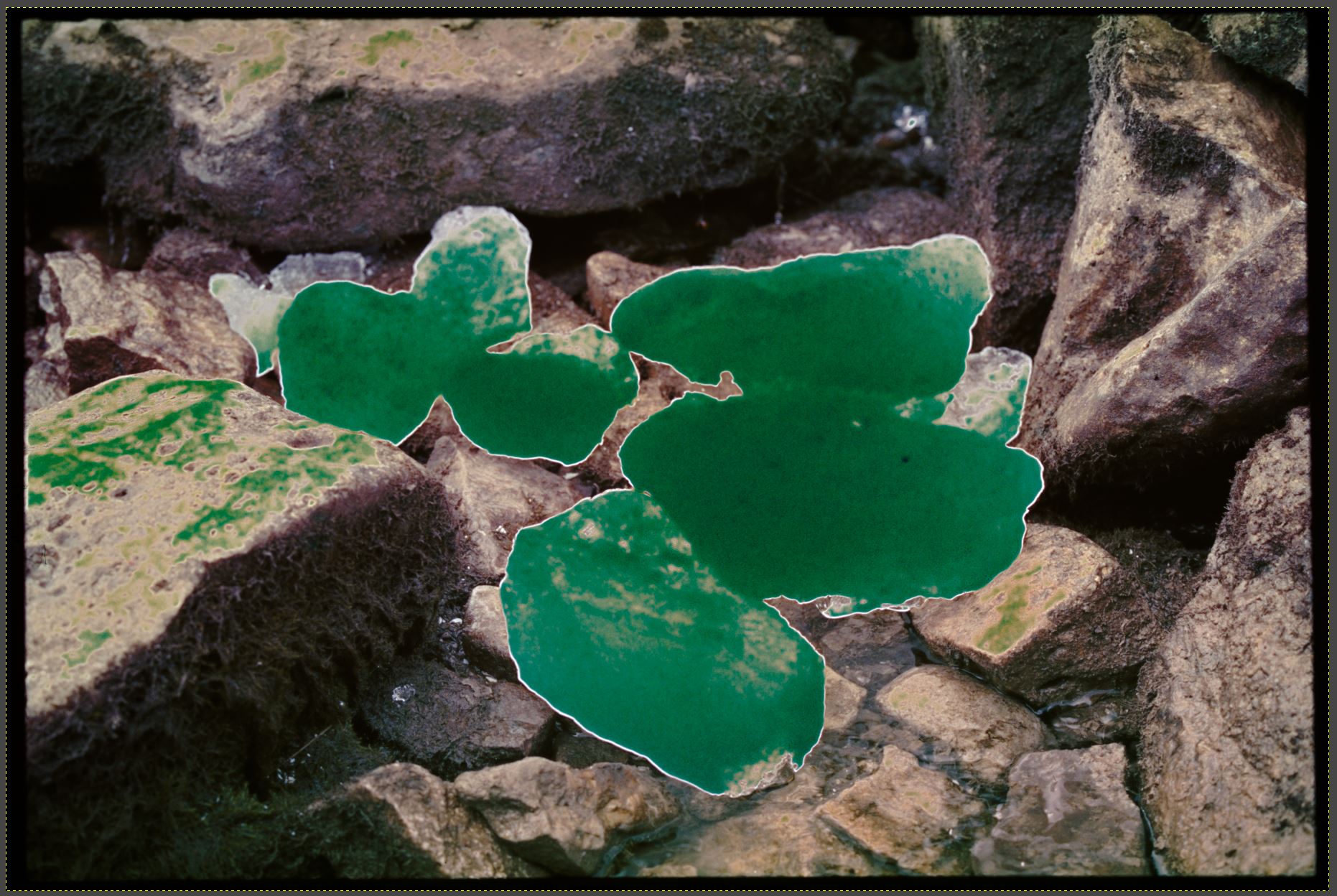

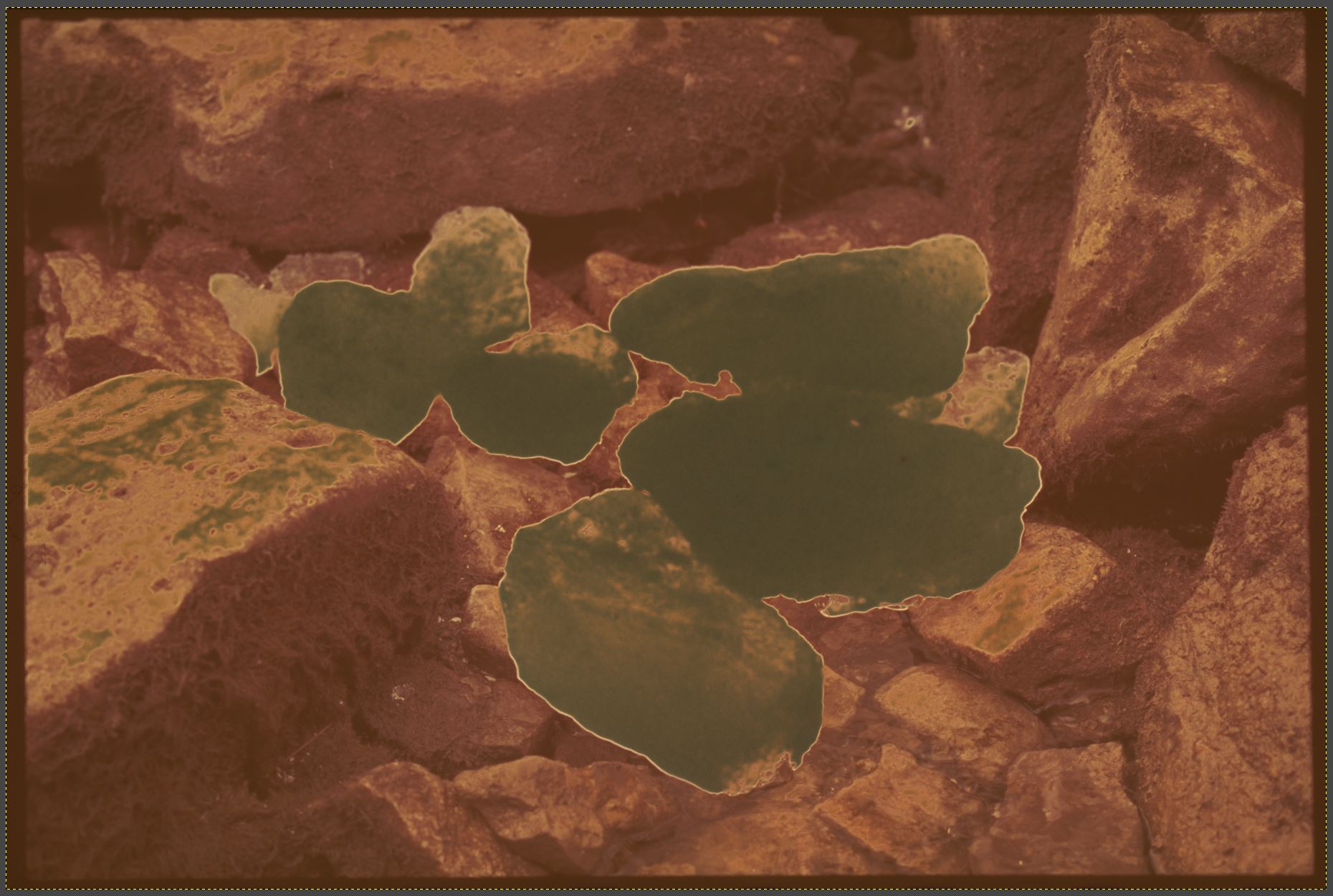

Here's another example.
iPhone image of scene for reference:
SOOC:
Curves adjusted:

I'd start by doing some test strips with only the first developer and some bracketing + different exposure times to see how much of the silver that's there you're getting at with the FD. Compare with a fully fogged and developed-to-completion strip so you know what the maximum silver density the film can produce. Then pick exposure & development that just hits (close to) dmax with the FD and work out the rest of the process.
For re-exposure I'd try chemical fogging if at all possible (e.g tin chloride) or alternatively use something other than fluorescent with its wonky spectrum. Even a modern white LED bulb will arguably be better.

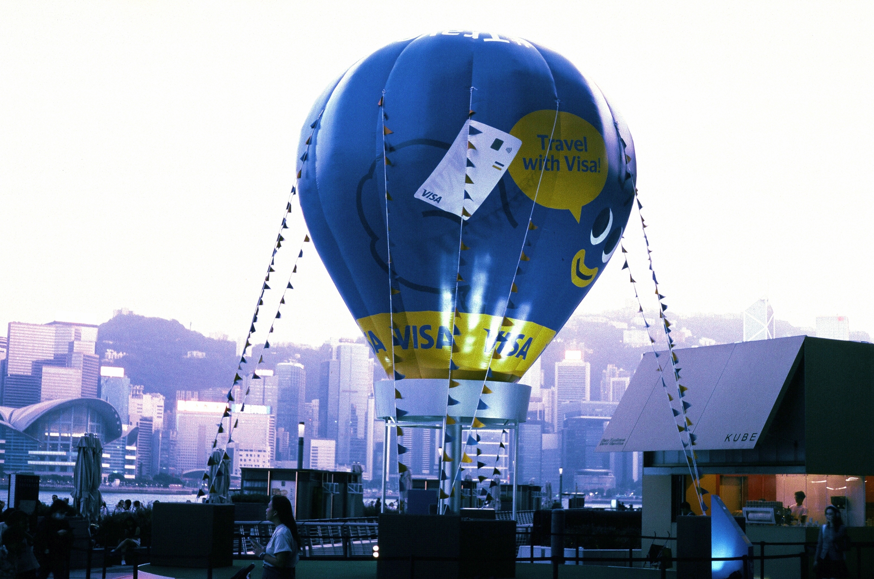

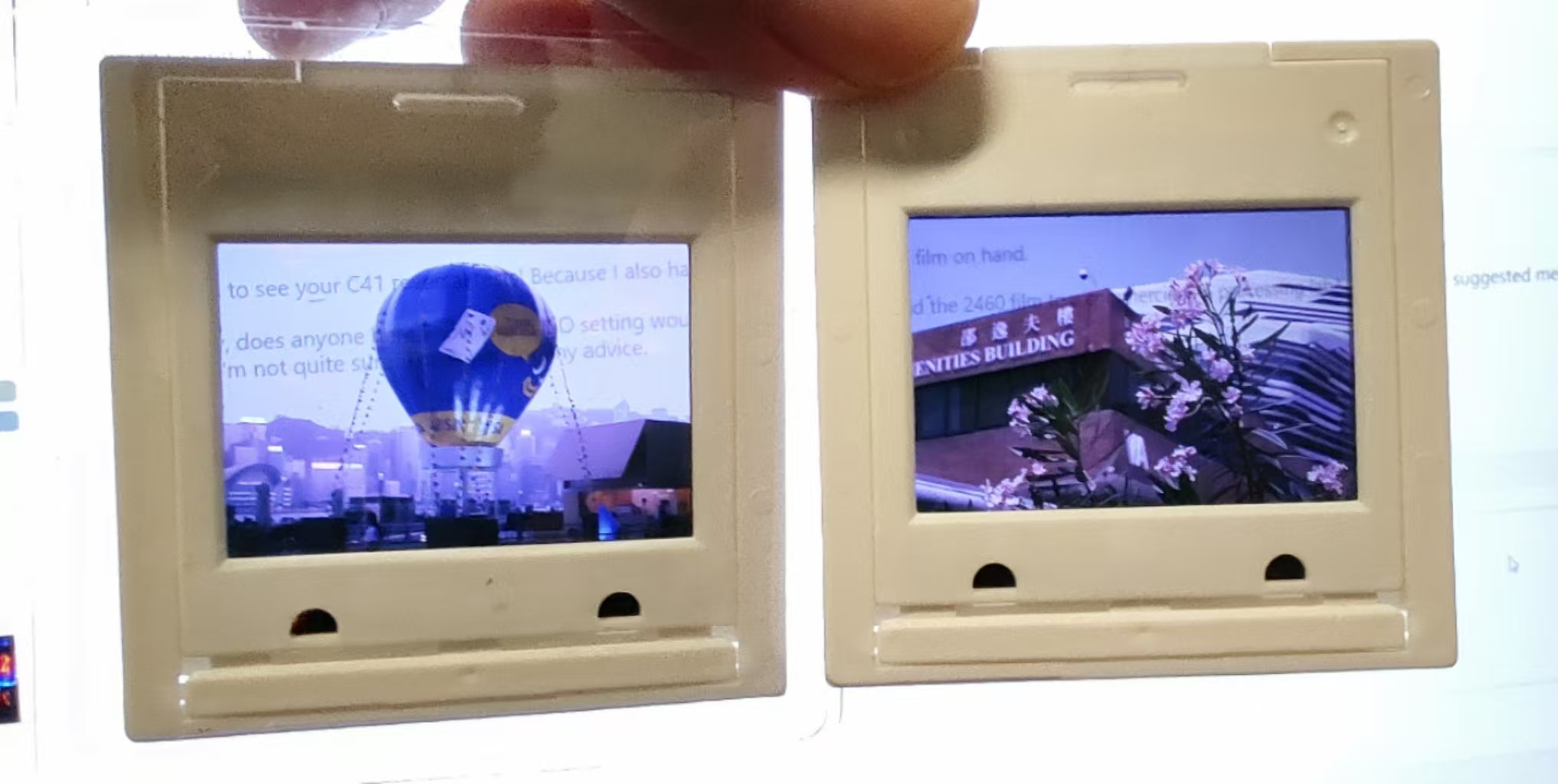

I'm excited to see your C41 reversal tests! Because I also have some Aerocolor 2460 film on hand.
By the way, does anyone here know which ISO setting would be best if I plan to send the 2460 film to a commercial E-6 processing lab? Some people suggested me about using 160 ISO or 100 ISO with an 85A filter, but I'm not quite sure. Thank you for any advice.
Yezishu
Dec 21, 2024
123
Hong Kong
Recently, I shot a roll of Aerocolor 2460 using with 85C filter, TTL metering at ISO 100, and had it processed at a standard E6 lab. The results were not too bad; the film base has a slight pink, and the images exhibit a subtle blue-purple cast, but the slides are still pleasing to my eye. I believe this can somehow serve as a reference for the novel C41 reversal process, with only some color shifts between them.
