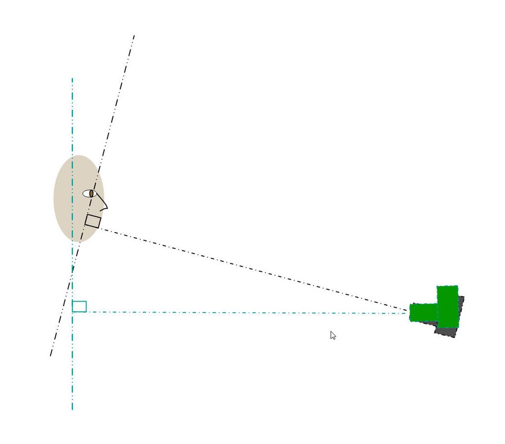

you are suffering the 'focus recompose' focus shift. If you shoot with 50mm lens at 5' from subject, to frame a 3.5' x 2.3' area (portrait orientation) and you focus on the eyes and then shift the center of frame to place the head in the upper part of the frame, you are shifting the angle by about 15 degrees (the frame captures about 40 degrees in the long dimension). That causes a shift of the plane of focus, and an apparent focus shift of over 2", which cannot be adequately masked by the DOF of the lens even when it is shot at f/4. Get closer for an even tighter framing, and the DOF shrinks even more, and the angular shift is greater, making for even more apparent focus error.
This is a drawing of the induced error:

I know what you mean but I'm not. I wasn't focusing and recomposing. (and that was just one example) I had all my shots from close ups to long distance shots do the same.
