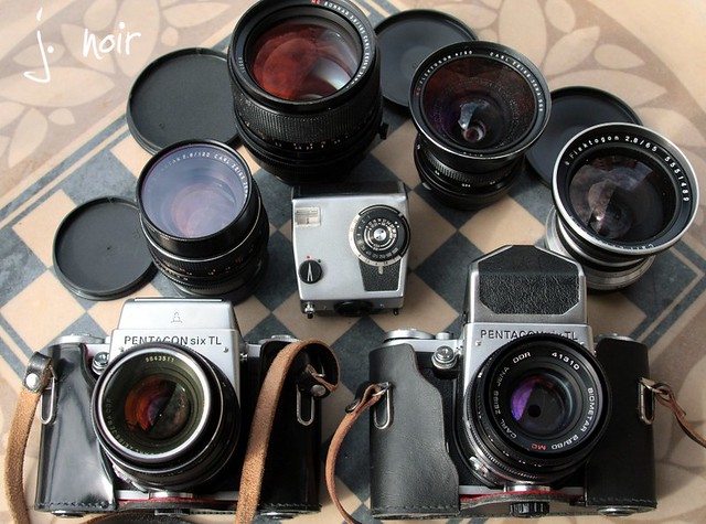

I love this system. I bought the two that I own from Gejza Dunay, a reputed seller and repairman.
I have nothing longer than the 180mm because it won't be useful for me, and I am parting with the second system just to raise funds for a CLA on my Linhof at München. Personally, I favor the 50 and the 120 over the other lenses, but that's just a matter of taste and needs I guess ;-)
