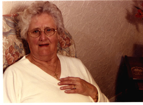

Having dabbled with colour printing over the last 12 months I have really been trying to get filtration right this last fortnight.
I have attached my latest effort because my mom looks human in it :smile: no green skin or purple clothes and the light is just about right. I have now got my Labometer set up so that I put the neg in , get the settings and print. It's actually quicker than photoshop and inkjet printing and more reliable.OK it's early days but it's just so much FUN !!!!
And I even have a local 1 hour lab that does a decent process only service with CD for proofs at only £3 . Who need digiboxes ?
Cheers CJB

You still need to take out some red. (Magenta + yellow). Add a bit more magenta and yellow filtration. I have never felt the need for a color analyzer. Note...just 2 units of change is visible in a print from a color negative.

I would add 5 Red based on what I see on my monitor.
PE
Yes, adding red filtration, takes out red from the print. (Just to clarify for the beginner). You get red on your average color head by dialing in magenta and yellow in equal amounts.

I'd ask your mum first Chris. She's the customer here. It might not be technically correct but a lot of people like warm prints. Might be an interesting experiment to try her with all three filtrations and see which one she prefers.
There's a tale about a very famous photog who said something along the lines of always erring on the side of warmth as he had never has a customer complain about prints being too warm but plenty who'd pick up on a genuine neutral and all of them picking up on even the smallest hint of anything with a "cold cast"
I have a ringaround in one of my books of a small girl and its always the blue, cyan, green cast that is easily identifiable and horrible. The yellow, red settings look nearly as good or as good as the "correct" print.
I'd be surprised if your mum prefers to be "pale and interesting" as the victorians used to say. Not many people do and women especially at the risk of sounding sexist.

I'd try adding the 5 red suggested, plus 1 or 2 of yellow as well. I think there is some yellow there hiding under the red.
I might lighten it as well - about 1/6 of a stop.

Matt;
The filter addition is equivalent to lightening it a bit. That is why I did not suggest it.

PE:
You are of course right, although it probably doesn't hurt to point out specifically that that is one of the results one of adding more filtration.
I have to remind myself of that result, because:
a) I haven't done much colour printing recently; and
b) A lot of the colour printing I did in the past was on equipment that automatically adjusted the exposure to keep density the same, when filtration was changed to adjust colour (leads to bad habits, I know).
