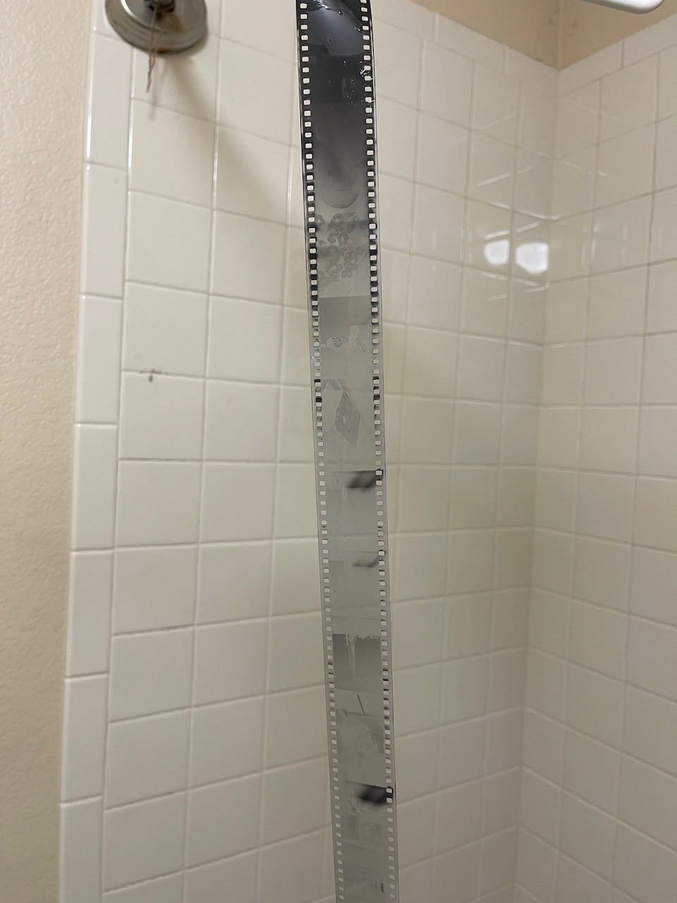

Well, to cap off a very bad day, I think I loaded Foto 200 into my camera instead of 42L… The negs are extremely underexposed. Some frames there is barely anything there. Dev is fine based on leader density, it’s fully black and evenly developed. Camera’s meter is good, I checked it against a known good meter. So the only thing I can think of to cause such bad underexposure is that I loaded the wrong film in the camera… and boy that sucks. Am I the only one that’s done this or is this just a me issue.
On an unrelated note, JFC that’s some bad light piping…

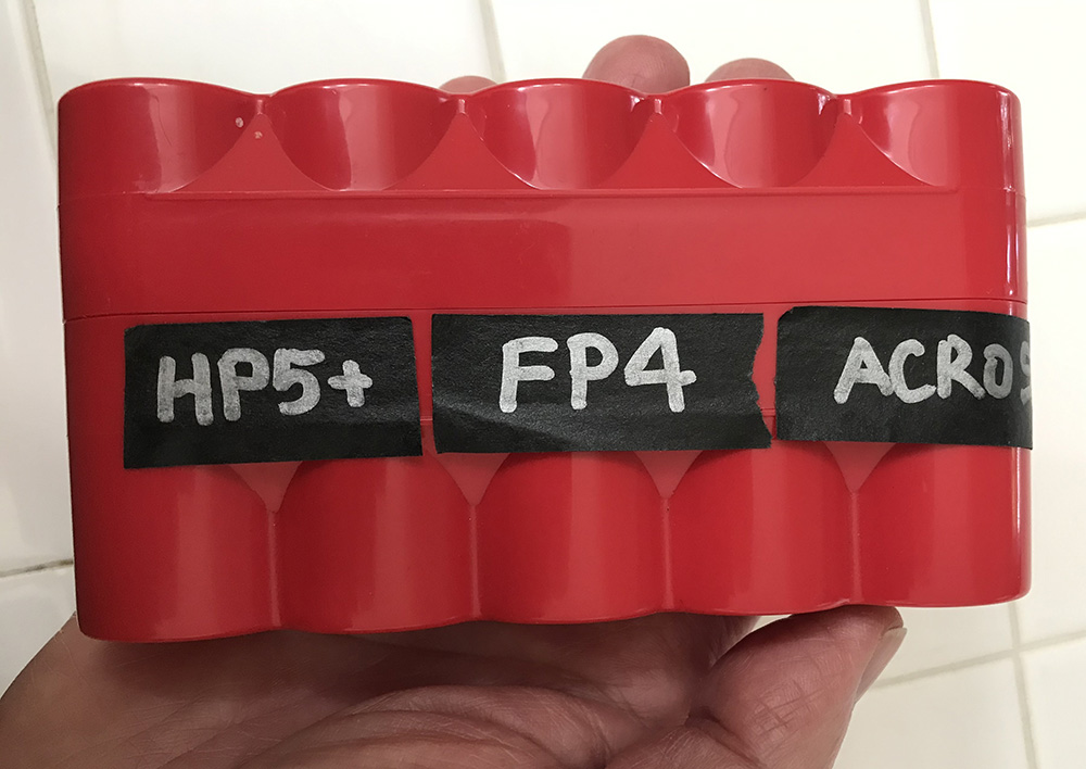

Whenever I buy Kodak 120 B&W film, I take a black felt pen and mark the ends of the outside foil with the code I use for that film.
TMX gets an "X", TMY gets a "Y".
When Plus X was still in my inventory, it got a "PX".
I rarely use Tri-X - I guess "3X" would be good.
When I bulk load 35mm, similar codes go on the masking tape on the plastic storage container - although I have some that have already been marked with a felt pen. I also put similarly marked masking tape on the cassette itself.
I always load 25 exposures in bulk loaded cassettes, and usually mark that on the cassette as well.
