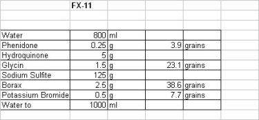

My Acculab 200 is a version that reads to 0.1g. My setup has both scales handy at hand to use and I've just gotten into the habit of using the powder scale on the smaller measures. My recipes are on spreadsheets and I simply have the conversions done and in front of me when I go to mix things. I've attached a typical recipe with a few small-weight components. I feel better with my equipment to measure for instance 23.1 grains of glycin than 1.5g on the inexpensive digital.
